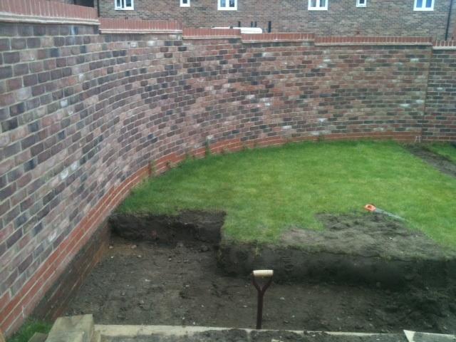

I'm digging the earth out so I can have a low level deck built.
As you can see quite a lot of soil has come out close to the garden wall, I want to keep removing soil right the way around to the expansion joint on the wall (shown on the picture).
I just got a tiny bit concerned abut the stability of the garden wall (with so much soil being removed), should I be concerned?
It's a new build and the wall is built very well.
Any help appreciated.
You've only gone down about 12", and considering that the wall is curved - which enhances stability - you will probably be OK (assuming it's a fairly sheltered location protected from high winds).
Thanks for your reply.
That's what I thought, and yes, It is well protected from high winds.
It would be good to get any other views also; good or bad.
are you making any provisions for water drainage or hoping to turn it into a pool one day? : )
There will be a fall from the deep end towards the far wall, that's the only drainage.
There shouldn't be much water as our house is only 3 metres behind where I took the picture from anyway.
