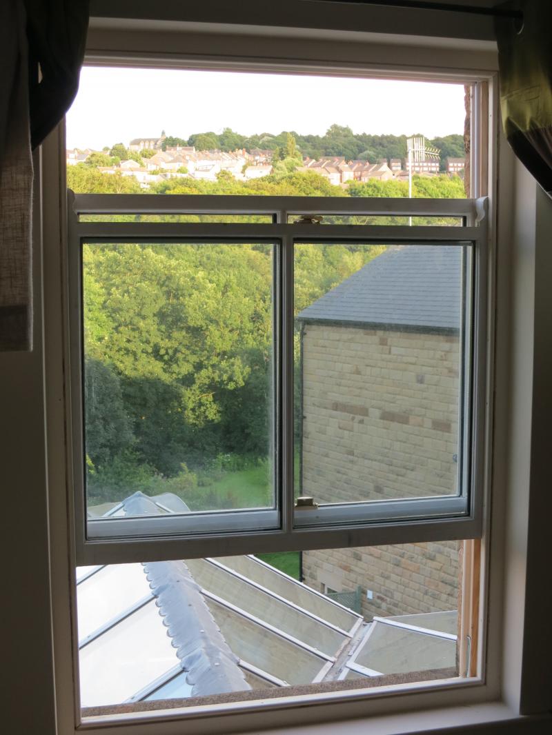

Hello everyone,
First post on here - what a fantastic resource
just wondered if anyone could advise me regarding some new sashes we've just had made.
When the carpenter fitted the balances, the screw that holds the balance into the rebate has split both horns on just about every window.
I told him I wasn't happy with the splits in the horns only to be told that I was "nitpicking". He has smoothed a bit of frame sealer over the cracks and says that's good enough........
opinions please?? thanks in advance.

Can you post a pic(s) of the whole w/frame opening?

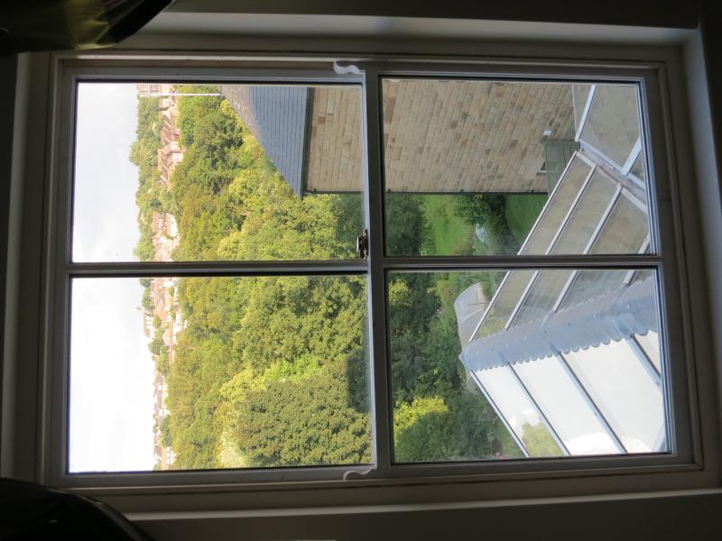

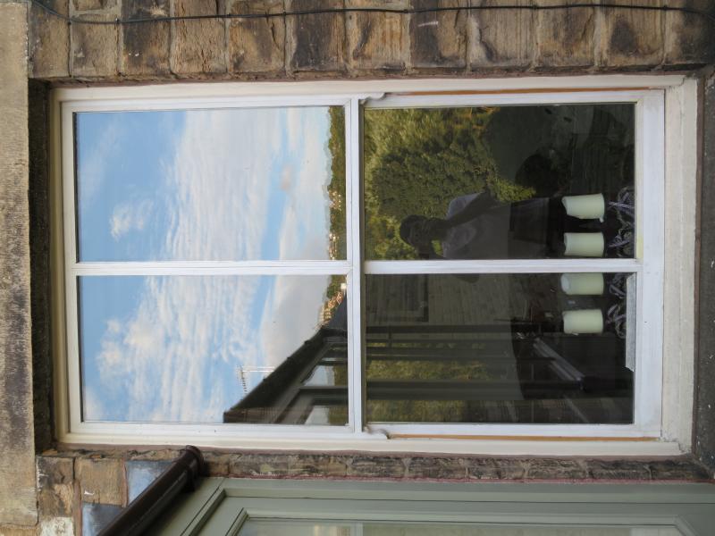

difficult to get a pic of outside because of conservatory below it but here are some inside pics and one of a downstairs window that has the same problem (its just the sashes that are new - the frames are original)
I can post photos of any specific bits you want to see....

Thanks for the pics.
Perhaps the spiral balance is the wrong length for the stiles, and the error is compounded by using the c/w screws in a too deep slot?
There seems to be two screw tips protruding.

The split has developed into a crack that has opened up the bottom rail to stile joint.
dann09: I think you might be looking at two screw holes that you can see just below the horn ( in the frame ). The joiner put a couple of screws in to hold the top sash up for a while - there were no balances in em for a few months between him making and installing them, and then coming back to fit the balances

Nope, the two screw tips i'm referring to are in the horn split itself. One screw may have opened the stile, but the second screw would have caused the split that we see.
Car body filler wont work - when the wood swells and shrinks the filler will fall out.
Replace the screws in the horn with smaller screws, and fill the split with a first class wood glue.
Then, drill pilot holes followed by screws from the hidden side of the horn that will pull the horn together.
No clamping needed.
In a perfect world all the split sashes should be replaced and finished to a better standard than shown in the pics, and the balances replaced, but that might not happen.
