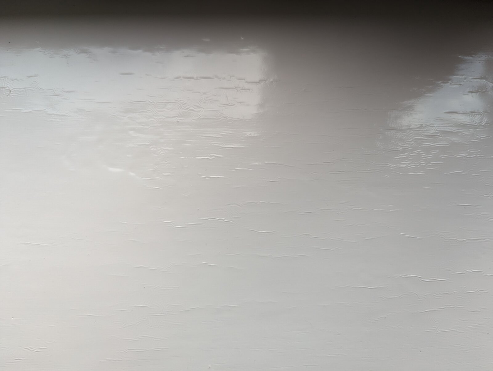

Hi.
I'm getting a weird finish on my shelf using Dulux Trade Satinwood. I think it's raised grain?
It's hardwood, previously varnished. Here's what I did:
Stripped varnish with carbide blade
Sanded 40, 80 then 120
One coat of Dulux undercoat and primer
Sanded 120
One coat of Satinwood
One coat of Satinwood 18 hours later
Noticed this issue, so gave it another coat 18 hours later
12 hours later I'm still seeing this. Any clues?
It's not raised grain, it's paint checking.
Did you apply thick coats?
Are you using all water-based paints?
What was the temperature and humidity while drying?
Are you sure the wood is not veneered?
Second coat applied too soon.
That's not waterbased paint.
Recoat time ( not drying time) is 16h? I think it needed longer.
Leave it a week and then 320g sand and another coat might sort.
It's oil based. Says on the tin 16-24 hours. Although it's an unheated room as the radiator isn't connected so maybe I should have left it longer?
Okay thank you.
First coat was thin, second and third fairly thick. It's oil based gloss but the primer was water based.
There's no radiator at the moment so maybe 12-14 degrees? Should I have left it longer?
As others have said, it looks like you applied the second coat too soon.
After it is hard enough to sand flat, you can add some oxidising agent to the paint to speed up curing times.
eg terebene
Modern oil paints are thicker and take longer to dry. Times quoted are average but you need to consider environment.
