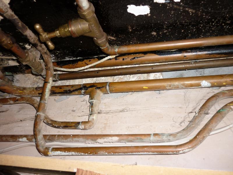

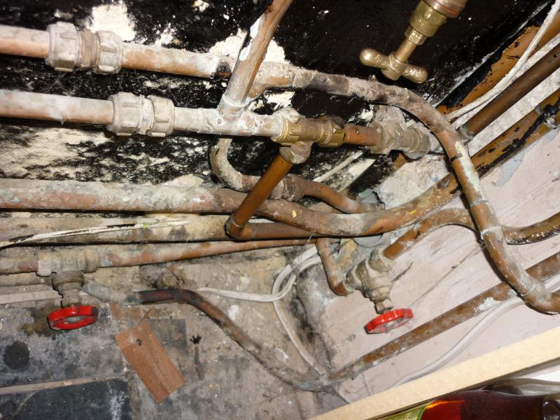

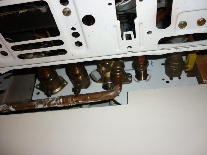

hi adlplumbing, thanks for the quick reply,
unfortunately this may be where i get beyond help :( ...as the after coming out of the boiler the pipes disappear in to the wall and then reappear below the kitchen counter. I have taken photos of the pipes directly at the bottom of the boiler and then again the pipes from below the worksurface (with the stoptap and two red taps i mentioned earlier)
hopefully this isnt too cryptic for you folks to be able to shed some light on! :D

open the other stop tap.looking at the pics think theres one hiding behind the pipes.basically it sounds as if your half way there, yet you need to open another tap to let the water into the ch side.bit like what is supposed to be there with back flow prevention.tut tut.
Thanks for the reply Holty, just to clarify, which tap do you think i should turn on? There are three taps, the stoptap(which has now been replaced with a new tap and a silver braided pipe) and the two round red taps.
The stoptap/new braided pipe is now open (that made the initial sound that stopped) and the other two taps are open, but dont seem to make any difference (they seem as though they might be isolation for the bathroom?!)

hmmm maybe its the way im looking at the pics but on the 2 and 3rd pic it looks like a stop tap hiding,but looking closely at least some sort of coupling blending in to look like the body of a stop tap. :confused: .anyway you need to trace a link between the cold mains and your CH pipe as this is the only means of topping up.the compression im looking at is unusually longer than a standard compression coupling. so im rather thinking you have a check valve or more than likely you have a service valve.which is evident with a slot on that can be turned by.........a screwdriver.or in case of panic a kitchen knife :LOL:
oh by the way im on about the compression on the 3rd pic, from the right of the compression T.were theres a soldered T, to the left of it.

Also, i have been checking in the manual and i think (hope) i might have found something that may be relevant (the attached manual snippet and the first attached photo in my above post)... It looks like the second pipe from the left coming out hte bottom of the boiler (B in the manual) has an isolator valve below it(P in the manual) - would that be something worth opening? Should it even be the cold water inlet pipe that im looking for?
