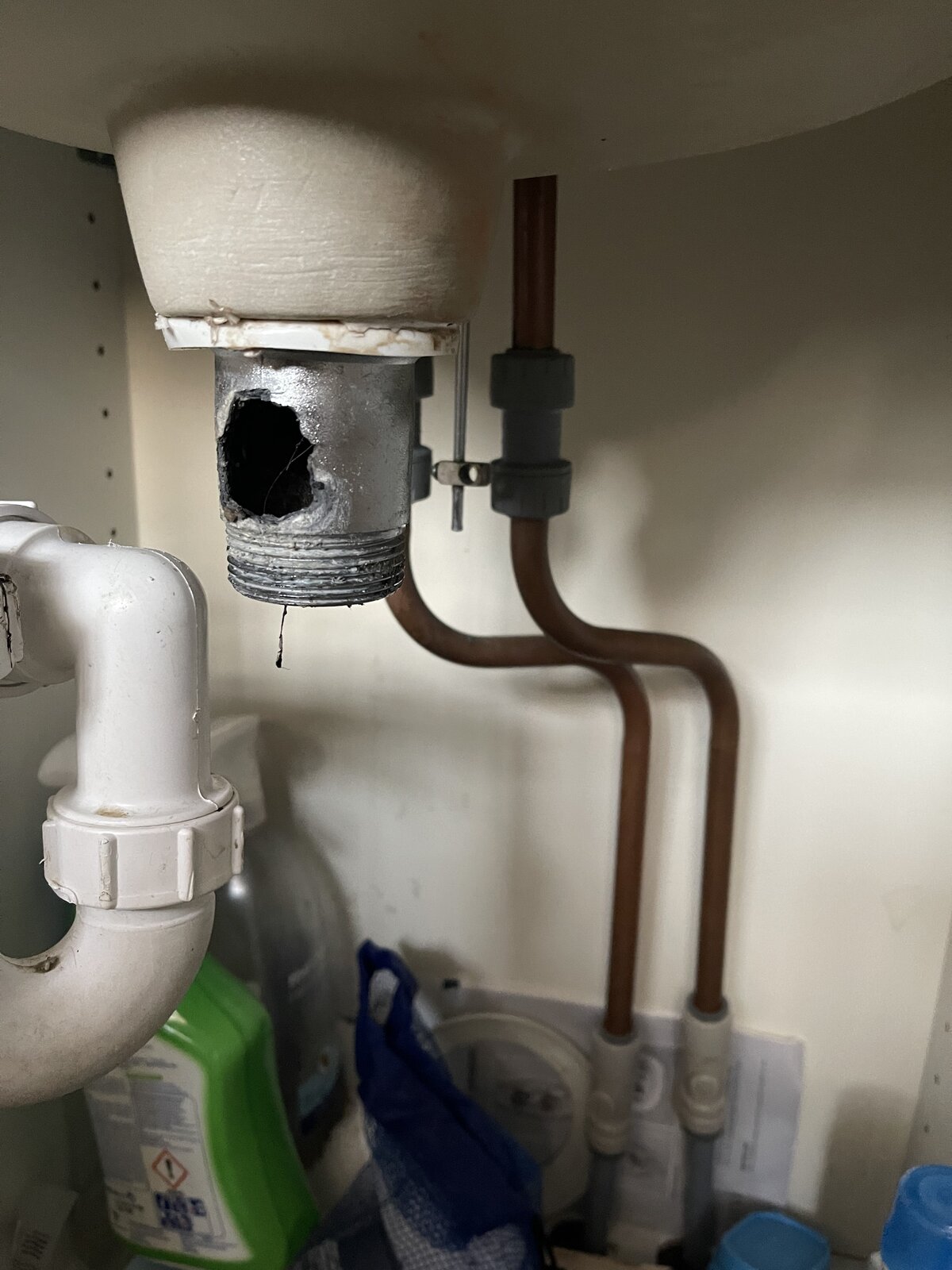

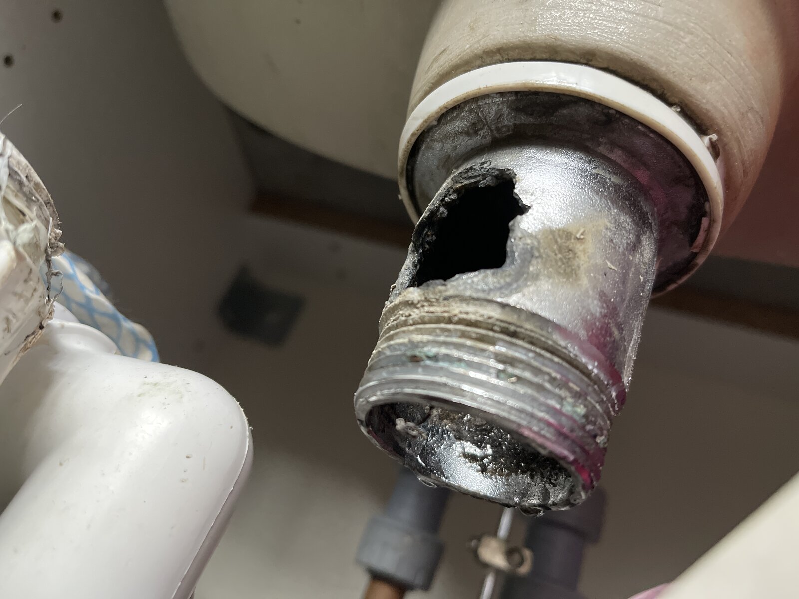

Hi all, I have a Savoy bathroom sink, we pushed the pop up plunger and felt something go, having looked at it the metal part on the down pipe from the plug has corroded and broken off. I have detached the connector and need ti replace the pop up part and down pipe, however unlike all the diagrams and clips on youtube replacing that part - where they simply unscrew it, there does not appear to be that facility, is it that there is a simple technique used or somewhat rediculously you have to replace the whole sink. The shot attached shows the pipe with hole in and also the plug downpipe, the white disk is a washer fixed with some sealant, the metal part appears to be wider than the ceramic bowl so I can’t simply push the pipe up.

It’ll unscrew, counter clockwise. It’ll have a 2 part threaded piece/waste.
Ok thanks, if I place a screwdriver into the hole of the bit which broke and twist it the whole plug and pipe revolves, is there a way to stop the basin plug turning?
I have seen in all the videos the unscrewing part is easy - there is usually simply an independent part which would be where the white plastic part is on the pic, for further clarification the shot shows the metal is all one part with a plastic washer

Nasty alloy waste. Had one rot on me like that.
That waste has been fitted with a basin mate or equivalent https://www.toolstation.com/basin-mate/p37534
When I tried fitting one with the new waste I found it too hard to get on by rotation - even with copious silicon grease... So I reverted to my tried and trusted plumbers mate and waste-supplied washers.
You may need to resort to cutting it off? Especially if the *plumber* has siliconed it all into place (as it looks like it is to me)?

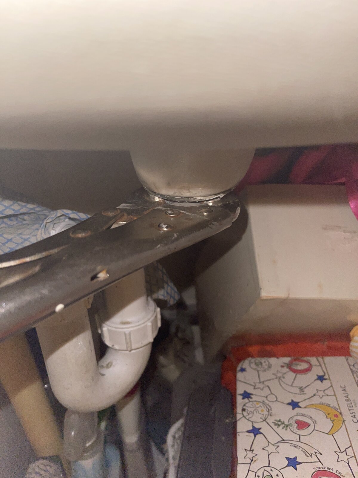

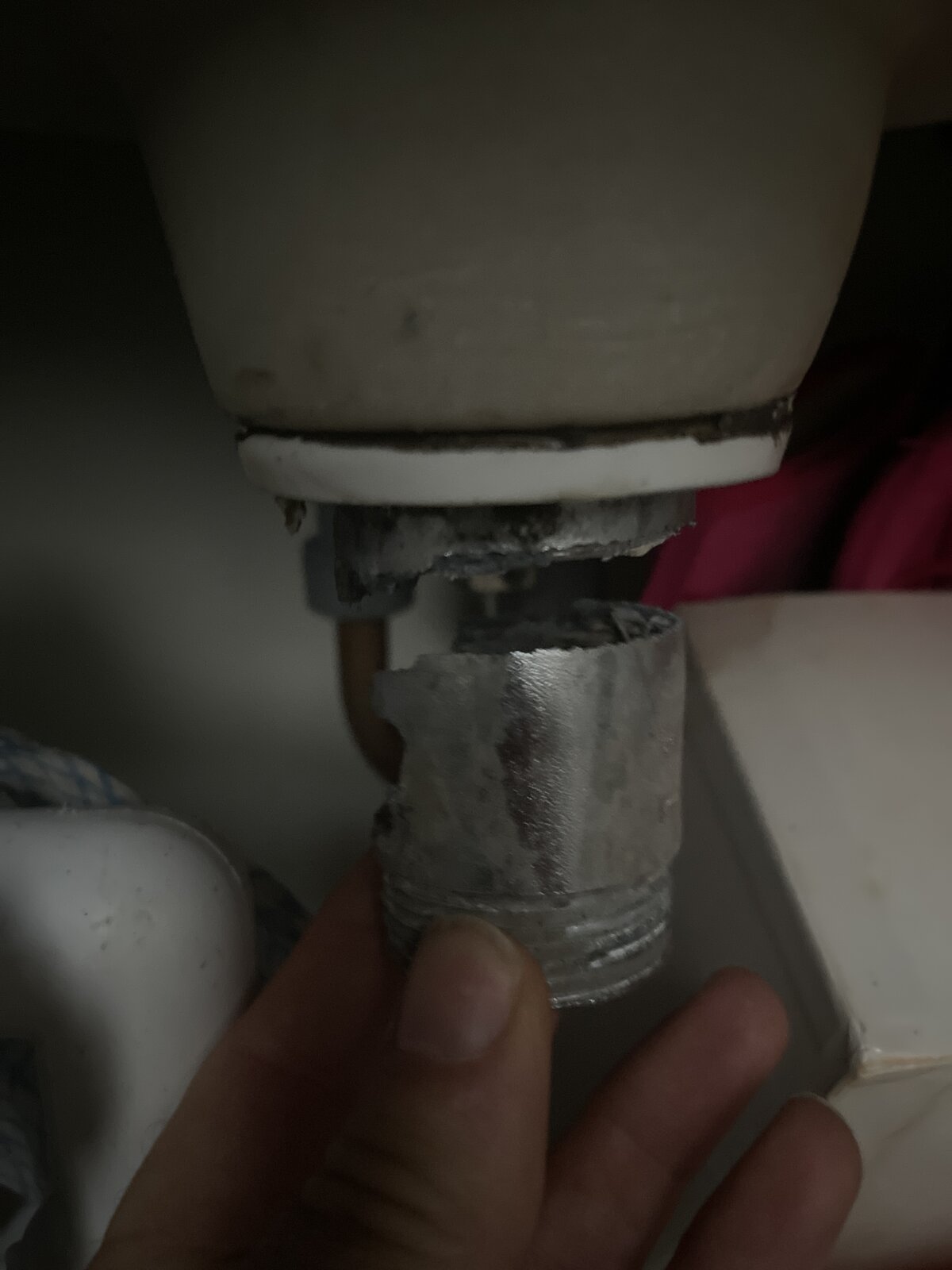

Ok so I tried the grip and pliers option and this happened….What should I go for now, hack saw the threaded bit off I guess?

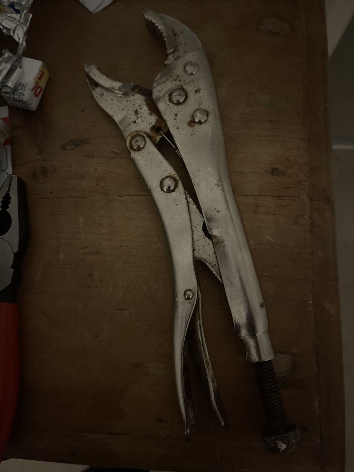

What grips do you have ?
Large pump pliers should grip the collar ( the metal bit covered by the white seal)Grip that and have a second person above with long nosed pliers preventing the top of the waste from turning, whilst below you turn clockwise.
One of these

I think I have tried everything, the hole in the plug that I have the pliers in is now bending I’m pushing so hard. I’ll take the hack saw to it, thanks for all your help everyone.
