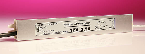

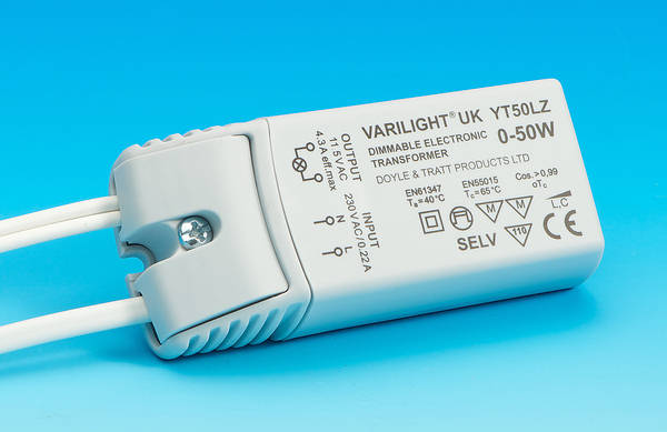

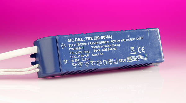

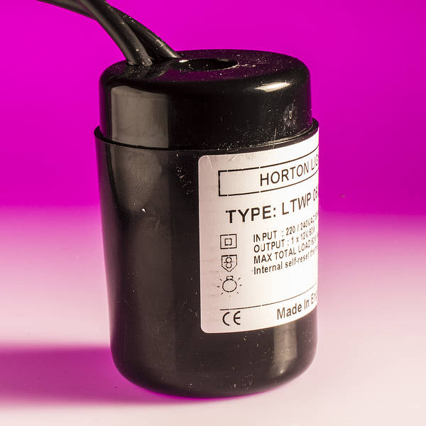

I renewed all my halogen many years ago, but it does depend on the transformer as to what can be fitted, the toroidal lighting transformer will work zero to rated output is normally round, and is 50 Hz, most G5.3 LED bulbs will work without a problem, the electronic transformer like this 1704566014743.jpeg will also work zero to rated value, but this one 1704566093237.jpeg which looks nearly the same will not work a LED bulb under 20 watt, it is marked 20 - 60 VA and as far as you need to know VA is the same as watts. And this 1704566309161.jpeg will also likely work the lights, but is DC. Some LED bulbs do stipulate DC, typical one for a boat is 10 - 30 volt DC, but the G5.3 or some times called MR16 although technically not as they don't have a multi faceted reflector even if 16 8ths of an inch across, are in the main designed for DC or AC and although some marked 50 Hz in the main they still work in the kHz range, so the electronic transformer in the first picture will likely fit through the hold for the lamp, even if the toroidal transformer 1704566768193.jpeg will likely last longer.
