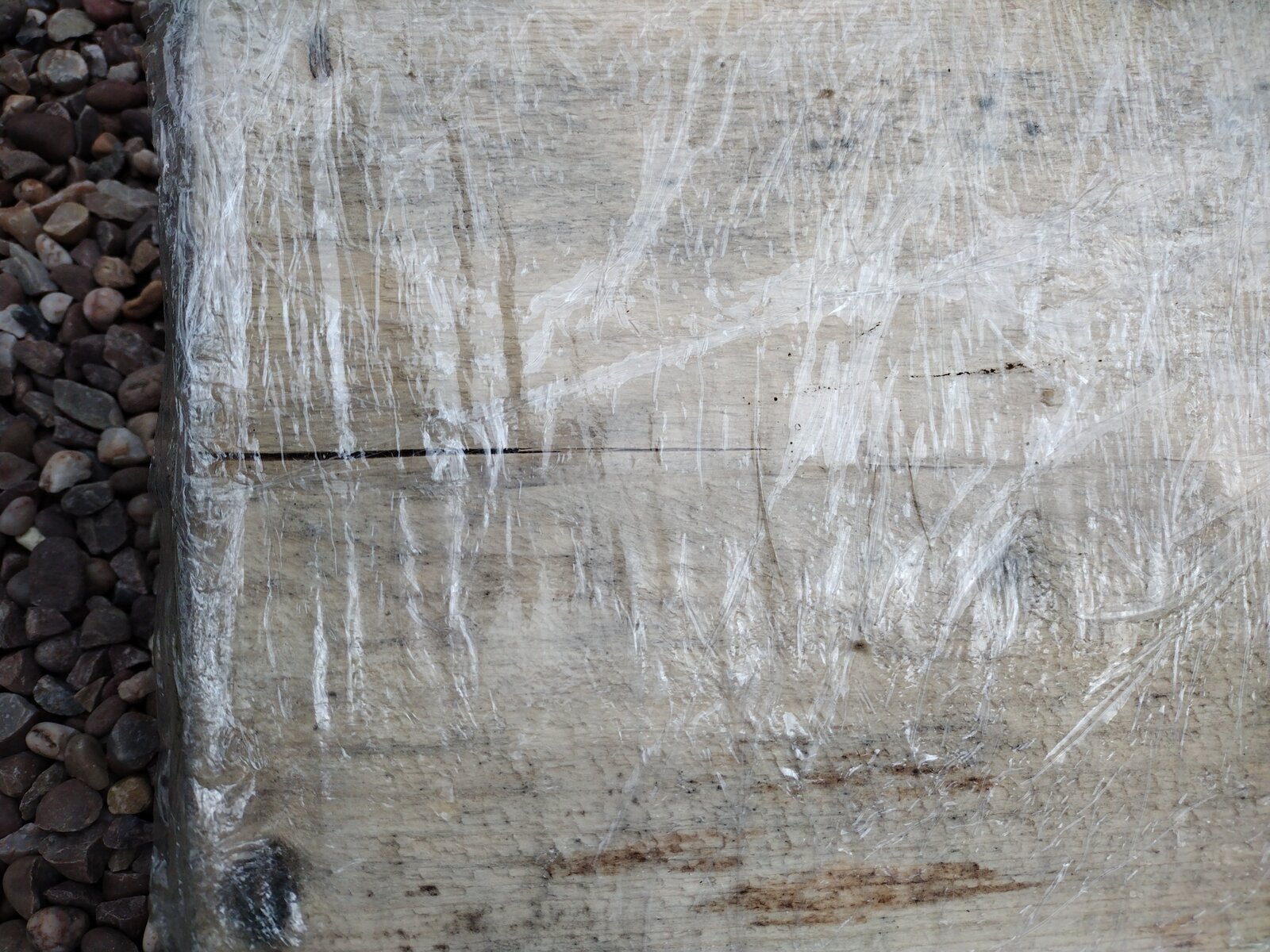

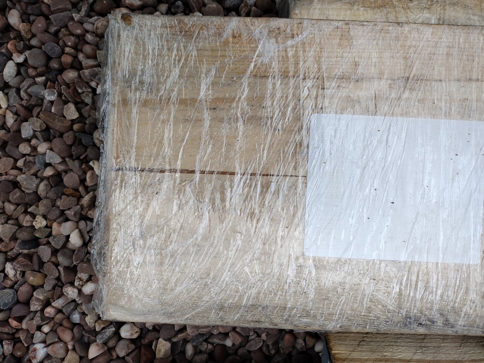

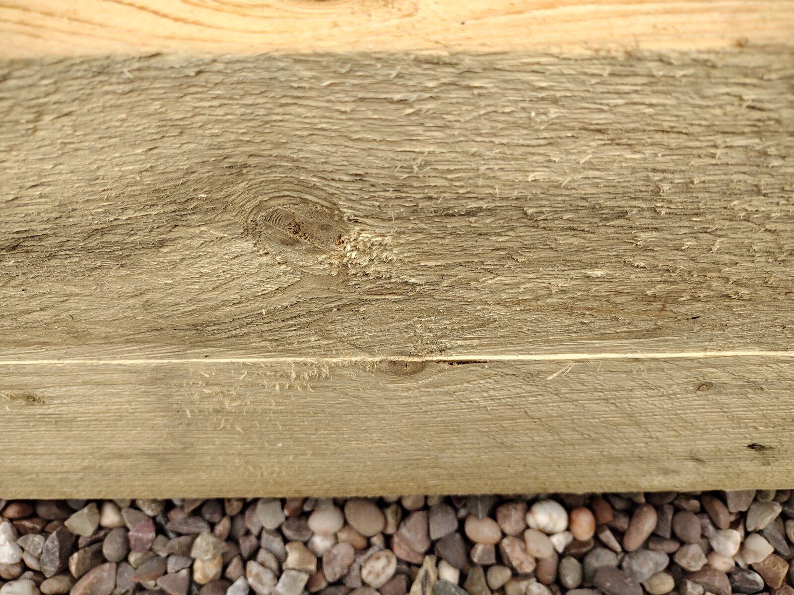

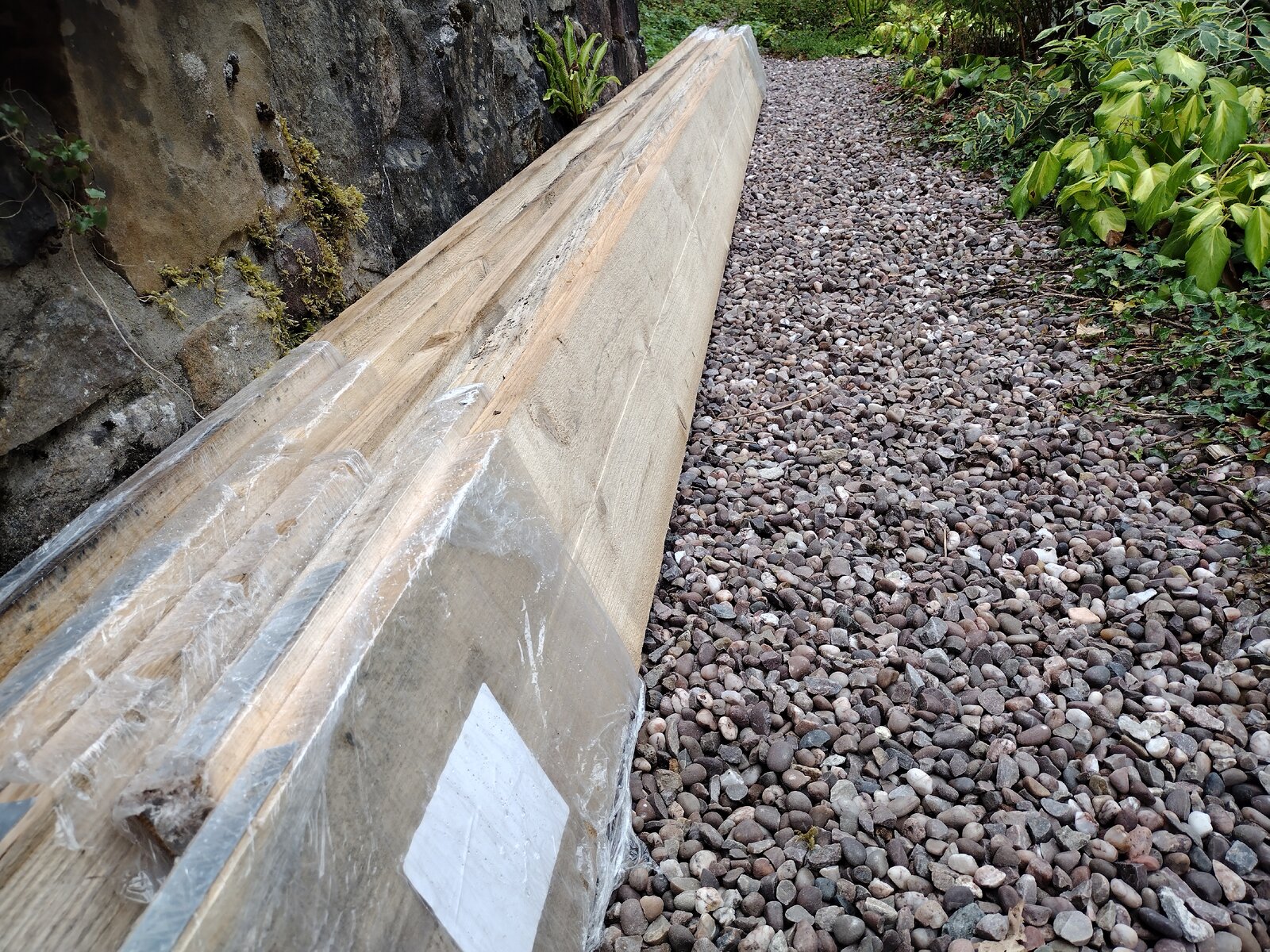

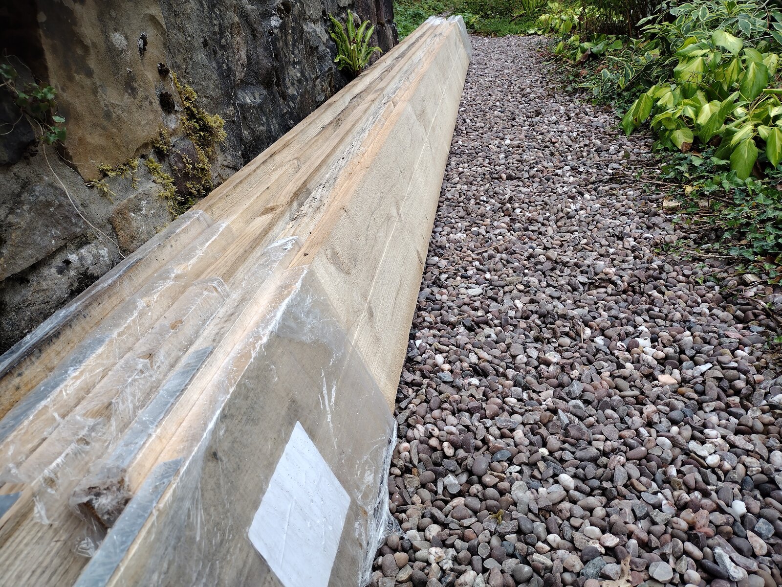

I bought some new old stock scaffold boards. I've never had or used scaff boards before so not sure what is acceptable or cause for concern.

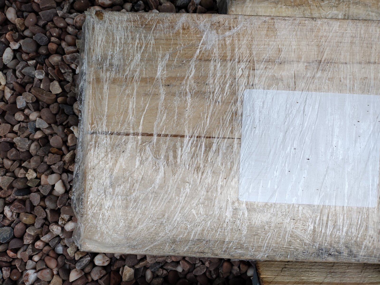

One of the boards has a lip along the entire length. A couple of others have a similar lip but it is a lot less pronounced. Curious also as to what causes it? To begin with I thought they must be two separate lengths joined, but on closer inspection that doesn't seem to be the case. Here's a couple of photos of the worse one:

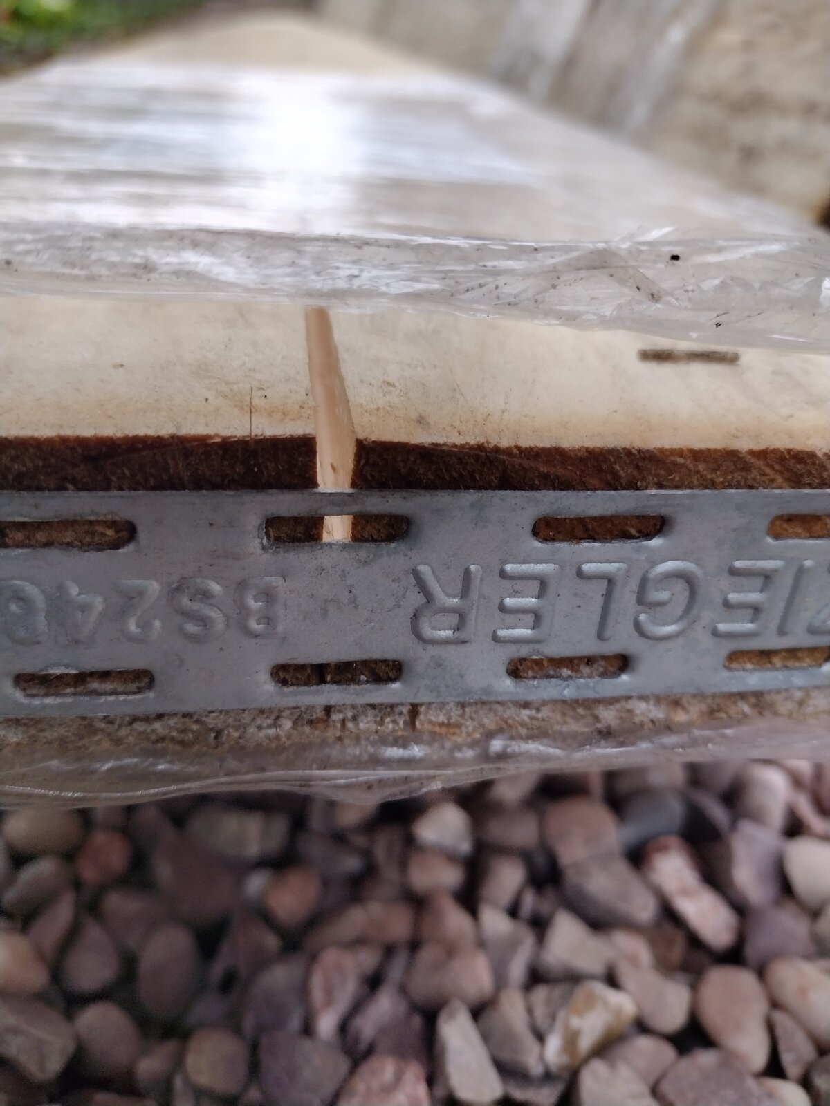

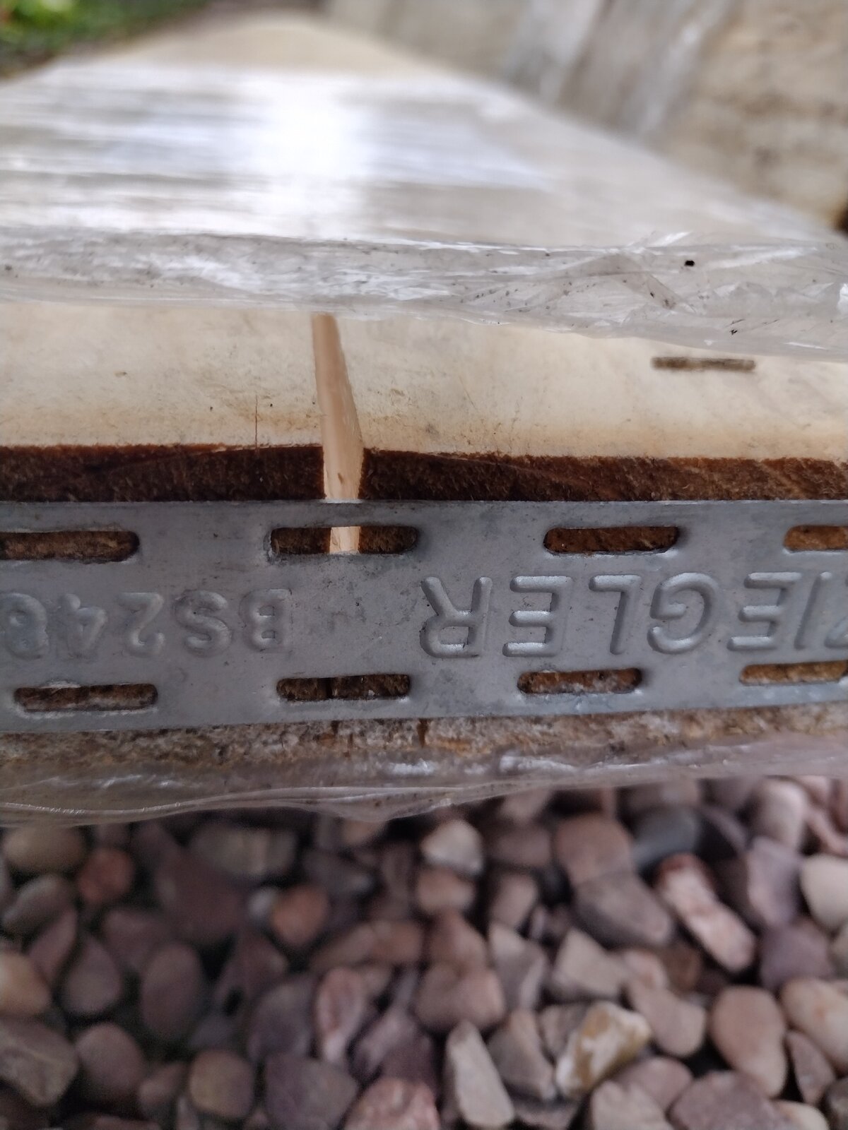

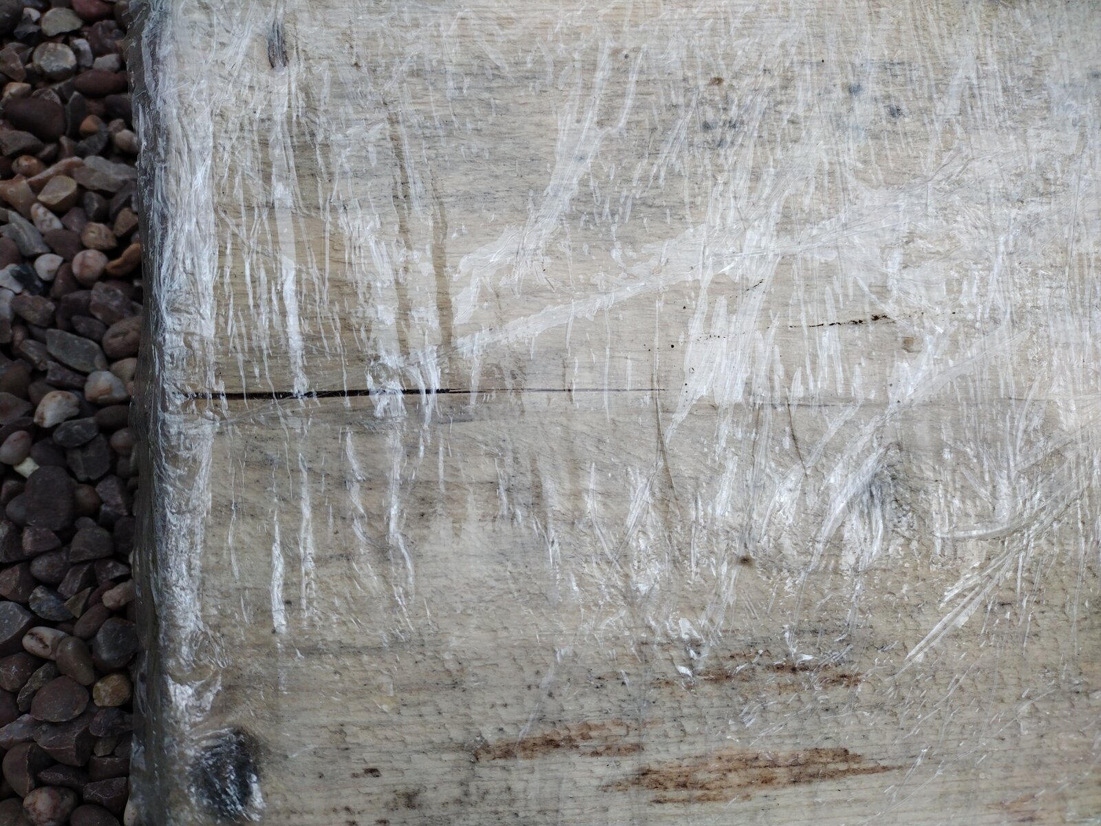

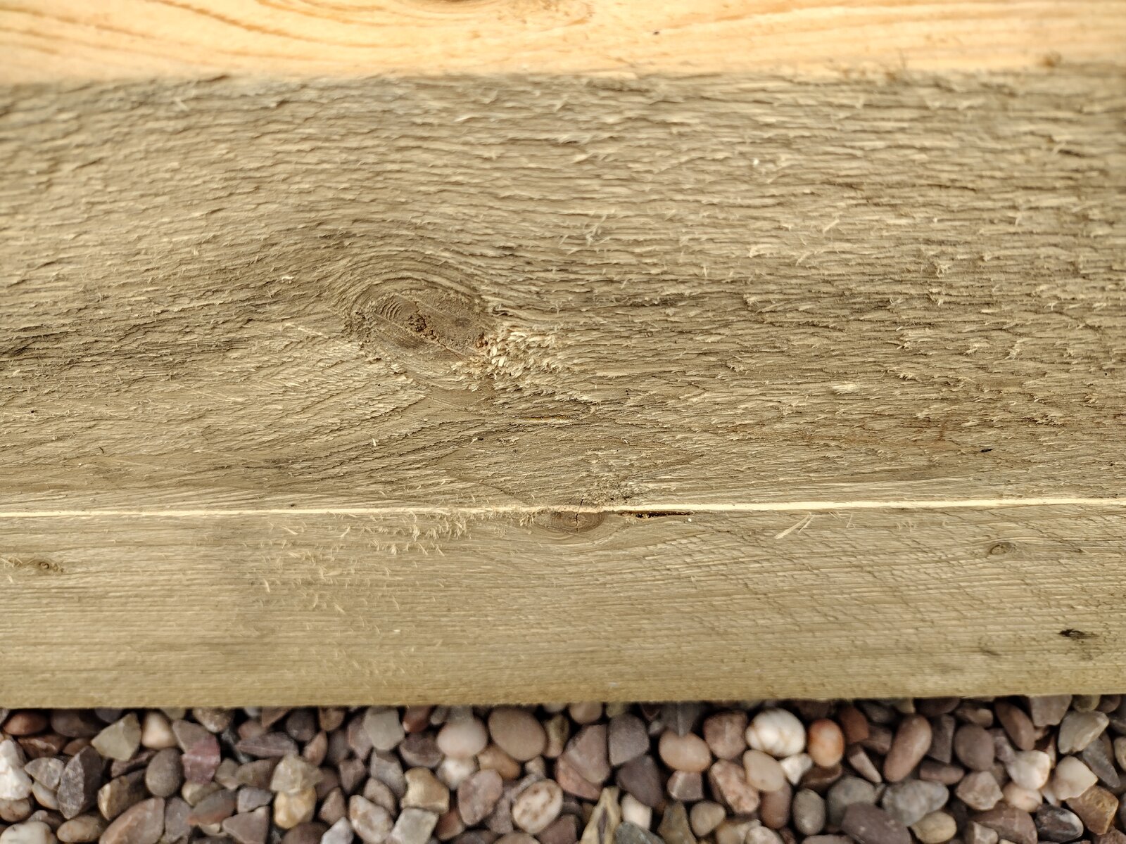

One of the other boards has a more severe but much short split at one end. Here's some photos of that one, top middle and underside:
Any thoughts most appreciated.
The lips are just machining (planing) marks. The galvanised straps at the ends are designed to both protect the ends of the scaff planks and mitigate minor splitting (yours is minor)
