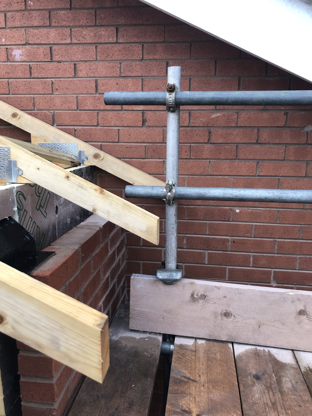

I’m just starting to fit my roof/fascias etc and realised the scaffold poles are in the way on the front side of the extension (okay at back). Also the guard rail goes between two rafters. I’ve contacted the scaffold guy who said “I asked you about the fascia’s, the poles will need cutting and I’ll have to charge you”. I don’t remember any such conversation!
I’m disputing this charge so he’s coming around to look later.
Am I being unreasonable to expect that the posts wouldn’t be in the way? To me, they left the poles too high, and what is the guard rail all about? They are fine at the back but too high here.
Just say can I cut the top foot off a pole and are you ok with that, doesn’t involve him doing anything so he might be ok with it. You can shift the guardrail by slackening off and retightening the bolts.
Get the disk cutter out
Could do it myself, i'll have to check he's okay with it I suppose.
The up pole is still in the way, so the handrail needs removing then that cutting.
LOL at the handrail up against a wall! o_O
Glad it's not just me that thinks it's weird!
Whose responsibility is it to make sure the scaffold is:
a) the correct distance from the wall/roof
b) the correct height to allow for the roof
Is that my responsibility or should he be using some common sense, like looking at the existing house and thinking... "so the existing roofline is xyz height and comes out 30cm or so, so i'll set the scaffold to below that and out enough"?
Maybe I expect too much from people! :LOL:
The handrails will self -support off one clip, so either cut the standard below the soffit and leave the handrails, or take them off. It's common.
