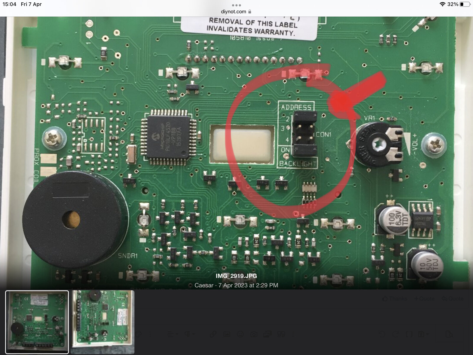

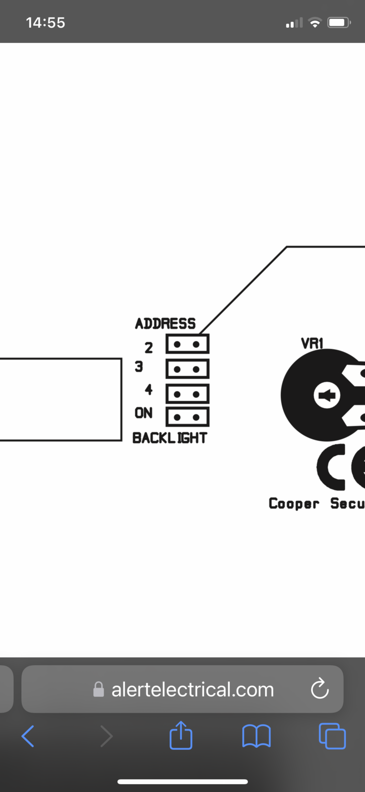

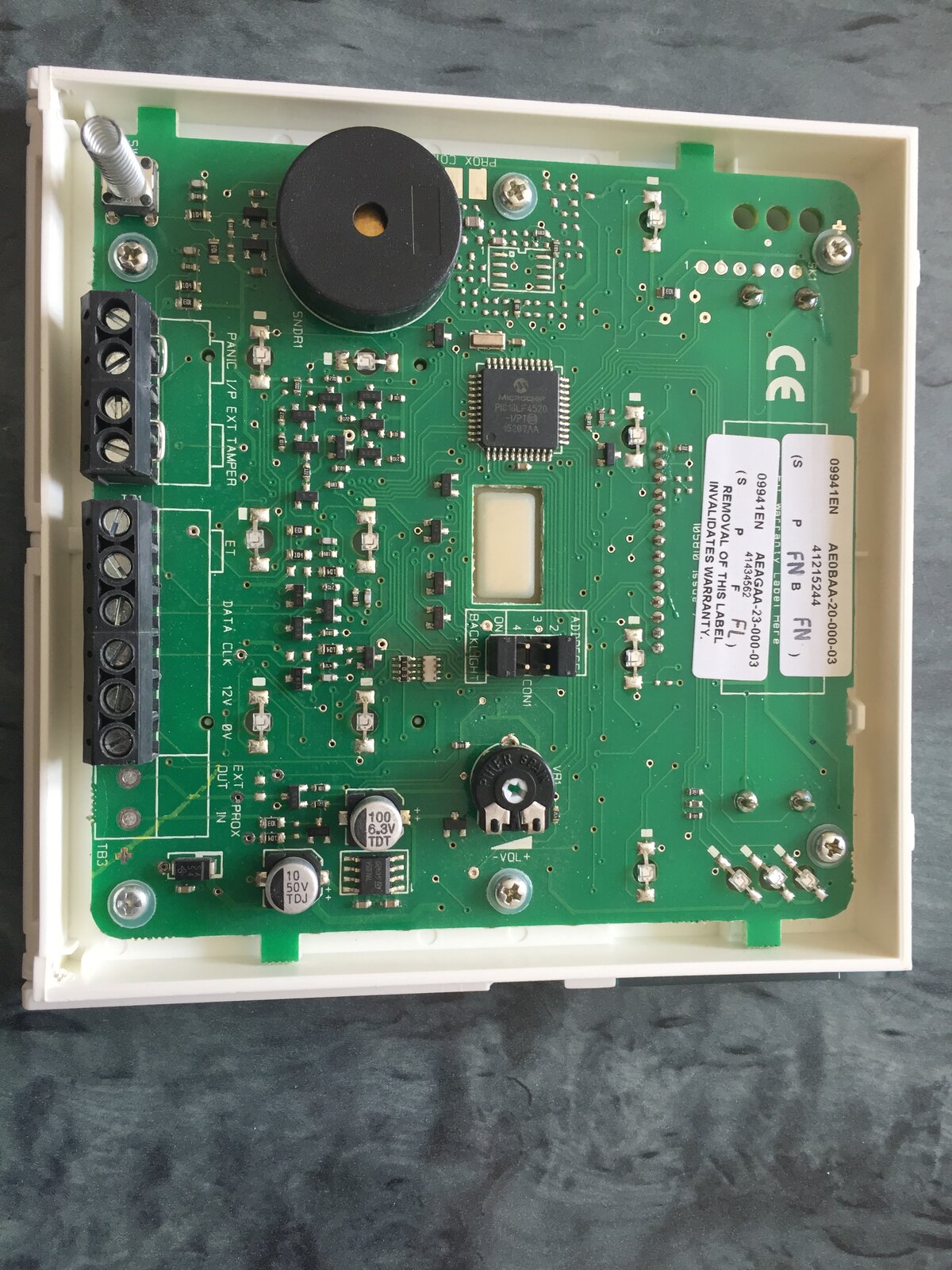

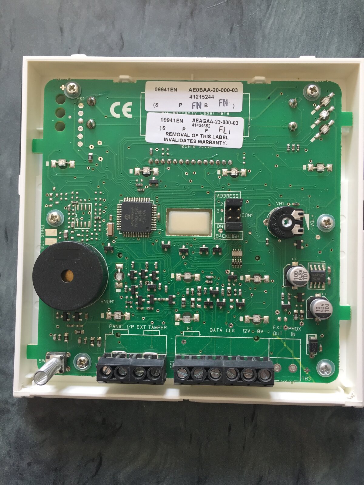

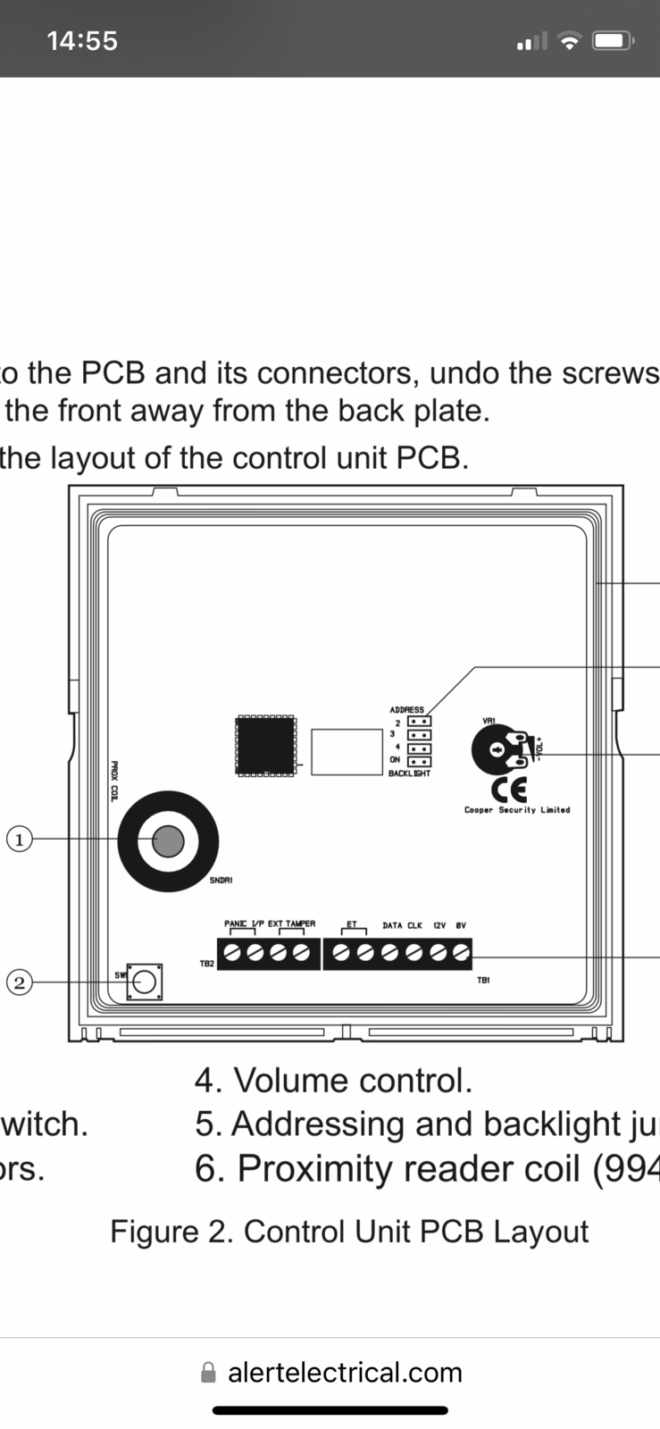

Just reviving an old thread now that I have finally found an 9948 EN Keypad which I am replacing for an Scantonic 9651 Keypad.
I only have 1 Keypad so do I have to change the Dip Switch settings on the 9948 EN Keypad when installing it or can I just do a like for like replacement? If the Dip Switch settings are to be changed what should they be set to or can i leave as default as per the Image attachments?
9651 from memory has no Dip Switch settings or am I wrong?
Many Thanks.

That keypad is set to address 2 remove the link jumper
