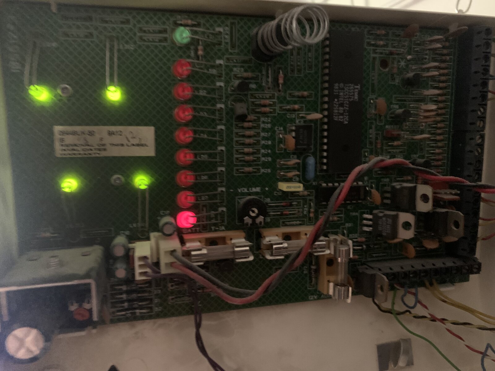

We have a Scantronic 9448+ original alarm that It has not been serviced at all in 15+ years, as it has worked fine up to now.
The keypad has started to be difficult on certain numbers, so I changed the code. However, it is still not always responding to the code (it beeps when numbers are pressed, but doesn't deactivate).
Is it possible to repair/replace the keypad please? If so, how?
Thank you

The keypad is built into the alarm control box rather than a separate standalone keypad. I did search online but it seemed to just bring up photos of either a new more rounded control box with the same 9448+ number or a separate standalone key pad. Does it mean replacing the full control box? Thank you
Or clip out the pcb , remove the keypad mat , clean with a cotton bud and meths…it normally works

Based on reading other posts, and caution, I assume 1) switch off electric to alarm at the fuse box 2) open control box and enter code to switch off anti-tamper 3) unclip pcb 4) clean the back of keypad and also panel 5) reassemble 6) power back on?

I finally found time to look at this further. I removed the fuse, opened the panel and put the code in to switch off the alarm.
I could unclip the panel below it but it still seems to be fastened in somehow (not just slotted in at the top). I didn't want to force it out - am I missing a fixing (or screw/bolt) somewhere please? Do I need to remove those two screws between the top and bottom green lights, or is there something else holding it in? I didn't want to remove if it then broke the control panel.

Thank you. Control panel removed, key pad and contacts cleaned with alcohol. Alarm buttons are now much better and seem to be working correctly.
