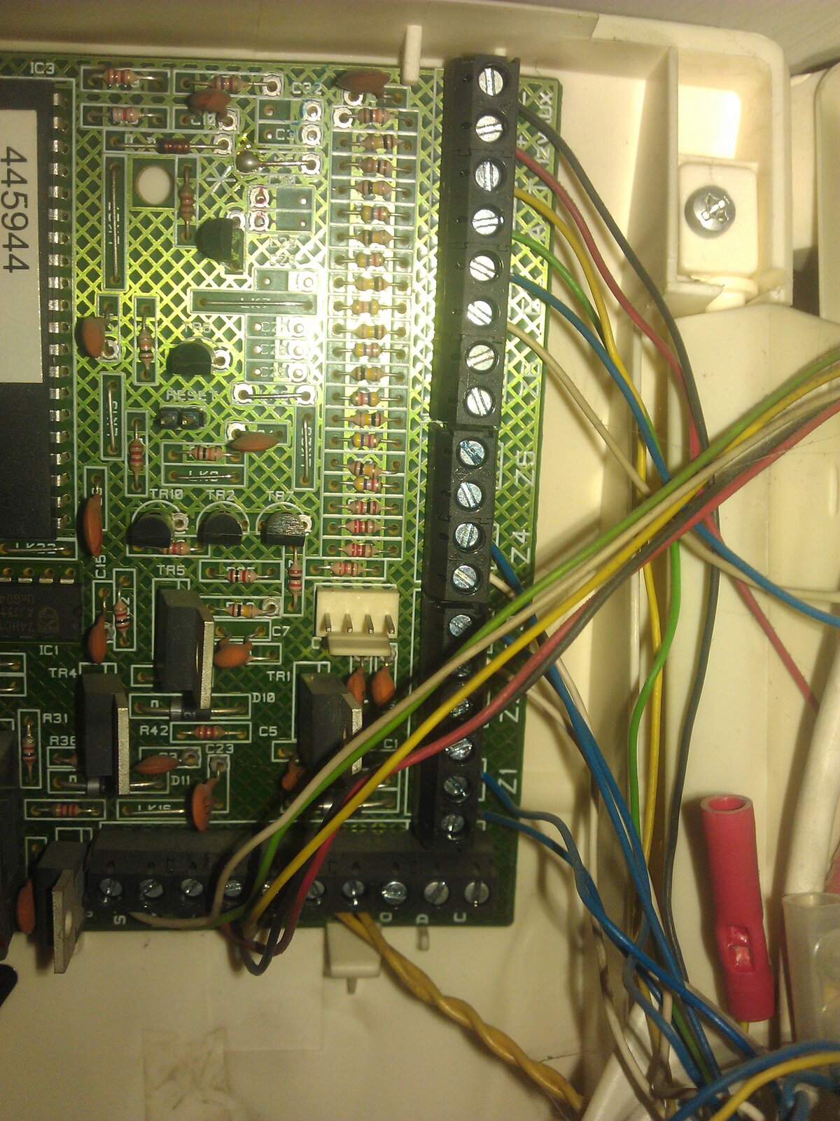

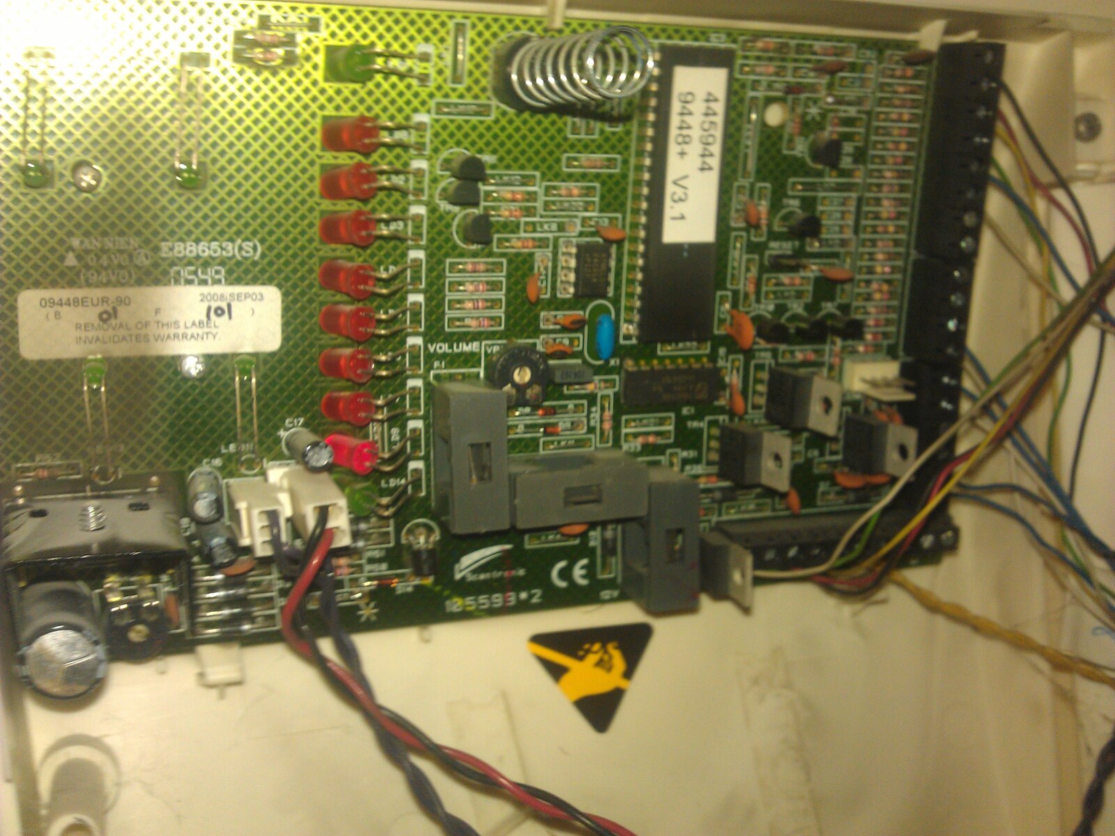

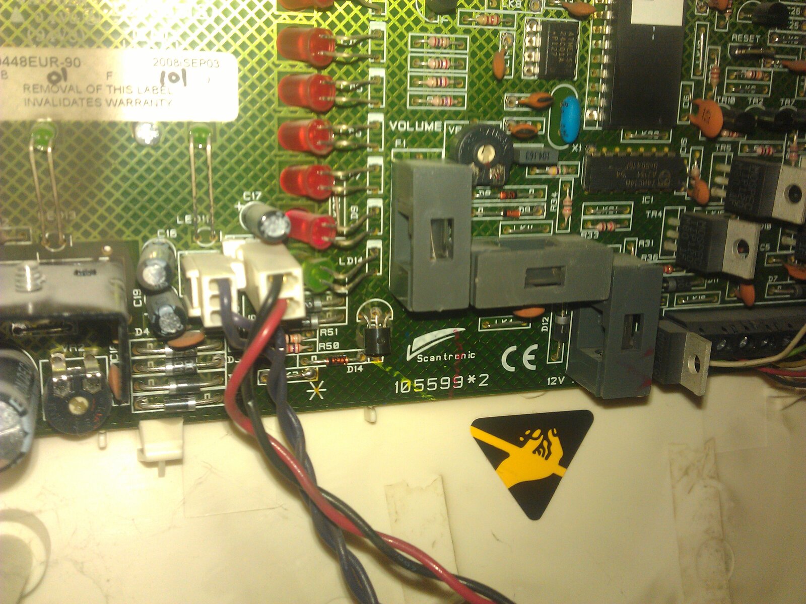

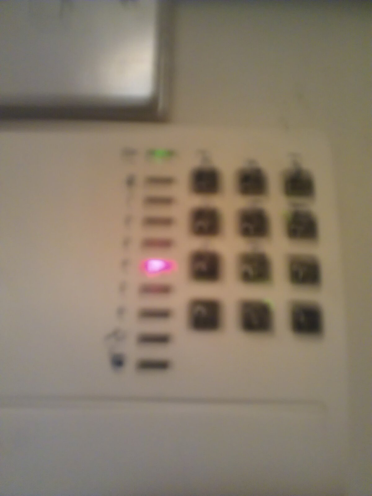

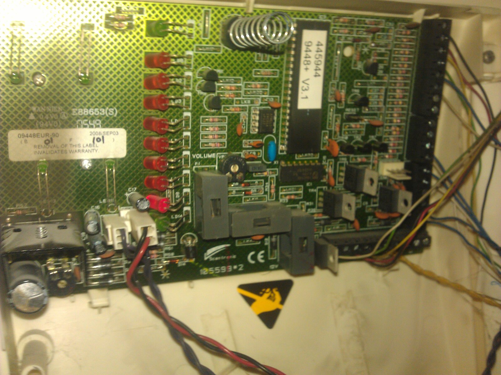

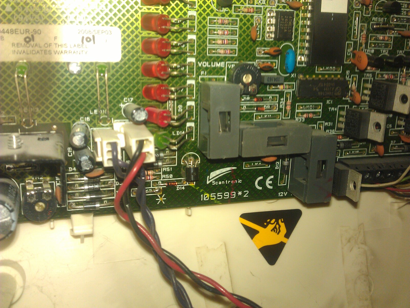

Hi, I don't know if you can help me, I have looked through the threads and I cannot see my specific issue, When I set my alarm it emits an internal alarm noise but nothing from the external bell,I tested the external bell, and it works, the number 4 zone is lit up red when I input the code to set the alarm, the lights blink on the two ceiling sensors and the 4 sensors on the doors and windows visually appear OK, I last changed the battery in 2016, for some reason it blew a fuse ,but I replaced that, and it all appeared fine, I was wondering if there was a way to disable the number four zone so I can still use the alarm, I have a new Battery being delivered tomorrow just in case It's that, thanks for looking

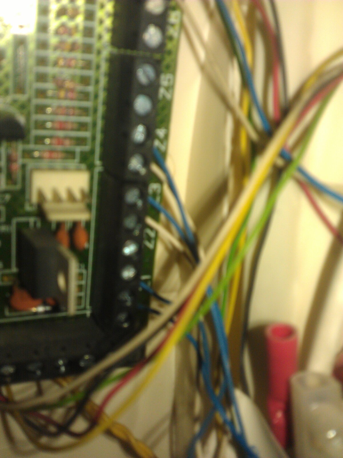

Is there any thing wired to zone 4 ( look inside alarm panel ) if not and there is no shorting link fitted , it will need one or program it as not used ….. if there is something wired to zone 4 then it’s faulty / open circuit
Sorry I am totally blind where wiring is concerned , I hope these pictures help, 4 is used,it looks like a circuit fault then?, is there a workaround. thanks for your help

open all the doors see what lights up …..close one at a time , now see what lights up ….
Hi I did as you asked, my kitchen window zone 1 and kitchen door are zone 3, my lounge window is zone 1 and my kitchen and longe ceiling sensors are zone 3, the front door (the entry point) didn't trigger any additional buttons to light up , only the number 4 button remained lit, the number 2 button did not light up, it doesn't appear to be wired

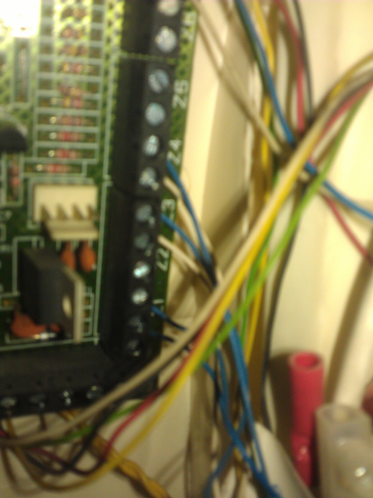

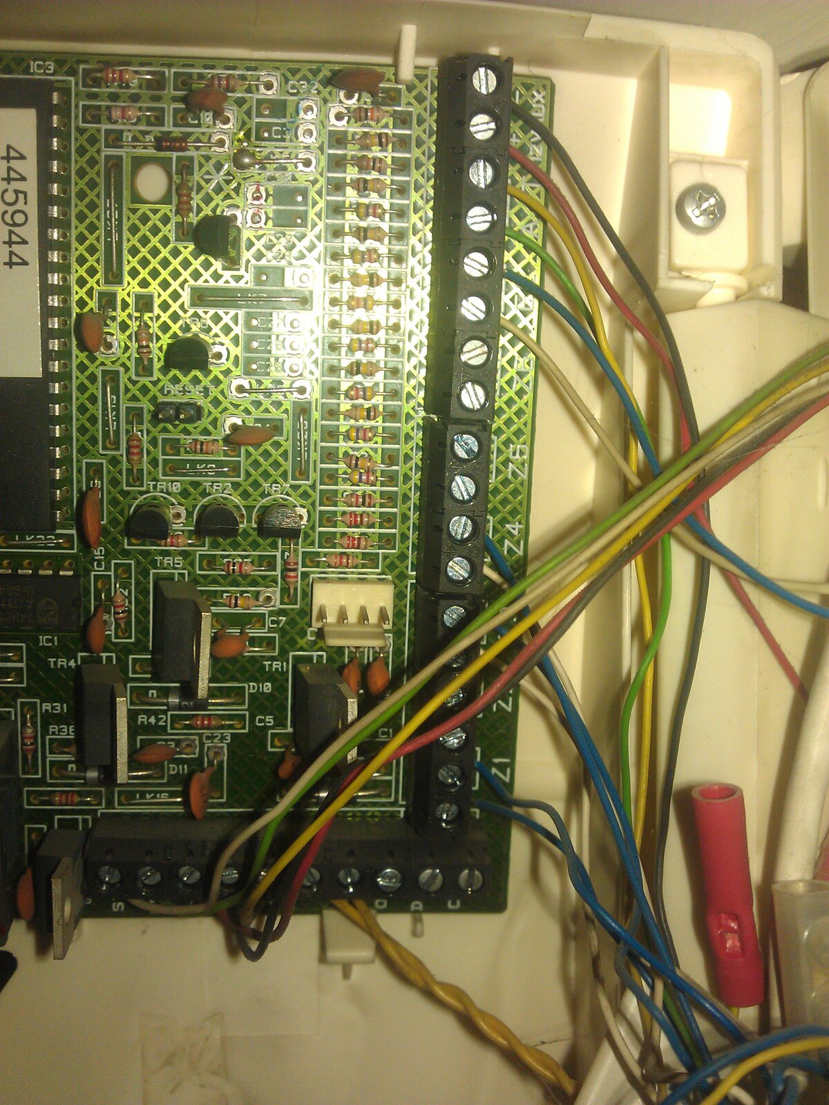

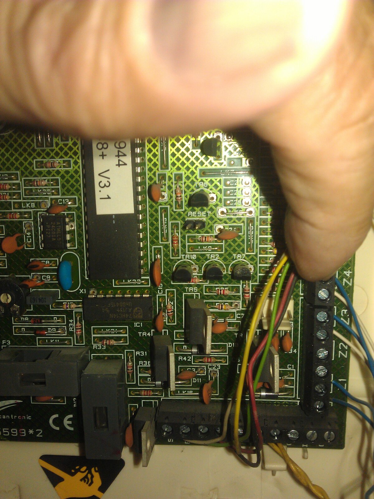

would it be possible to remove the wires from zone 4 and insulate them with shrink tube ,or move them to another zone so I can use the the system?

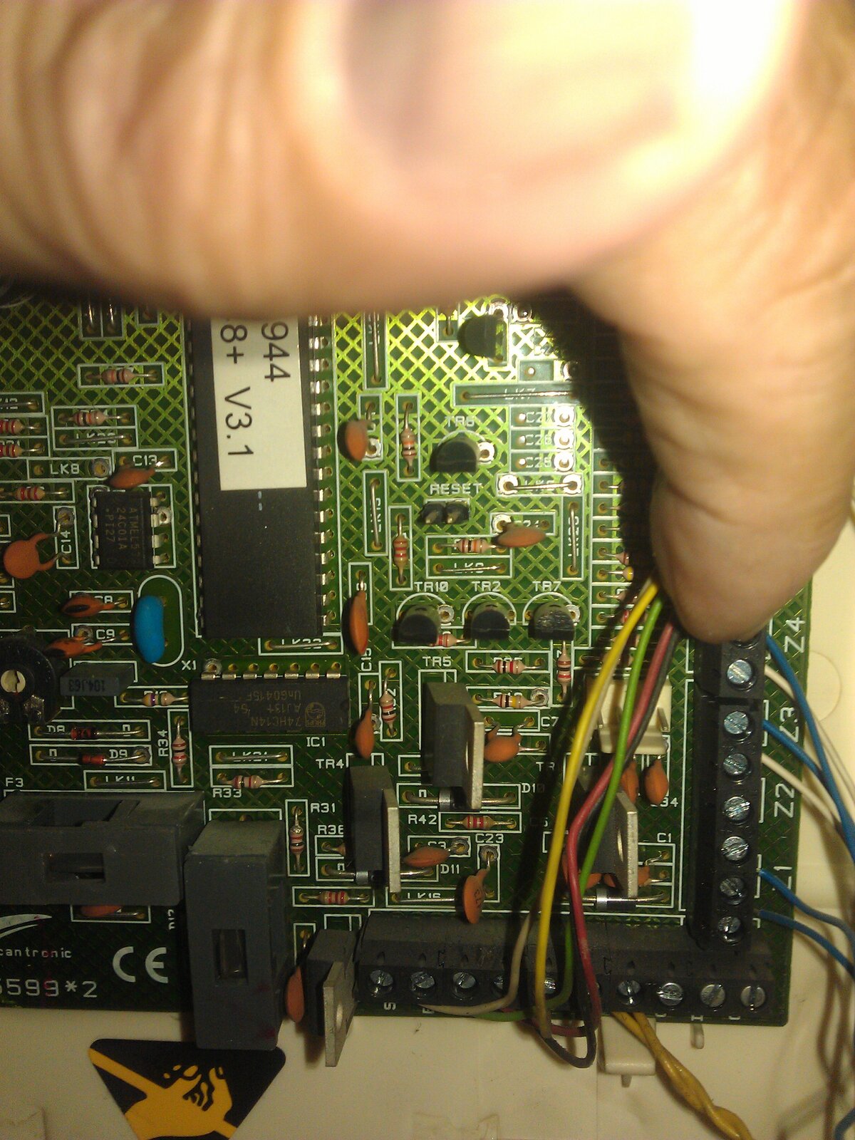

Remove the wires from zone 4 …put a wire shorting link in the zone ….now fully test the alarm …
I'm sorry, I don't know what you mean by a wire shorting link?, do you mean place a piece of wire between the two terminals on zone 4? as in bridging the terminals? and do I need to pull the mains fuse first
thanks
thanks I will try that in the morning , I have had a drink and I am nervous around wiring at the best of times. thank you
Good morning, I did as you asked, and the zone 4 light is now out, I set the alarm and walked into the lounge and the outside and inside bell sounded, however when I set the alarm and went outside, as soon as I entered the house the box made an intermittent bleeping sound, and no alarm went off until I walked in front of the sensor in the kitchen ,and that only activated the inside alarm, thanks

Can’t comment on zone 4 ? Without any labels on the cable or paper work it’s anybodys guess ? It’s not the first time I’ve been to a job and a device has been left above a unit in a kitchen or above a ceiling after building work..
Ps yes the bell won’t ring on a bad set ( door left open on a setting ) as the alarm has not set ….also running out of time on entry does also give a pre alarm ( no bells ) of another 30 secs on that panel
