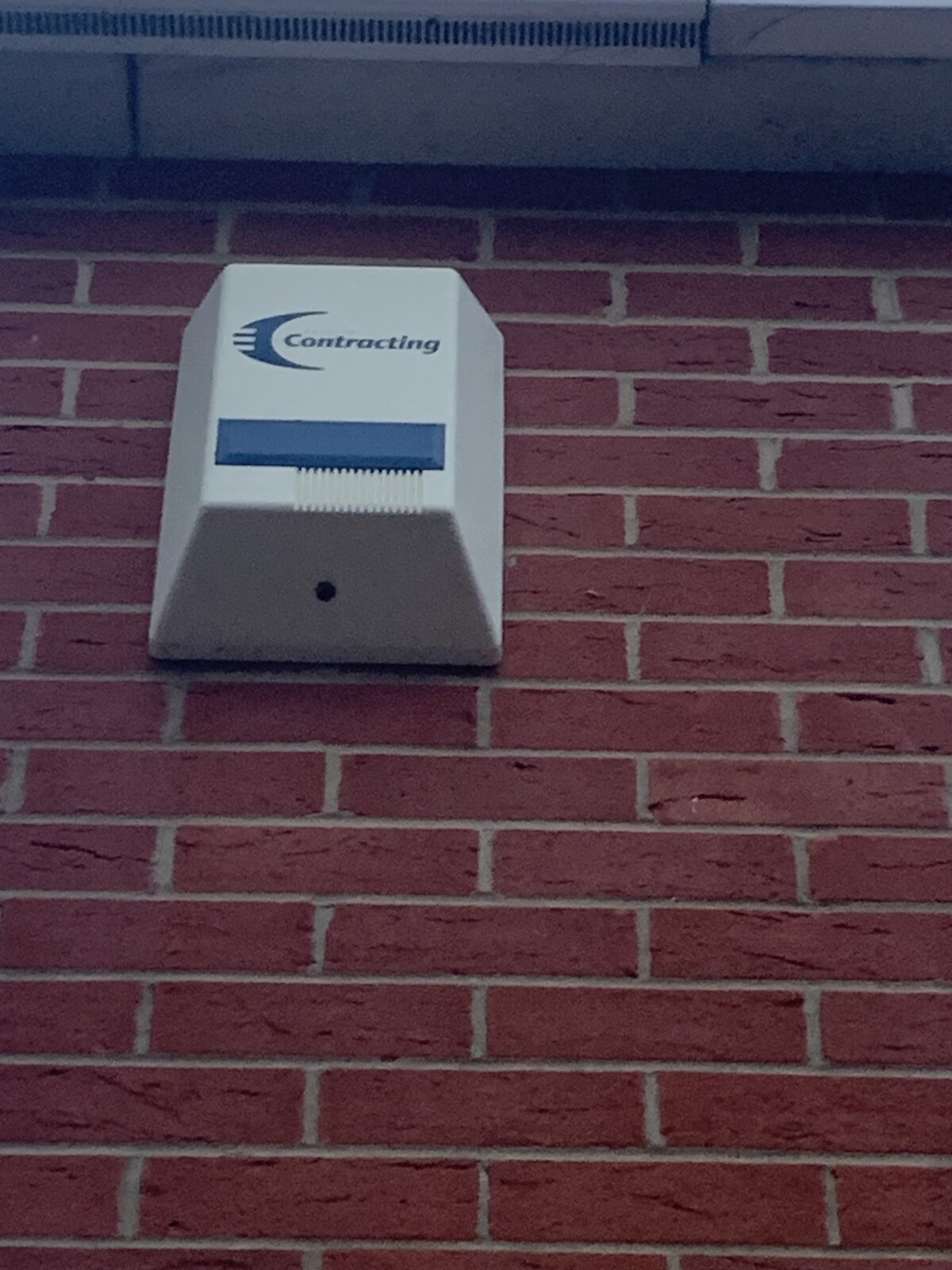

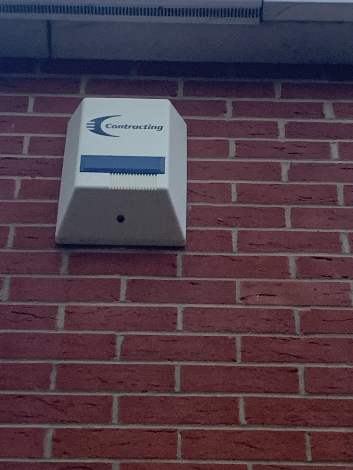

Worst case get ladders out or wait 20 mins for the cut out timer to kick in ….post picture of external bellbox
Thank you for the response. Photo attached.

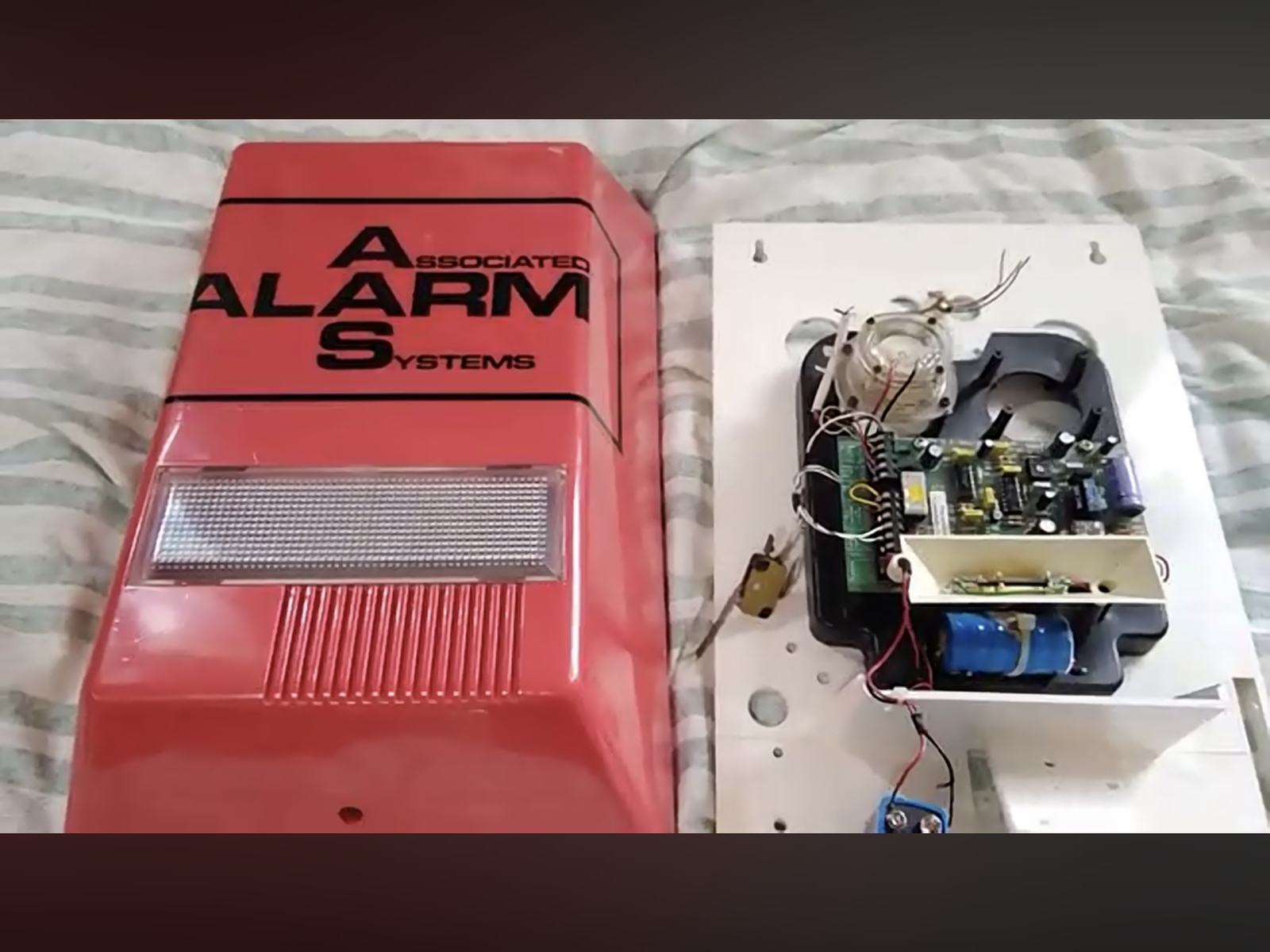

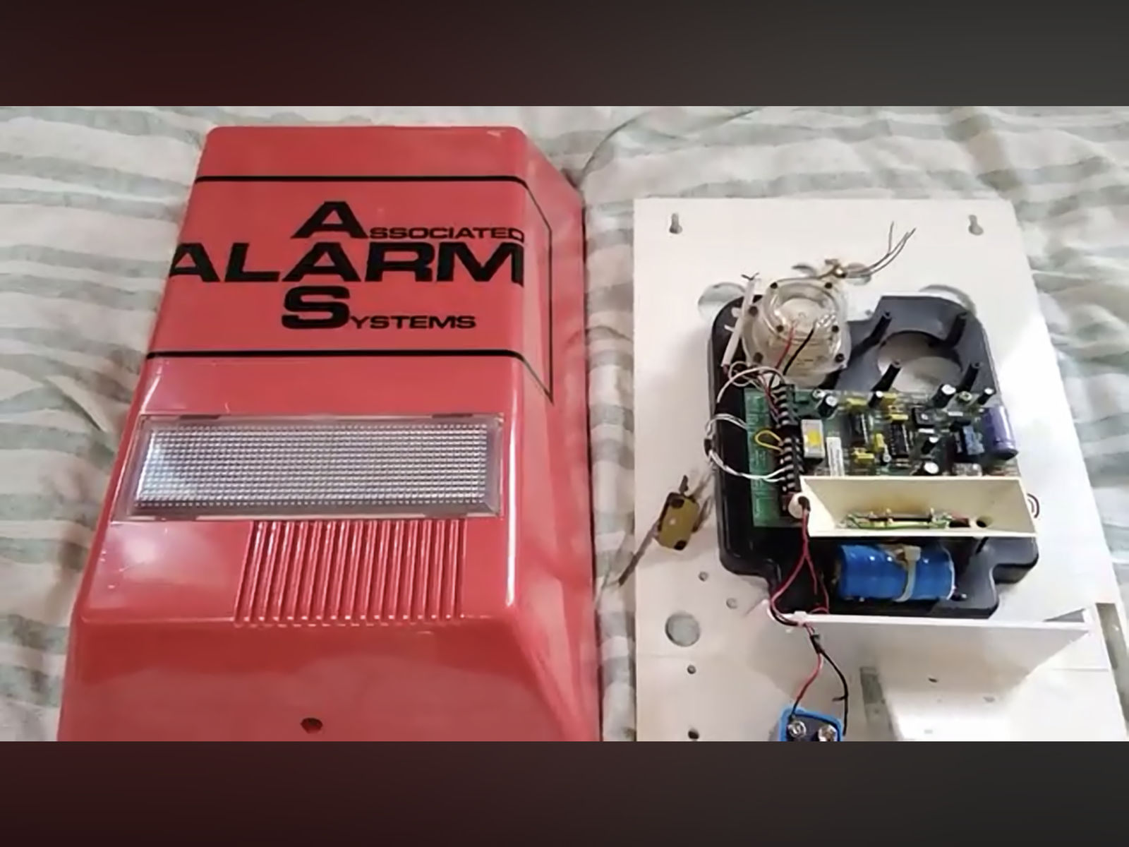

So effectively you are agreeing with my plan as the way to disable it but in case the alarm goes off, only way is then to climb up to the box, open it and rip the sounder out? sounds like I may have to attack the box
Any tips when box is opened. Never seen the inside of one of these before.
Thank you mate
Look for a battery , could be like a C cell with a red and black wire going to the pcb just remove one of the wires
CQR INTEGRA
