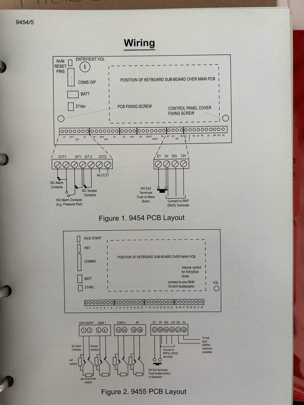

Does anyone know if there are kick start pins on this model or just nvm. Thanks
As below
