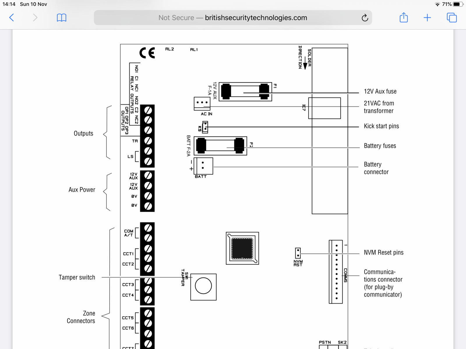

Hi All
I have a scantronic 9751 which has a bell tamper. We are having rendering done on the house so i had i remove the bell box from the outside wall. I put the alarm in installer mode and have disconnected the bell box from outside. I also have a sounder on the inside of the house which i am happy to continue to work and i still want to set the alarm at bed time and when we go out, but i now can not exit installer mode due to the bell tamper.
is there a way I can disable the outside bell and then re enable it after work has been completed and the box is back on the house so i can continue to use the alarm as normal?

Top right hand side of pcb ....outputs ....put a wire link from TR to 0v (aux power )
