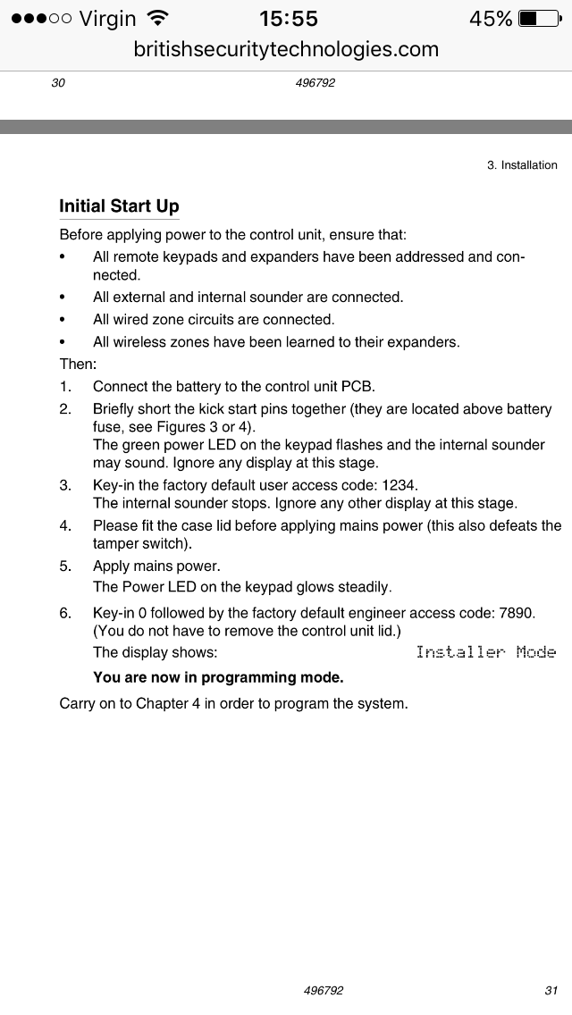

I have replaced the battery via the following steps from the manual:-
Removed mains power (silenced alarm)
Removed lid
Removed battery (old)
Applied NVM & K/S jumpers to short the pins
Connected battery (new) – Silenced alarm with default code
Replaced lid
On the 9930 control display I have:
LID TAMPER (then)
RESET REQUIRED (repeatedly)
But default Engineer Code 7890 does not work!!!
I have tried the process twice with no joy.
I assume the tamper switch works, it's just the engineer code reset I require but the default '7890' just gives me an "invalid code" on the display.
Any ideas?
Thanks in advance.
Found this
