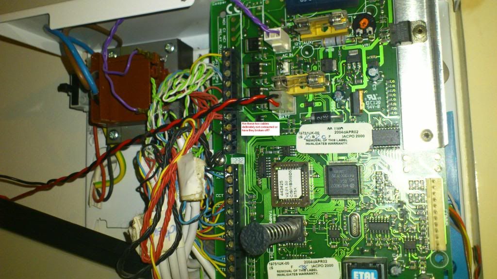

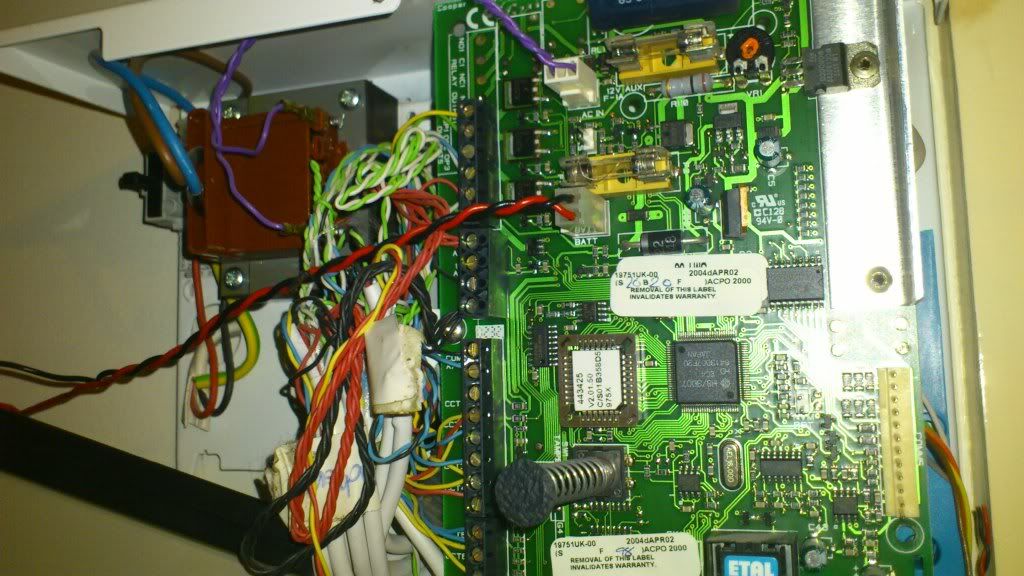

I took a picture as I was not too sure which connection you were referring to.
Hope this helps at all, if not than please point me to the right direction.
PS: I found that couple of cables are clipped not sure if they broke off or if they are meant to be like that i.e. unconnected.
yes looks like the aux tamper is used . has somone put fuse wire around the battery fuse ? if so what rating ???? the last time i had a fault with all zones showing was when there was a 0v short to one of the detector alarm zones, has any other work been done ?
Yes, it looks like someone has put fuse wire around the battery fuse. I have no idea what rating it is. Unfortunately I have inherited the system with little details on what work has been carried out till present.
But the result of walk test etc is all fine, do you think there is some other issue?
get somone in to have a look at system, check all voltages with a mulitmeter for a start 12 -13.80 at aux volts and battery, it may have been damaged if the fuse wire was 5amp and the battery went faulty.

Probably not connected before, the single resistances are probably because there is a "Global Tamper" and they took that rather than them separately.
There does indeed seem to be a strand of something around the fuse holder, it deffo needs checking out.
On that panel the battery needs to be connected to get a voltage at the battery leads.

Thats the battery fuse IIRC.
Not sounding too good because of that.
What is that fuse wire rated at if you can tell.
Could be a spiked board now, but lets take it step by step.
