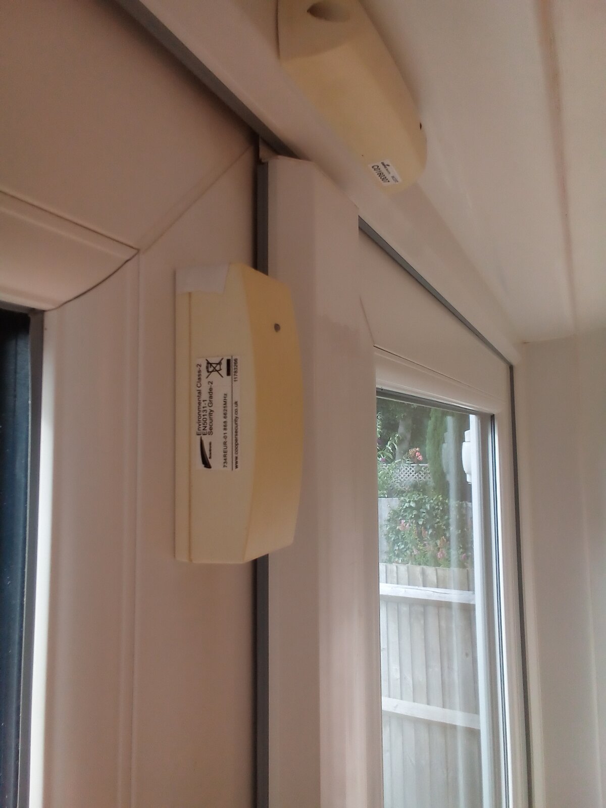

Post photo of door contact.

Pic attached, the top cover retaining clip broke it has a bit of tape holding it on.;)
Plastic cases breakdown over the years and become brittle. My bet engineer broke casecehen charging battery? or didn't know how to remove cover !

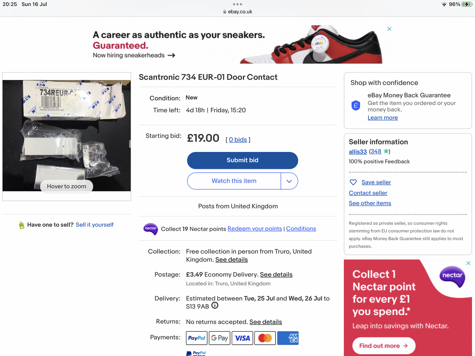

You could buy and just swap the plastic case,this will save any programming.
Yes seems the best way to go, shame is I used to know the engineers code, but this lot have changed it, but it will only take a couple of mins to swap so not a problem.(y)
