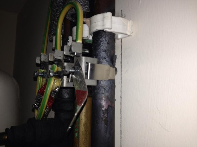

While checking out a bad smell, located in cupboard I came accross pipework that had scorch marks and a shale deposit covering them.
it seems to start from where the earth bonding starts and continues about 2 foot below.
Its a cross between when a pipes been overheated with a blow lamp and a reaction of some sort.
Help appreciated

Hot,cold feed,balanced c/f,and blow off have got a crust of like iron shale, really crumbly.
Then as the pipes get lower they've turned black /grey , exactly like 40 year old cold pipes go, that really dull ,knackered look!
The flats are only max 10 year old
It all originates from the earth bonding clips. These are in a row of pipes. further away from bonding it gets gradually better
It's quite worrying as it looks like a reaction between metals or something electrical???

Hmm, it almost sounds like the pipes are being anodised.
I know this sounds weird but if there is a low voltage leak then the earthing bonding straps could be sacrificing themselves. Are the clips in good condition or do they look like their 'corroding'? If they are I'd get a spark in to check the main equipotential bonding and the RCD/MCB's just in case and check for a current leak.
Sounds more like an electrical issue than a plumbing one, having said that it would be interesting to know what the issue is!
Yea , you nailed that on the head
It's exactly what's happening, the pipes are sort of acting like a sacrificial annode
The straps are in good condition, so are the cables, the only slight change is the copper bonding cables have discoloured, once again as if they've been left to the elements

Yeah, the fact that the earth straps are all shiny kinda rules out the potential for it being an electrical sacrificial process I would think though it could be a form of electrolysis. What you have there is copper oxide which is a form of copper rust. How's it's forming is another story.
Is there a funny smell in the area that the pipes are located? Is that a copper pipe in the middle that isn't affected?

There are areas where the pipes look like they've been heated to cherry red then cooled and left purple blue heat marks. Thing is these heat scorches are nowhere near soldered joints???
There's also a temp and pressure relief valve located under suspect pipes that's turned that dull black colour
Your right, it looks like ones not been affected!
Too busy looking at problem and missed that!

OK, if one's not affected then we can rule out anything in the environment that is causing it, corrosive gases etc I would think but check for bad smells. Are you getting discoloured water at all? Is the valve conected with an un-vented hot water cylinder? If, so it may be time to get someone in who's qualified for that type of hot water system to check it hasn't been compromised.
Yea, the reason for going into the cupboard was a bad smell.
Your good u!
But I located it coming from the pressure relief turn dish, going into a 1 1/4 waste pipe with no air gap .
The corrosion looks too localised to be affected by that.
But saying that its in a closed cupboard, within a meter of each other?
And yes it's a unvented with no heating they have storage heaters
Discoloured water? I ran hot /cold on bath and water ok
