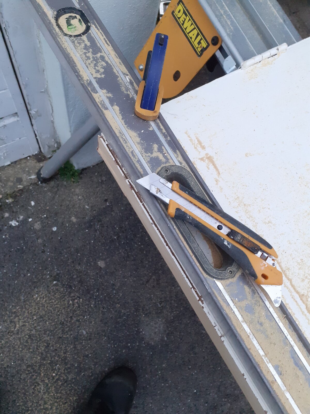

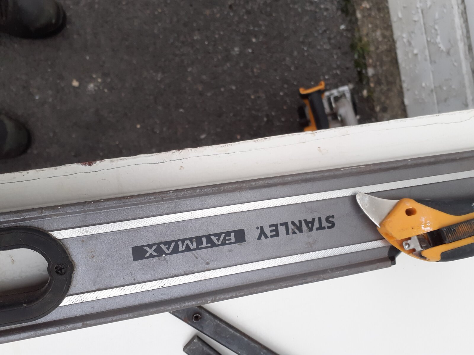

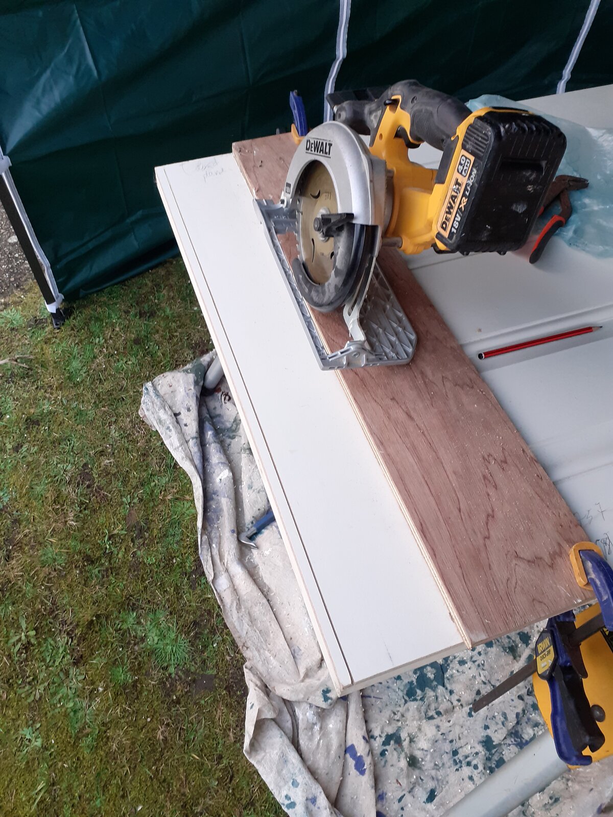

I lined circular saw cutting edge to where I wanted cut then righted the clamps . Do you score a line half a mm above this point to prevent chipping?

If you think it's going to chip then yes score the paint, might be as well to square the line around the door a score the other side at least then neither side should chip, finish with sand paper.
Cut through two sacrificial boards each side and it will prevent chipping.

Sand after cutting I guess. Once you've worked out where blade is cutting on circular saw do you score the door exactly where the cut is going or 1mm higher so any chipping will only be 1mm high?

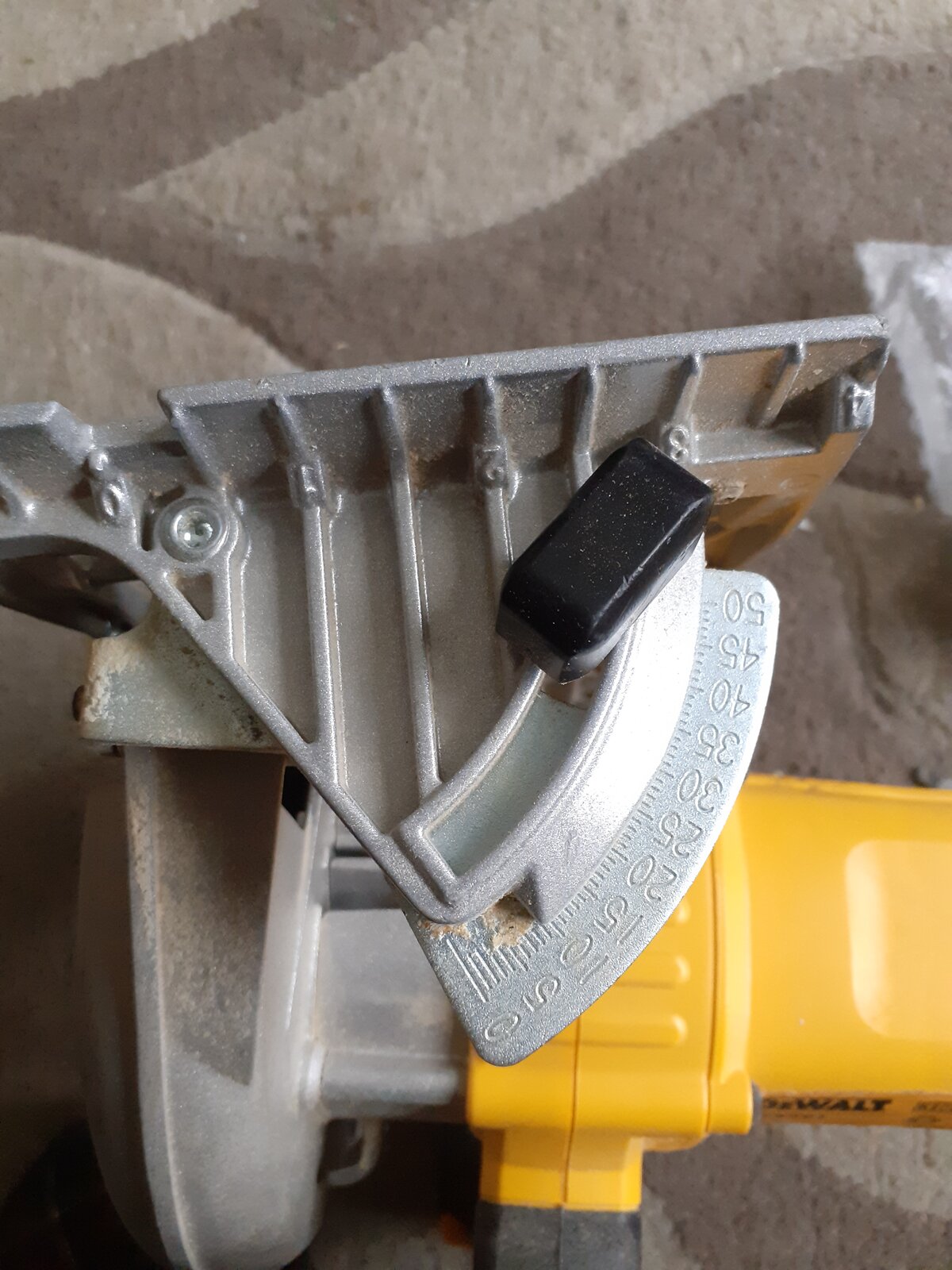

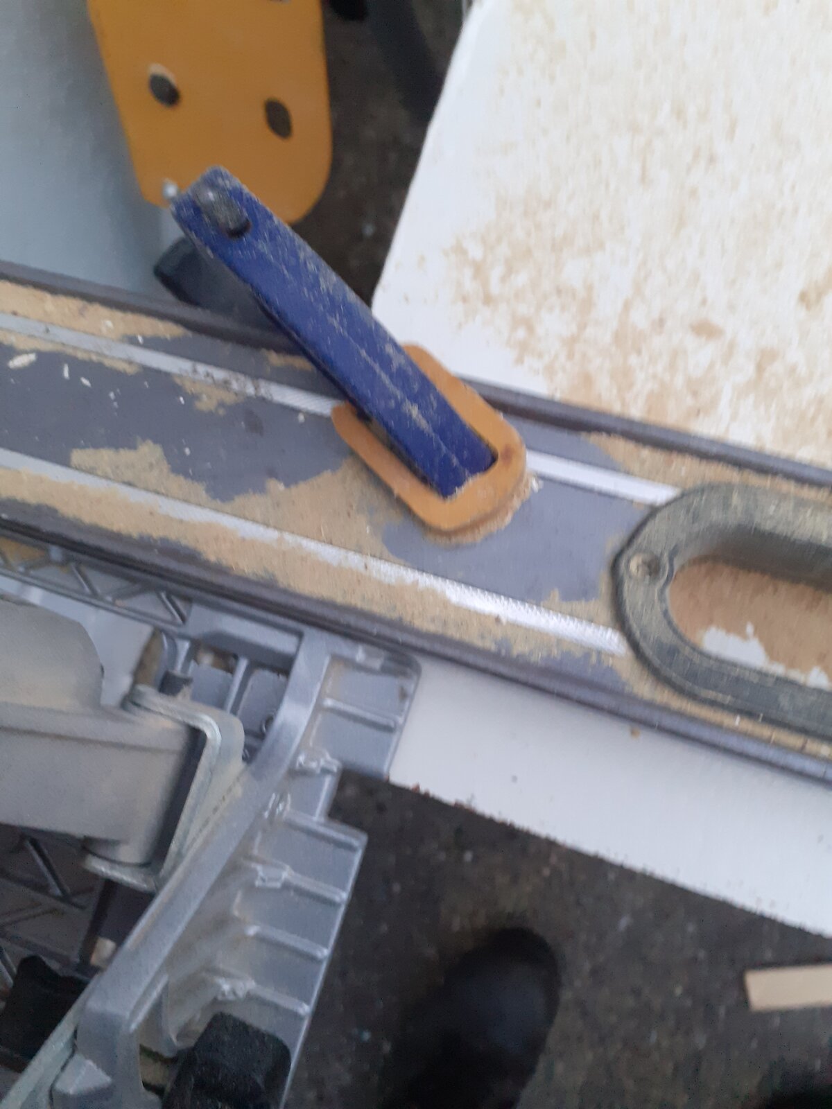

If you turn the saw around the other way (so the majority of the base is sitting on the door, not just a tiny bit - your straight edge will need to be a bit further up from the bottom AND a lot thinner, say 12mm plywood) there is another technique:-
1. Set your straight edge up and clamp in place
2. Score the exit edge with a knife and steel square
3. Set the saw to make a 1mm deep cut - NO MORE THAN 1.5 MM UNDER ANY CIRCUMSTANCES
4. Make a scoring cut by drawing the saw slowly backwards whilst holding it against the fence. THIS IS A CLIMB CUT AND NEEDS TO BE TAKEN VERY SLOWLY INDEED. ABSOLUTELY NEVER MAKE THIS CUT WITH MORE THAN ABOUT 1.5 MM OF BLADE PROJECTION AND NEVER STAND DIRECTLY BEHIND THE SAW. This is called a scoring cut
5. Set the depth for the main cut. I suggest sawing the door in 2 or 3 incremental passes if using a cordless saw or a corded saw if limited power
6. When finished if your door is veneer-faced I suggest adding a 1 to 2mm chamfer to the front and rear edges with a very sharp block plane used at a skewed angle, planing into the door, as this will limit any tendency for the veneer to catch on flooring and chip off. This is especially true of thickly carpeted floors. I sometimes do the same with laminate-faced commercial doors if there is no intention to protect the door bottom with a kick plate. Even if you don't do a scoring cut this micro chamfer can be very handy to deal with minor chipping
Even if you don't use your saw this way, running the larger part of the base on the door, as opposed to attempting to run the narrowest part of the base on a tiny ledge, as shown in your photos, will be safer and will more readily produce an edge which is perpendicular to the surface and is considerably safer

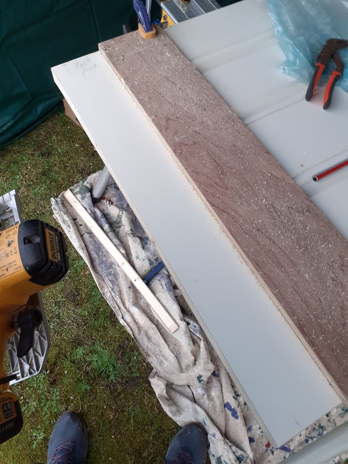

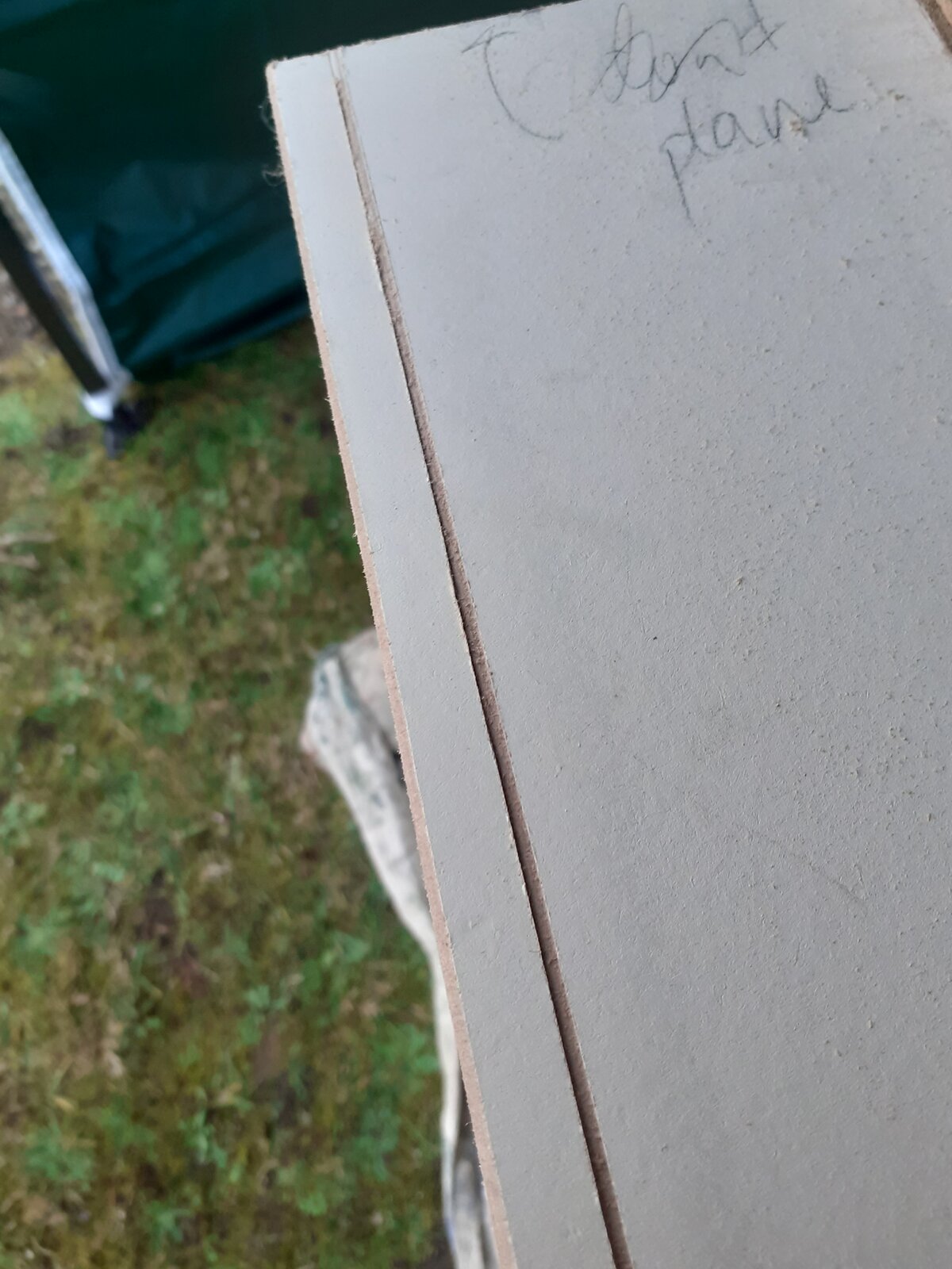

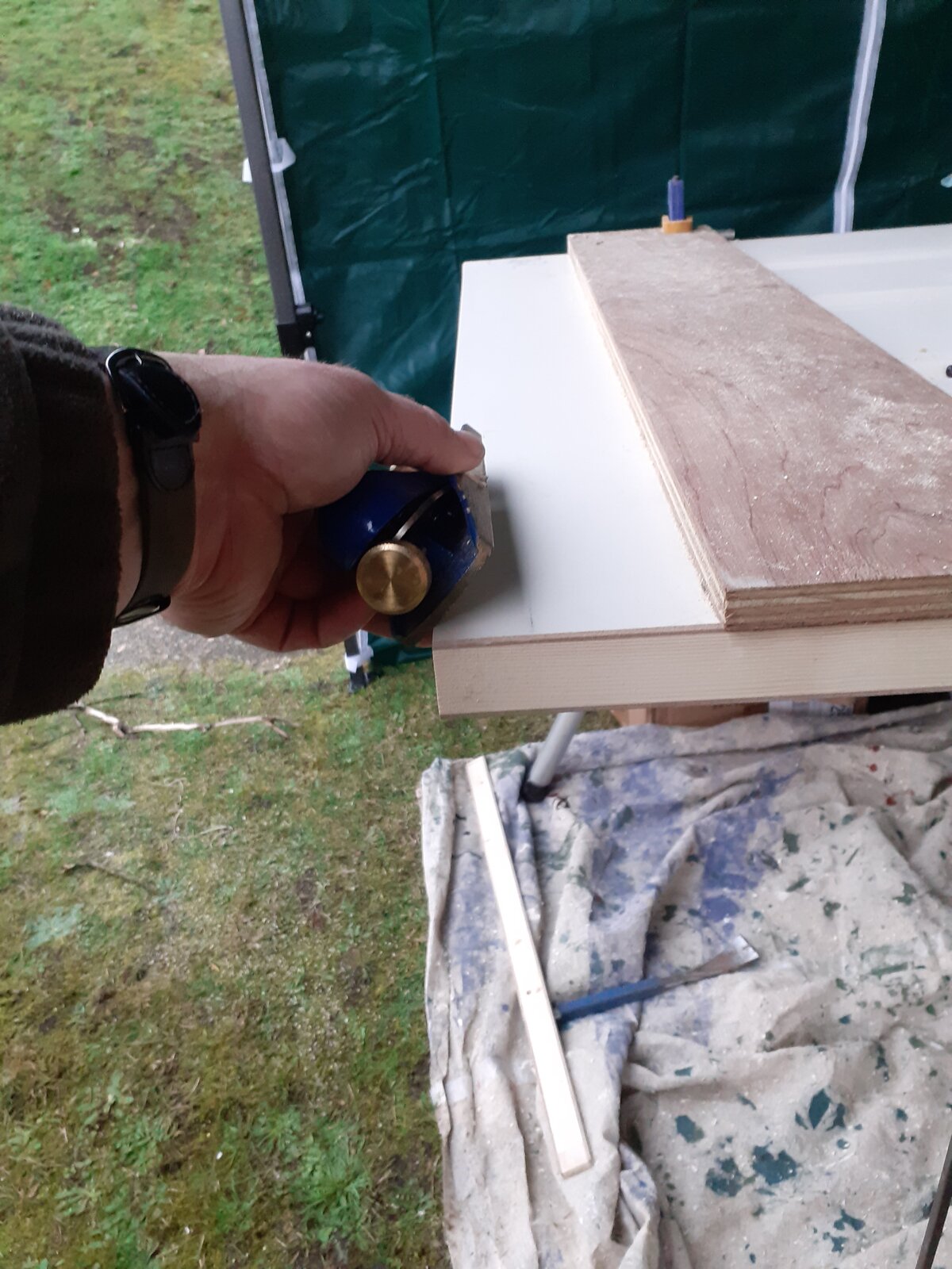

Just tried it. It worked great. The climb cut I mean. See photos. Door not painted yet though.
Regarding chamfre, I used blockpane at 45 degrees along bottom. I guess this would need painting afterwards.
Yes, but a very small chamfer isn't too noticeable. The old workarounds used to be Tippex for white doors or a Sharpie for black ones!
With regards to the mitre plane, I would recommend that you skew the blade a little (point the nose 10° or to the left as viewed in your picture) as this effectively reduces the attack angle of the blade, reducing the tendency to break out bits of veneer on veneered doors (these are normally applied to the door in vertical orientation and are more likely to tear or chip if planed straight across without a skewed blade)

10 degrees is for climb cut pulling saw backwards with 1mm depth? Out of interest if I was to score I guess you run Stanley blades left side on right side of where saw is cutting? So you have width of Stanley blade above where saw is going to cut?
