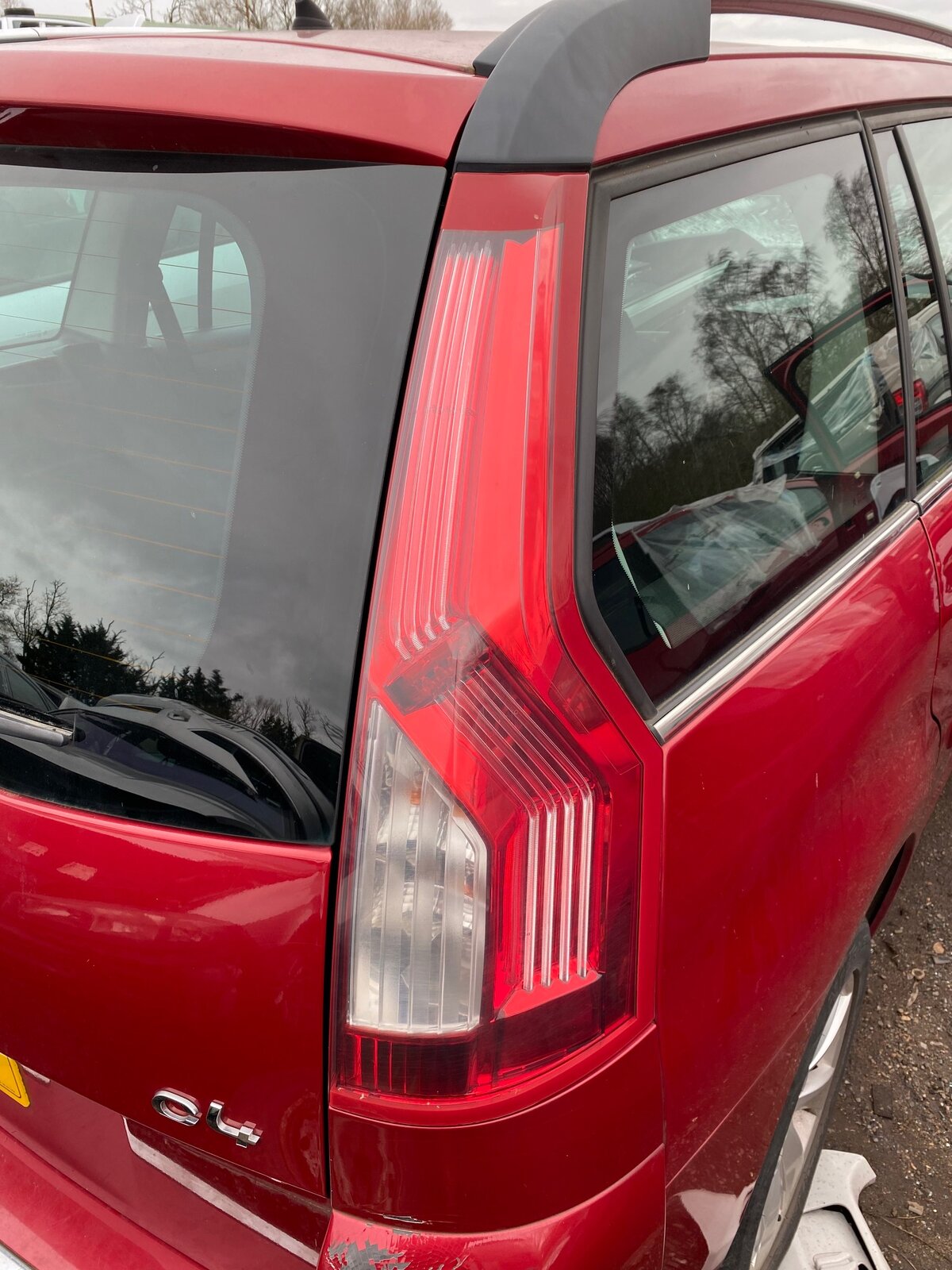

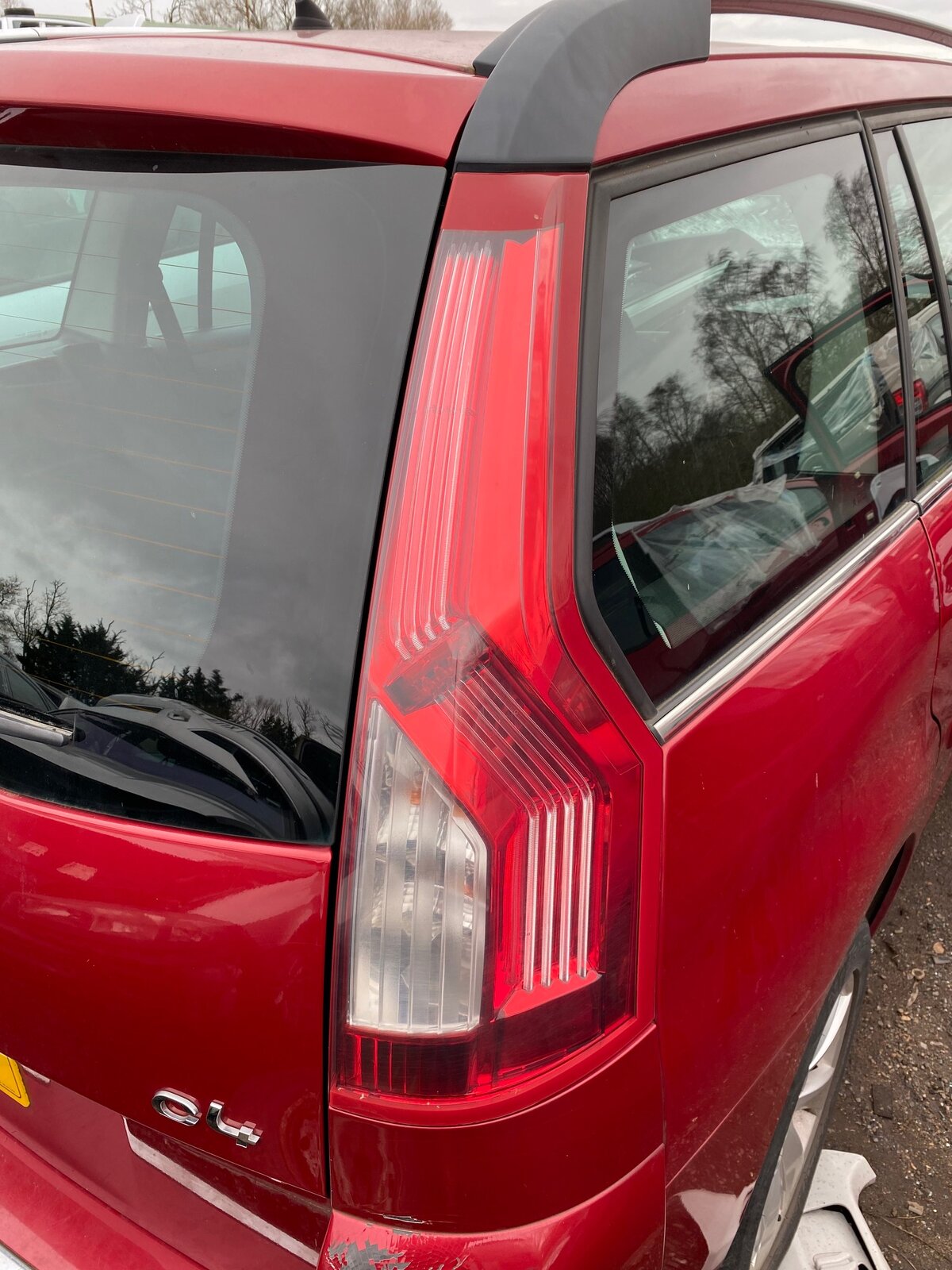

I had cracks in the rear cluster on my wifes C4 grand - and found these guys
Breakers
Feb 2020 - they took a picture of the part and sent it to me before i purchase the rear light cluster
They are in Norwich and used Parcel force for delivery - all well packed up , and perfect
Also discussed via chat/email through the 1st choice system before purchasing
I have not had good experiences of these sort of sites, findmybuilder and the like
but 1st choice spares seems to have worked out ok for me
as i say back in 2020
