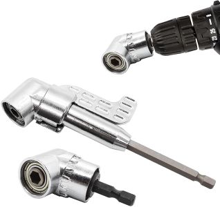

What you probably need is called an "angle drill adaptor" but you need to look for the type with a 1/4in hex drive like this one:
They are often either 90° or 105° angle (I find the 105° type a bit easier to use), but AFAIK they aren't magnetic, so you'd need to install a magnetic bit holder in the socket to hold both bit and screw. Again, commonly available

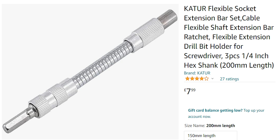

I need a magnetic extender/adapter or something that allows the bits to grab the screw, so I can use it at all angles

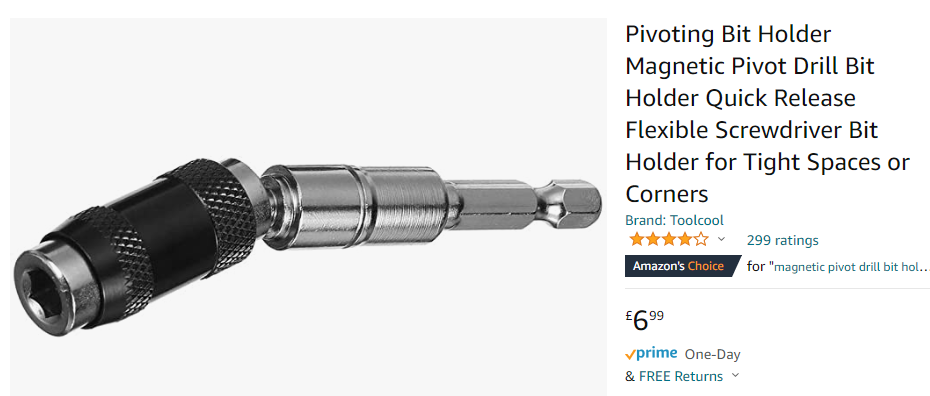

AFAIK depending on your specific needs, there may be no such thing as a single tool to do this - to hold a screw you need an appropriate bit, either in a magnetic holder or in a screw finder type sleeve holder. To get into awkward spaces (i.e. use at an angle), your bit holder needs to be held in some form of angle drive of the type that both @^woody^ and I referenced in our replies. Most often this means something like a "right angle" driver - but they are NOT magnetic and need to be used in conjunction with a magnetic bit holder. For shallower angles you can use a magnetic offset drive of this type:
which is also used in conjunction with a 1/4in hex drive bit. Never had much use for the bendy flexible type extenders - they seem to need 3 hands to use them, but I only have two!

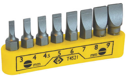

I am looking for the standard sized ones and the 4mm ones.

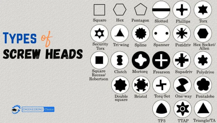

To clarify, "standard size ones" doesn't actually mean that much: There are three main types screw heads used for woodworking and metal working screws these days - Phillips (mainly on plastics and metals), Pozidrive (mainly wood, some metals) and Torx - but the most commonly used sizes are probably Ph #1, Ph #2 (Phillips no.1 and no.2), PZD #1, PZD #2 and PZD #3 (Pozi drive #1, #2 and #3), and Torx (in a variety of sizes from about Tx #12 up to Tx #30). If you were to push me the "standard size" (i.e. the most commonly used sizes) I'd have to say PZD#2 for woodwork and Ph#2 for metalwork are the most universally used. Then you say "4mm". Do you mean 4mm slotted?
To give you some idea of the range of screw heads there are there, take a look at this illustration:
In a lifetime you might just come across maybe 1/5 of those (and this is by far from a comprehensive list and doesn't include many of the security screw types!), but the most common in the UK, are slotted, Phillips, Torx, Pozidrive and hex socket/Allen. All of them come in a variety of sizes.
Most of the time a driver bit mounted in a magnetic bit holder will hold onto screws of the PH, Tx, PZD and Allen types - but the won't hold onto slotted screws - for which you need the "screw finder" I referenced in my earlier post because the sliding shield needs to be pulled up, the screw inserted, then the shield extended before screwing. This is because without that shield the screw will quickly go off centre and throw out from the bit holder. These are the type of bits I use for slotted screws, Up to about 6mm will fit inside a screw finder:
BTW a gob of grease will often hold an awkward screw which is uncooperative or non-magnetic (e.g. brass, bronze, stainless steel or plastic)

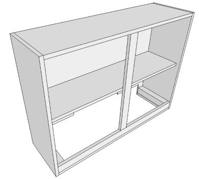

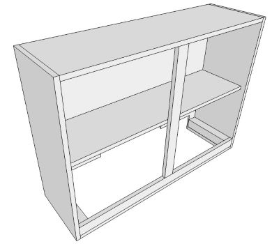

As to your projects, at least for the woodworking projects might I suggest that you download a copy of Trimble SketchUp (the non-pro version is still free) and learn the basics of that. It's a great way to visualise 3D objects and you'll find that I use it quite a bit when trying to explain the principles of different processes, like here and here (scroll down to get to the SketchUp drawings)

foxhole, this is perfect, its not an extension but an addon that allows the same thing. I just need to find one for 4mm precision screwdrivers.
