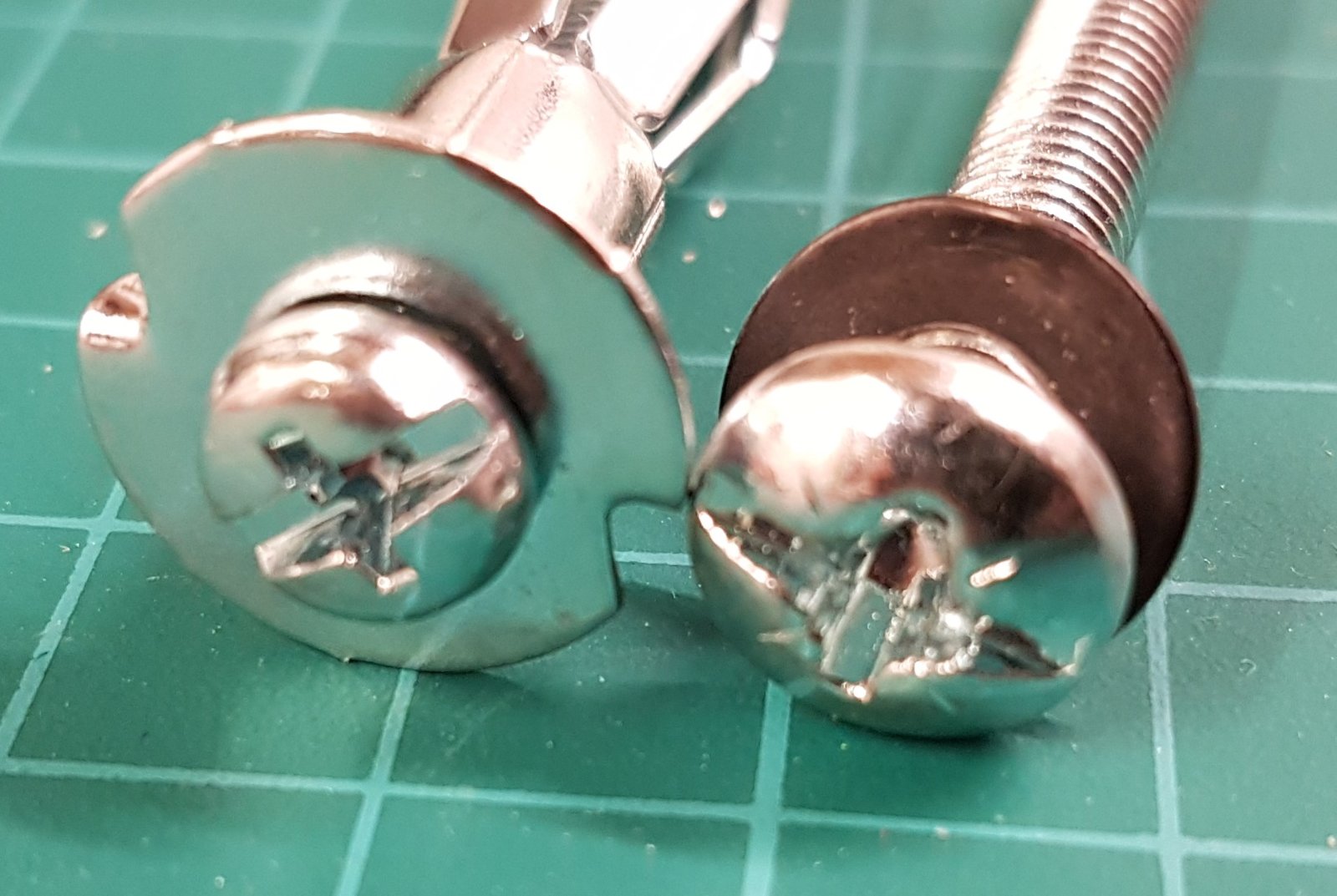

Left is a PH2/SL, and, to contradict myself from before:oops:, right is a Pozi3/Slot, although I don't think you can buy a driver for Number 3 of either PH or PZ, they're not as likely to cam out.
Boy, there is far more meat on those screw heads than on the cruddy ones I have to use, I'll try and get some pics tomorrow.
And if anyone is interested , which I admit is highly unlikely, JIS stands for japanese industry standard. Sorry was far too late for the pozi plus/minus.

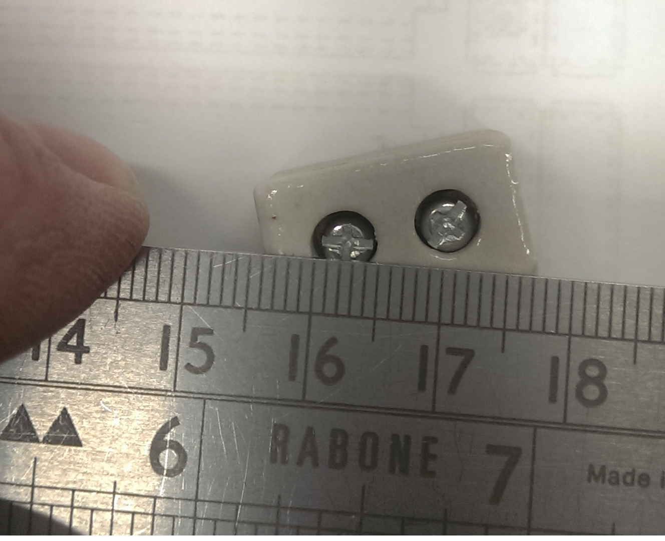

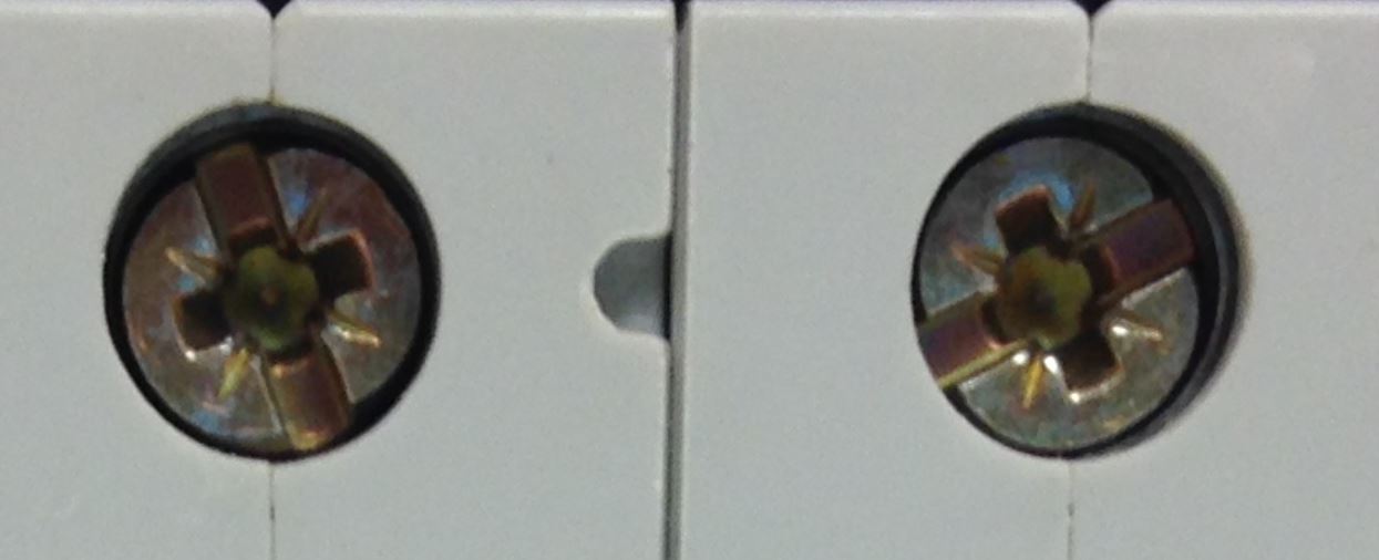

Well, I tried to take photos of the screws today.
Unfortunately some idiot has just fitted LED lighting throughout the factory and it strobes something bad when I use my phone camera lol

Your first picture is Phillips/Slotted (probably No1). You do need both types, the PZ/SL really won't fit them.
OH poo.... That's the one I really want them for as that's the bugger that killed my flat driver.
