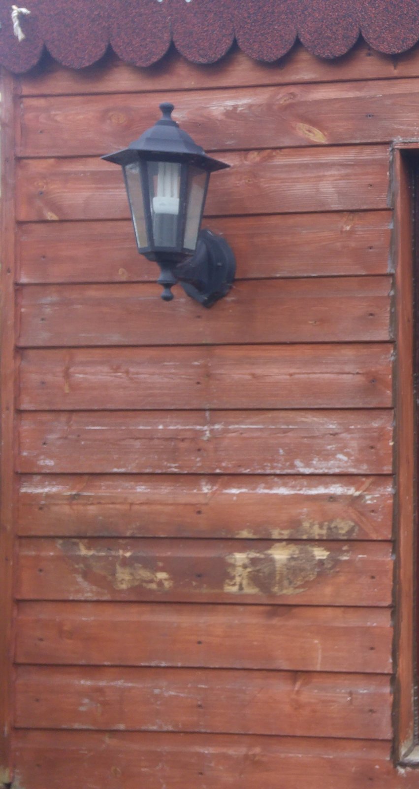

Hi to all.
About 5 years ago I built a summerhouse.
4 x 2 timber frame. 4" insulation. 6 x 2 roof joists with 6" insulation. Floor insulated. Fire retardent plasterboards. Flush toilet. Electrics and alarm. Double glazed door and window.
I like to think I made a good job of it.
I did the walls with 18mm ply, battened and covered with breathable roofing felt.
I covered that with 12mm shiplap.
I treated it each year with Cuprinol wood preserver.
2 years ago, my wife thought she'd surprise me while I was away.
She coated it with some cheap water-based stuff.
It looks bad.
So bad I've bought new 18mm shiplap.
My question is, can I just screw the new on top of the old?
My thoughts are it would be OK, but I decided it's best to ask.
Getting all the frame sealant off will be a nightmare if I remove the old boards.
Forecast is mostly sun for the next 3 days so I'm hoping to get it done.
Thanks for any advice.
John

Send a picture.
shiplap.jpg Thanks for the reply.
As you can see it's many different shades.
She didn't take all the baskets off and stained around them.
Because I was so miffed last year, not knowing what to do with the mess, I didn't treat it.
This year, the panels have started shrinking and parting.
I did use oil based Cuprinol each year until the wife came along.
It's not a case of trying to save it now, as I've got new, thicker shiplap and the oil based Cuprinol.
It's just a question of going over it or removing it first.
Going over it is the easiest option, but I'm not sure how the old stuff would react over time, if at all.

I think after two years you should remove all hanging baskets etc, and give the lot a good, even, sanding down - and treat with an oil-based stain.
Sikkens do a very good oil-based stain. It tends to stick very well. It is a two part system. The first part gives a matt finish, the second part is shinier. Just using the first part is fully acceptable, if you want a dull finish.
Or you could just carry on with the oil-based preserver you have already bought.
I can't see from your pictures anything too majorly wrong, but of course I'm not there looking at.
Is the water-based product flaking off, or has it adhered reasonably well?
Personally I think it's worth trying before you replace the wood.
Before we go into the technicalities of fitting new wood, I would say it's never a good idea to over-clad something. If any rot starts, or water finds a way in, you will have double trouble.
From a repair and replace point of view, it will be far simplier to only have one layer of wood, and I think you will regret over-boarding.
An electric sander will give you a good key to re-paint, though take it easy as if you sand too much in places you will end up with patchy spots, and you won't be happy.

Thanks for the many replies and excellent advice.
However, as I said in my original post, I've already bought the new timber (18mm this time from Homebase. Bargain.) and oil based Cuprinol.
I've gone with sparkwright's advice and removed the old cladding.
I'm glad I did because it makes the ends around edges a much neater job.
Thanks to all once again.
