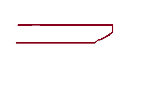

Also if the variance of the front edges is only a few mm then I would be inclined to plane them even - if the boards are at all waney you could just plane the top 10-15mm to give you an even tread but still have shape when looking (see pic)?
