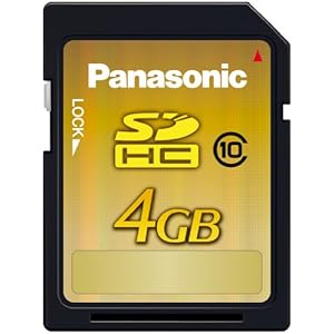

SD cards are graded I normally used class 2 but for use with video one would likely need a class 6. My camera slows up after about 10 shots while it catches up writing to the card. With a class 4 I would not have this problem. It is likely the higher classed cards use more power!
Out of interest the class is a number in a C my older cards are unmarked wonder what is written on your card?
The following are the ratings of some currently available cards:
* Class 2: 16 Mbit/s (2 MB/s)
* Class 4: 32 Mbit/s (4 MB/s)
* Class 6: 48 Mbit/s (6 MB/s)
* Class 10: 80 Mbit/s (10 MB/s)
See here for more about Secure Digital cards. Example of Class 10 card.
