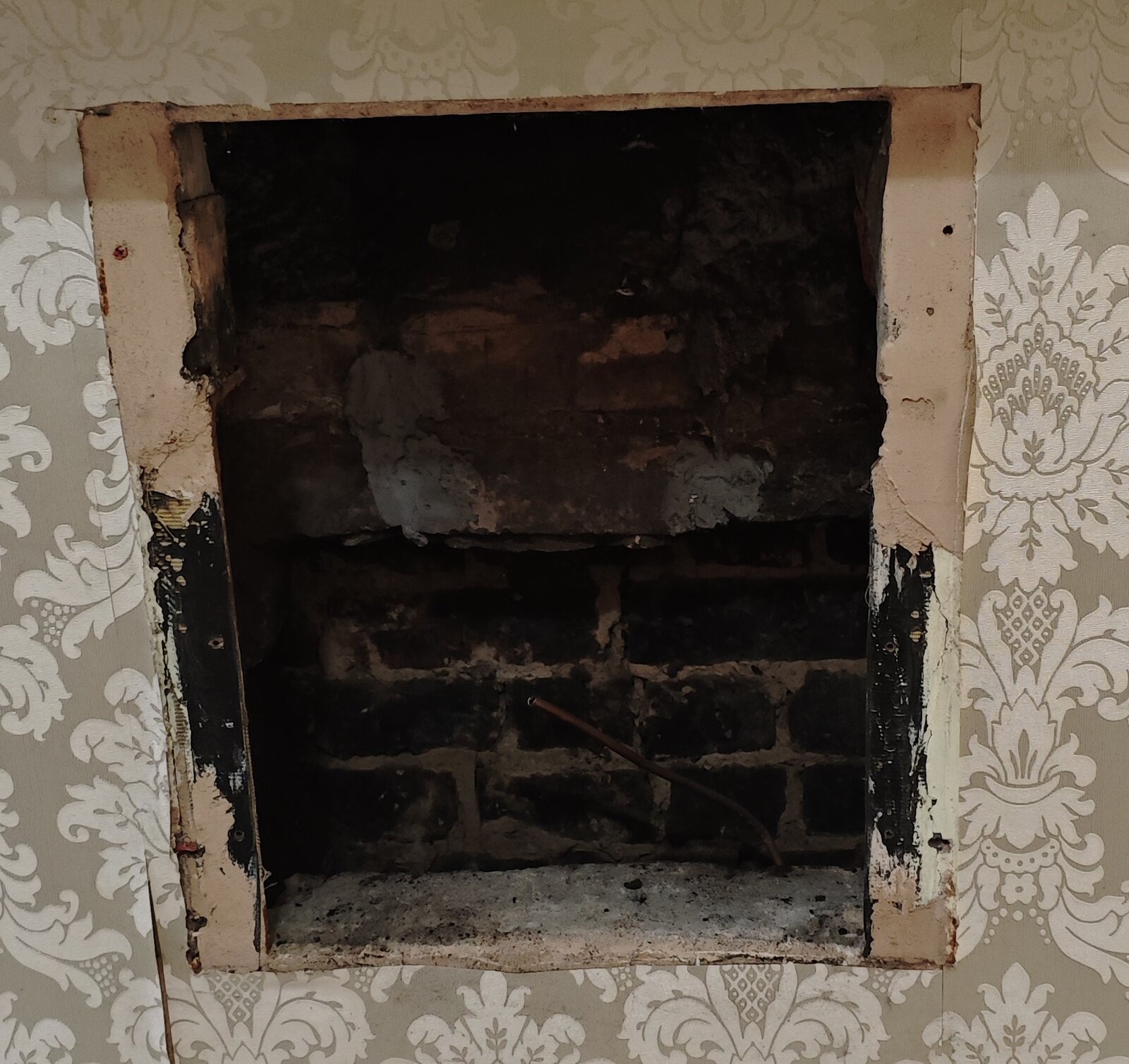

Gas fire has been removed, instead of bricking it up as it maybe reinstated in the future.
What could I use to seal the opening without causing damp, ventilation issues etc with the chimney breast.
Pic attached

Thermalite blocks with sand and cement.
Cut easy with an old saw.
Fit a vent in the front to allow air to flow through or you will get condensation.
Plaster over smooth.
Easy to knock out if you wanted to

It'll stick out like a sore thumb, as I don't have any spare wallpaper either.
Any other alternative options? I was thinking MDF with a vent or something to cover the opening...
Do that then. Not sure how you are going to make tidy. Just emulsion the MDF I guess.
