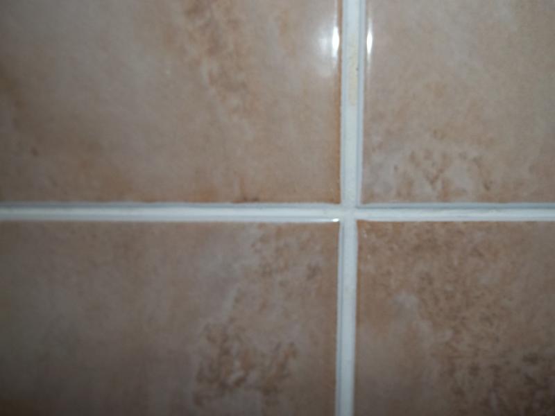

Can anyone tell me if it's necessary to seal the grout in a shower? My ensuite bathroom is 13 years old and I don't think the grout has ever been sealed but I recently came across discussions on the internet about sealing the grout every year or so to prevent the possibility of water penetration. Didn't know if it was worth buying some grout sealer to do this or not.

Post up a picture. And please ignore the previous answers, which might be misplaced due to him not noting the tiles are in a shower and so will be non porous ceramics.

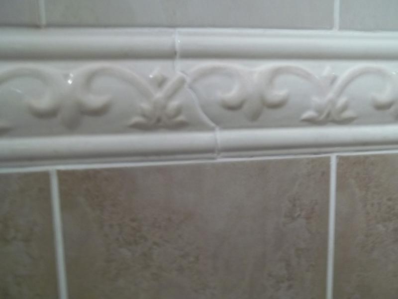

The grout doesn't seem soft or flaky.
A few months ago I went over the existing grout with some ready made grout just to hide discolouration (I know this probably wasn't the best idea)- some of the new stuff has flaked off a bit but original seems fine.
Here are some pics

The surface of most ceramic and porcelain tile does not need to be sealed, although some require a light application of a penetrating sealer to fill the micro pores on the surface of the tile. However, the grout joint between the tiles is usually very porous and generally made of a cement-based material and should be sealed.
In the original post there's no mention to flaky grout. I agree that if the grout is flaky it should be replaced. I would also say that this could be a perfect opportunity to remodel the bathroom depending on budget.
