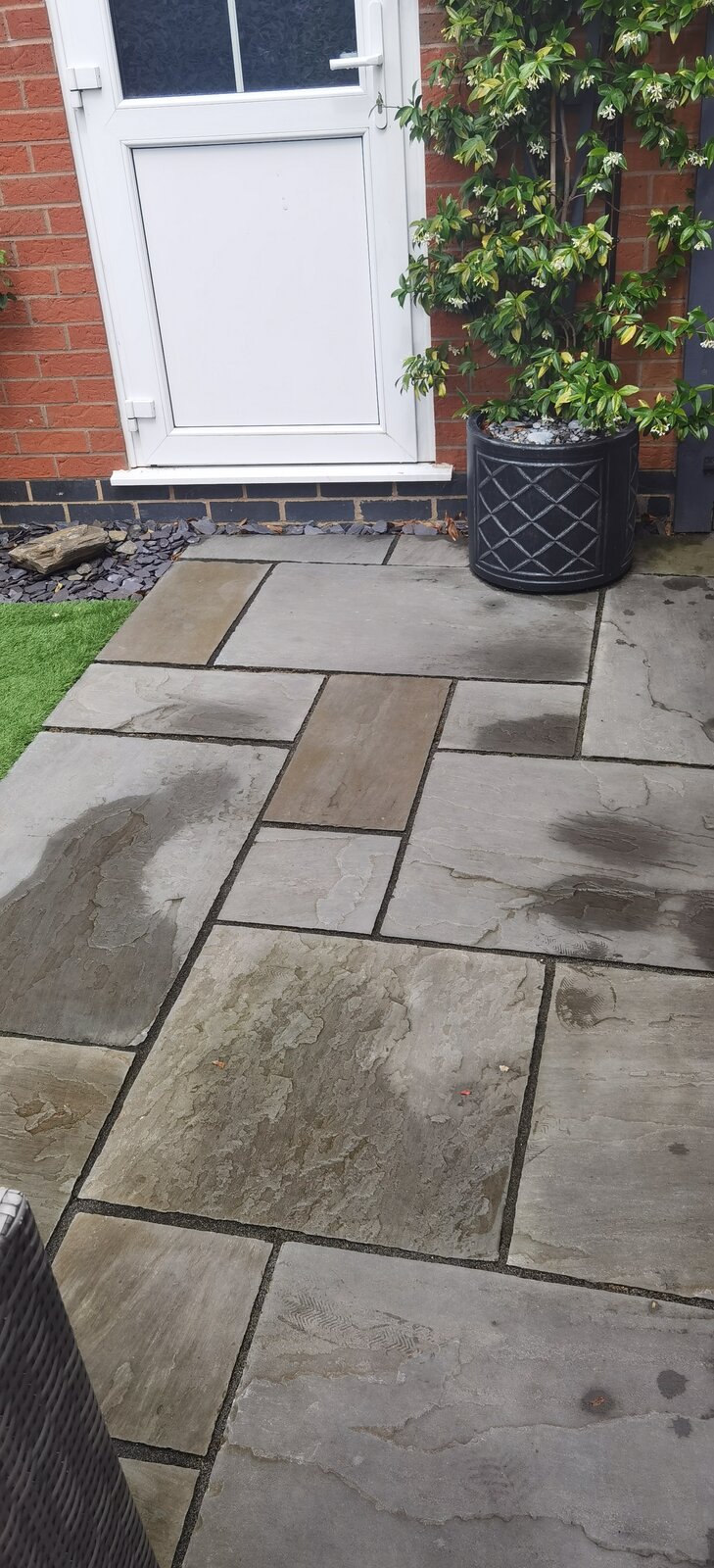

Hi, wondering if anyone could recommend a good Indian sandstone sealer,wet look if possible?
I'm planning to clean the slabs first with diluted Bac 50 and then want to seal them,as everytime I jet wash it seems to be blowing out the easy joint.
Resiblock anytime.... it's a bit expensive but does the job damn well. I had my new patio done with indian raj blend natural stone. Sealed it with resiblock and never had to worry aboit joints coming out or weeds between the joints. Its the money well spent. I re coat it once every 5 years and the patio looks as good as how they were laid 12 years ago.
