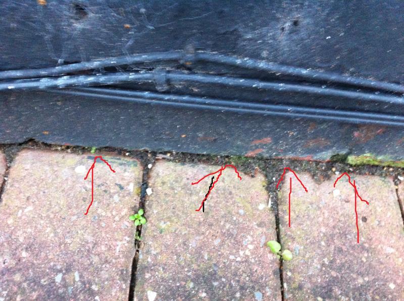

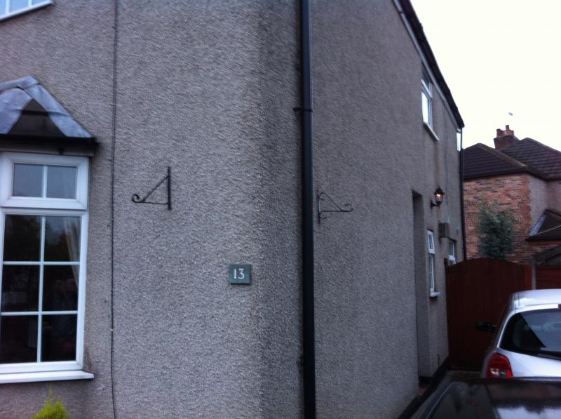

I've been having some issues with damp on some walls in my house. I like in a 1920's semi with no cavity and render over the bricks that has been pebbledashed. I have a channel along the west side of the house. This is the side that gets battered with rain generally.
The channel was full of a lot of dirt and stones so I have now cleared this out. I am also going to fit an extension to one of my downspouts on the front of the house as currently this just goes onto the paved driveway that runs in front of the house and goes right up to the house. I'll channel this water away to the garden for drainage.

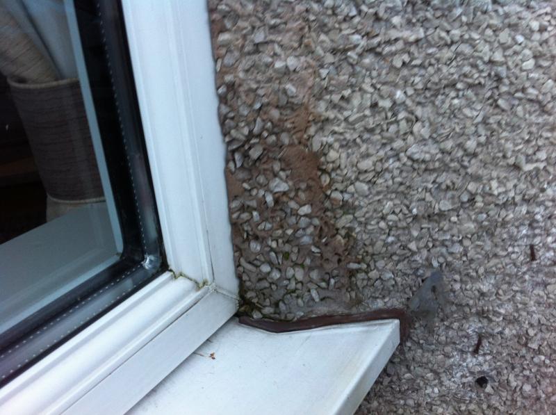

I had 3 damp men come out. The first 2 just recommended a DPC after stabbing the meter into the wall on a few walls. The third guy who came out that charged £50 actually looked right round the house and identified the blocked channel at the side of the house, the downspout that goes nowhere on the front of the house and some small cracks in the rendering where damp may be penetrating.

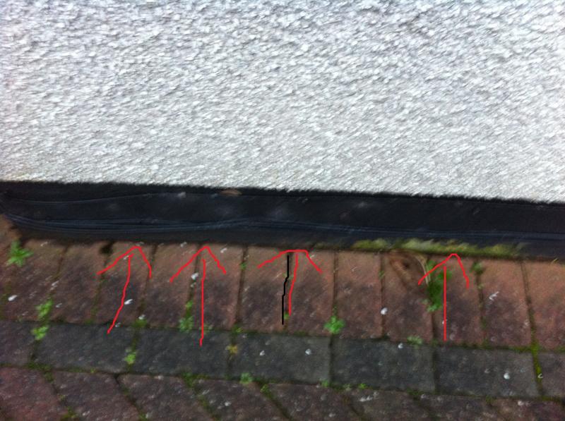

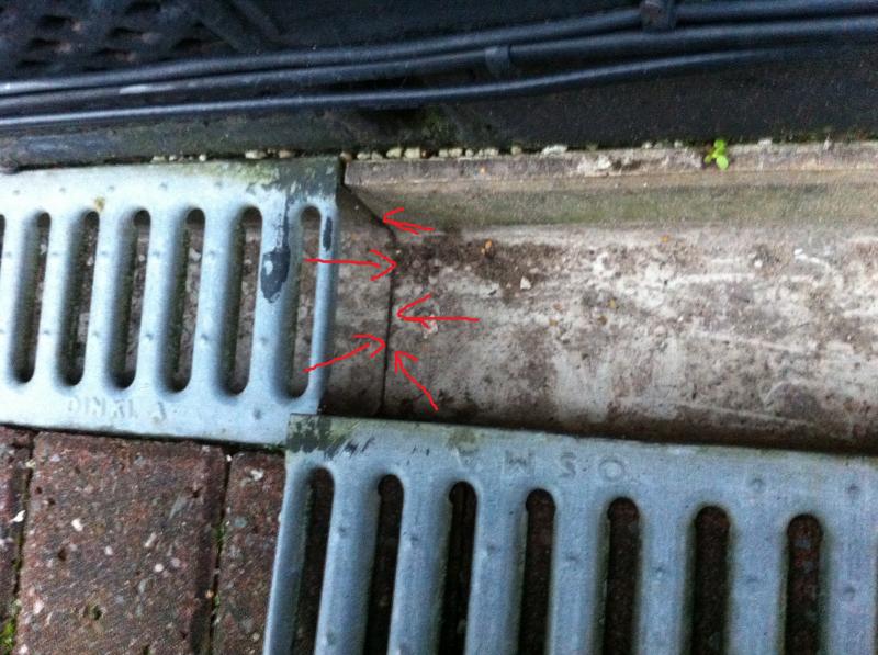

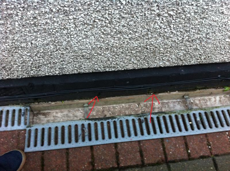

He also pointed out that the bricks that go up to the house and the channel so not seal right onto the bottom bricks of the house as there is a small gap. He recommended dealing these. I've attached some pics as he also said we need to make sure that the channel is fully sealed and water does not leak though it.
Out plastic guttering is all fine and none of the air bricks are blocked. I know we might need a DPC but i'd like to try fixing the little things first and giving it a month or 2 to see if it helps any.
The pics show how the bricks or channel do not sit totally flush to the house. I've crudely drawn where he says it needs sealing. Should I just whack some exterior silicone in these gaps?

You are not really going to solve anything by bunging silicone into those gaps. They don't look that serious and there is plenty of other opportunities for water to get between bricks with joints that run up to the house.
If it were me I would clean out the gaps as best I can and as deep as possible. Then brush a dry sand and cement mix into the gap. It will set soon after getting damp. It will be more of a tidying job than barrier to water. Use a fine sand if you find building sand is too course.
