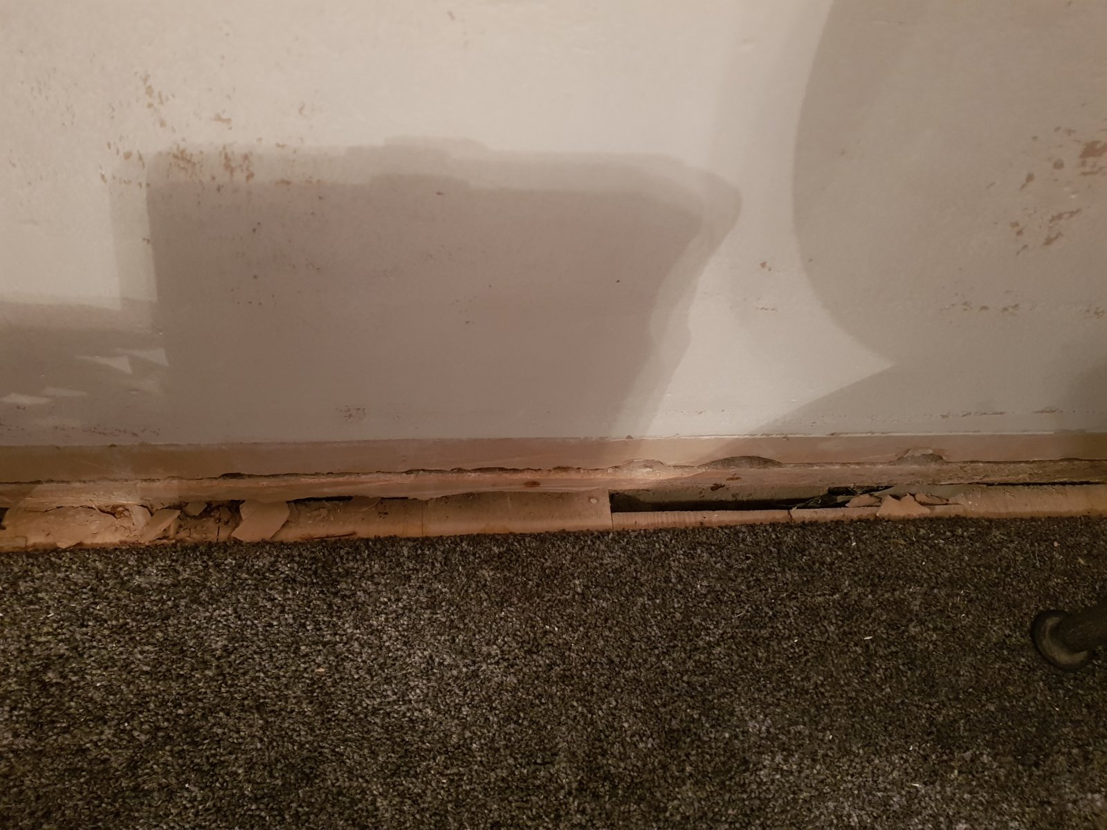

This is the edge of my room.
So I'm thinking that if the skirting isn't exactly flush on top of the floor then there will be a gap which could allow a draft in or allow any spillage to flow in.
I don't want to run a bead of silicone between skirting and floor.
I was considering a self-adhesive rubber P Strip. 3-5mm gap seal.

Yeah I would just put some of that adhesive foam draught strip (normally for doors) along the bottom of the skirting before pressing it down onto the floor and fixing to the wall.
Interesting lateral thining Gerry, but it'll never compress completely. Looking at that wall, I'd be inclined to hack off the damaged plaster, and rebond the lower section, and maybe squirt some expanding foam into the floorboard gaps first.
Umm... that's kinda the point? It fills the variable gap. If you want a really super-thin gap (why?) then use some thinner foam, like 3mm underlay cut into strips.
All the skirting is finished. Decided not to use the draught strip as when I was measuring up and laying the skirting it was mostly flat with only a few areas needing filled.
I think the draught strip would have made the gap far to noticeable. The 5mm underlay I used allowed me to cover most of the gaps around the floorboards and still leave an expansion gap.
Between this and the skirting, plus a bead of flexible sealant I should not have any gaps for draughts to get in.
