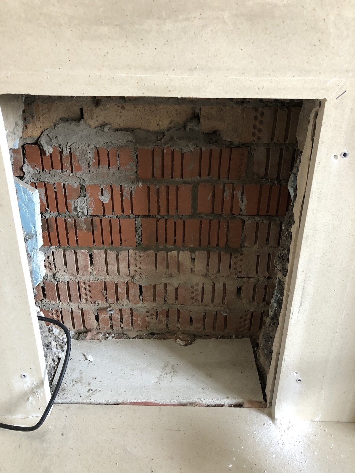

Morning all.
I have a hole in the living room where a electric fire is fitted. It’s been drafty for some time a I decided to investigate why
Basically when the house was built they have cut a hole in the breeze block and not sealed it up.
They have instead left plasterboard as a finisher but not sealed it
My question is. For the gaps between the outer brick and the breeze can I fill this with fire rated expanding foam to prevent the draft and then reinstate the plasterboard and seal this around the edges
For the rear back of the wall (that meets the outside. Can this be covered in expanding foam to insulate or should I use something else?

Can you post pics showing the whole of the chimney breast in the room and a pic showing the chimney breast area on the outside wall?
Well it’s not a chimney breast. It’s more a hole knocked in the wall
It’s a modern house. So it’s outer brick / cavity wall with insulation / breeze block then dot and dab with plasterboard.
I think when the house was built they just hacked a very crude hole in the breeze to install a gas fire and fan flue. This was removed before we bought the house. But looking at other like houses around here the house builders installed fan flues on the outside of the brick.

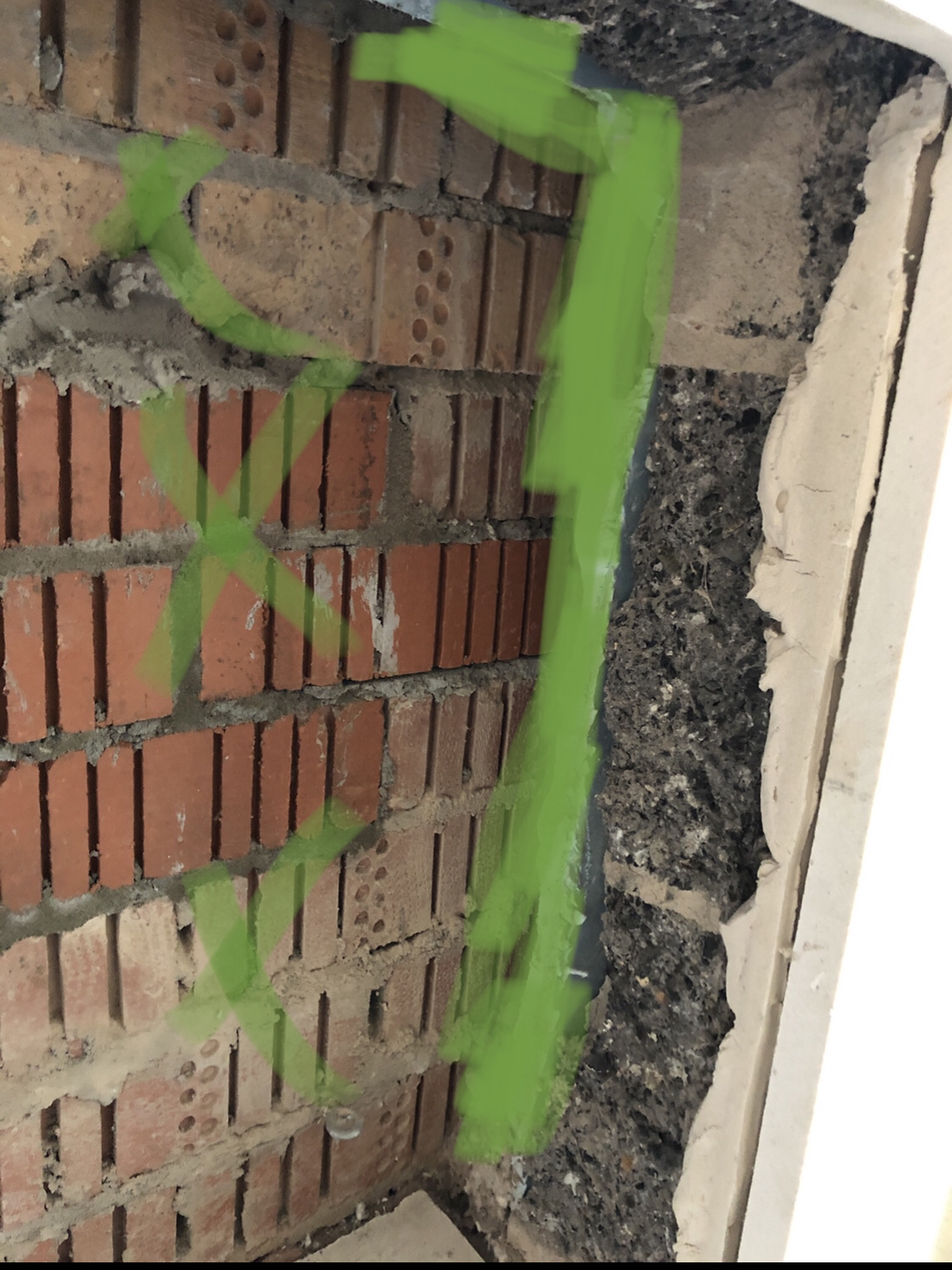

The gap in green is the bit I want to seal off. And also add some insulation to the back brick. As this is a standard brick depth before it hits the outside.

You have cavity insulation showing on the two sides and top?
Simply use the same kind of insulation as required, & then fill the opening with block and D&D.
There's no need to vent.

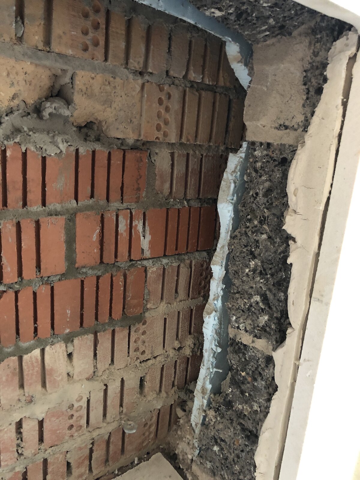

Your type of CWI isn't supposed to fill the cavity, it leaves a narrow cavity gap which is how it should be with that kind of CWI - best not to attempt to fill that narrow gap.
You can see the remains of a couple of cavity ties on the back wall

The fumes went out a flue that was in the wall. It was removed before we moved into the house. You can see the differnt coloured orange bricks. This is where it was.
An electric fire was then just placed into this hole and the back (what you see in the images) left as is. This basically funnels cold air intro the house from the air gap. Ideally I want to seal the sides and top off so this is not a full on gap and draft to the outer wall of the house.
I can't brick this up fully. I.E re instate the breeze block as the electric fire sits back into this gap and would foul the breeze Block.
OK, then using say Celotex GA 4000 insulation, cut pieces to box in sides, top and back wall - use foam to glue & seal the insulation in place.
Decorate as you please, and no venting needed.
