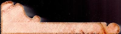

I'm searching for an architrave profile to match the ones in my 1820s flat. I've almost given up on finding anything :( but thought I would ask the gurus here as a last resort ;).
I hopefully have attached a couple of images (this is my first post ;) that show the profile. My architraves are built of two pieces of wood, a planed piece of softwood that has a corner beed, and attached onto this is the ogee moulding, which is taller than most ogee profiles you see in the common places.
Image 1: Profile Detail
Image 2: Full architrave
Obviously, making up the corner bead piece is easy, but I can't find either a router bit OR off the shelf moulding for the ogee moulding.
Any ideas?
You probably won't get this from anywhere, you will need to get it run out specially at a timber merchants or a joiner either way you wiil be looking at £60 and upwards to get the cutters made to replicate the moulding, sorry.
Thanks for the response chirpychippy, I did suspect as much. Luckily (well, I guess I would be more lucky to not need any at all) I do need about 45m not just a metre of two!
