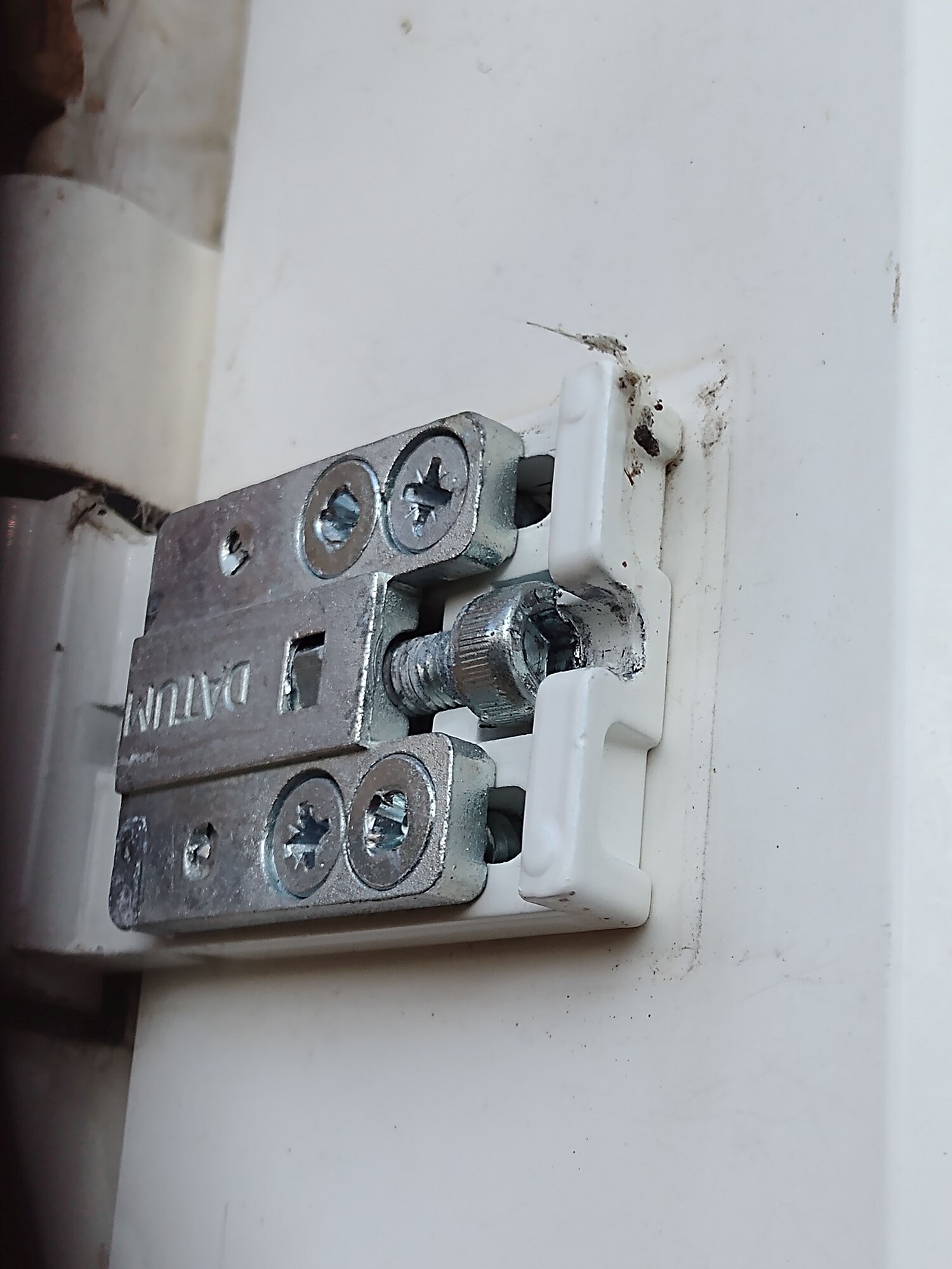

Hi
The second door (not the locking door) of my UPVC patio (french) door is jammed. They are hinged doors.
I can open the main door easily and lock it up. Thought of opening both doors for the summer but find that second door is jammed.
I can feel something hard hitting at the bottom (maybe it's the bit to prevent draft) . I wonder if it is due to the hinges being lose. Do I need to tighten both upper and lower hinges with an allen key or is there a particular system or method to it. Do I need someone to try and lift the door up while tightening the hinge? When do I know I've tightened enough and it needs a specialist or something?
Or have I got it completely wrong ? Can anyone with experience advise me?
Thanks :)
The 'slave' door - the second door as opposed to the 'master' door has probably settled and dropped, very common with doors and is probably rubbing across a frame keep plate for the shootbolt, maybe even the shootbolt isn't retracting at all or enough? The correct way to do this is to 'toe and heel' the door which involves repacking the glass within the door, using the glass to support the door but unless you have the means its probably bext left to a double glazing service enginner. You can cheat though and try and get it with hinge adjustments but that really depends on the type of hinges you have, would need some pics to advise on this though
The 'slave' door - the second door as opposed to the 'master' door has probably settled and dropped, very common with doors and is probably rubbing across a frame keep plate for the shootbolt, maybe even the shootboto support the door but unless you have the means its probably bext left to a double glazing service enginner. You can cheat though and try and get it with hinge adjustments but that really depends on the type of hinges you have, would need some pics to advise on this though

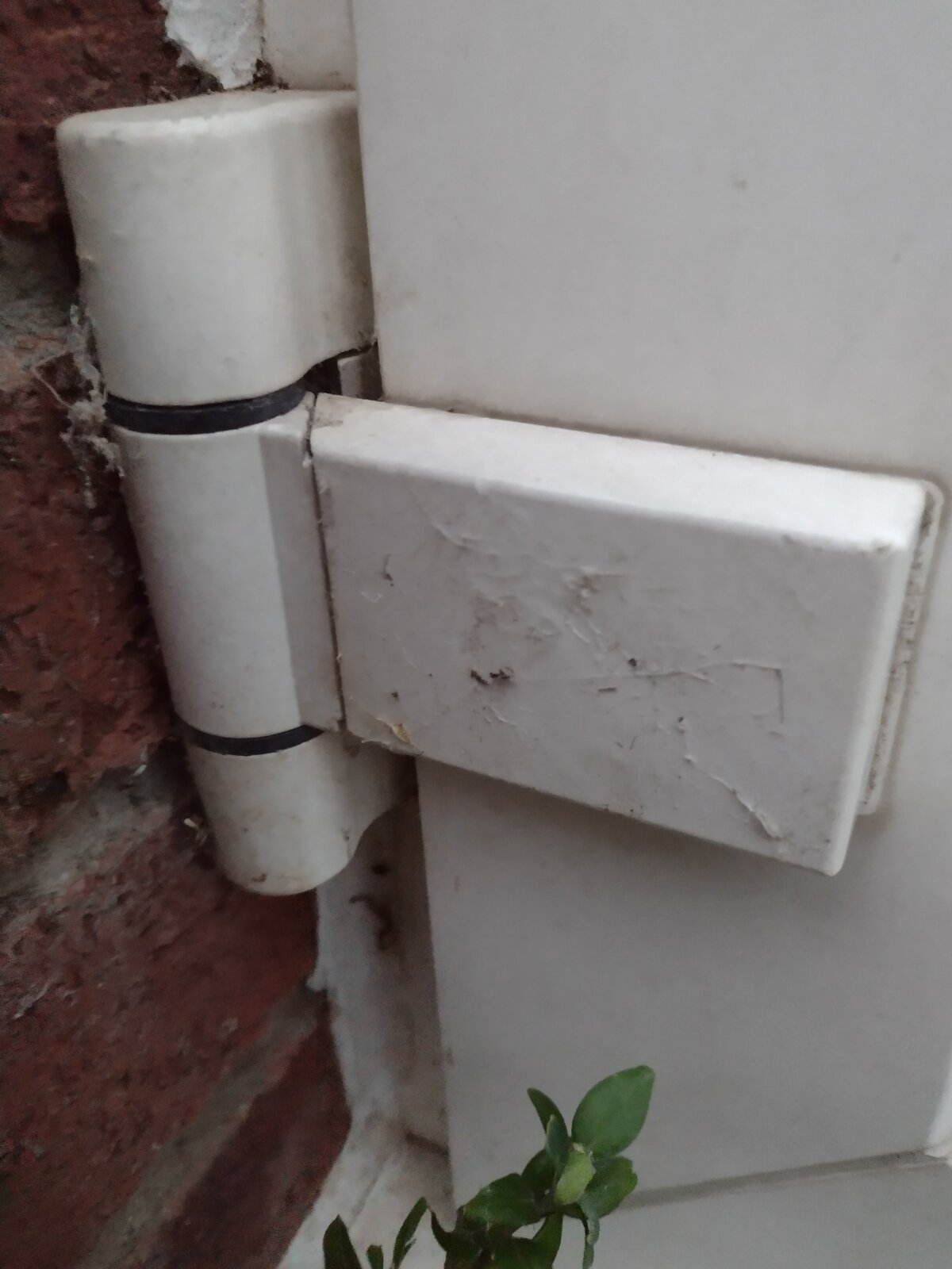

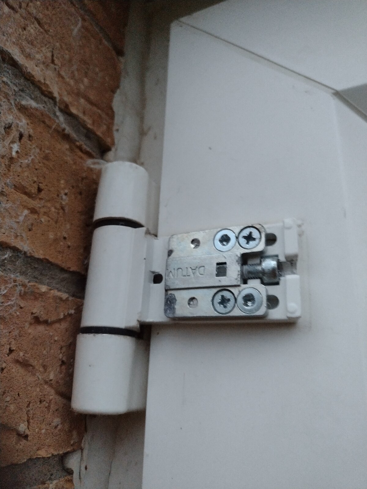

Apologies for not posting pics. Just came back from work and I've got some pics.
The fourth pic shows the door partly open, Third pic shows the same in close-up(unlocked of course), second pic shows the part that is getting jammed (black arrow) and the first pic shows the upper door hinge which allows an allen key adjustment.
Hope this helps a bit! :)

Is the first picture of the hinge upsidedown?
Take a picture of the whole hinge include the part that is on the frame
Hi,
Nope. They aren't upside down.
The upper hinge without the cover and the lower hinge. Are the pics good ?
