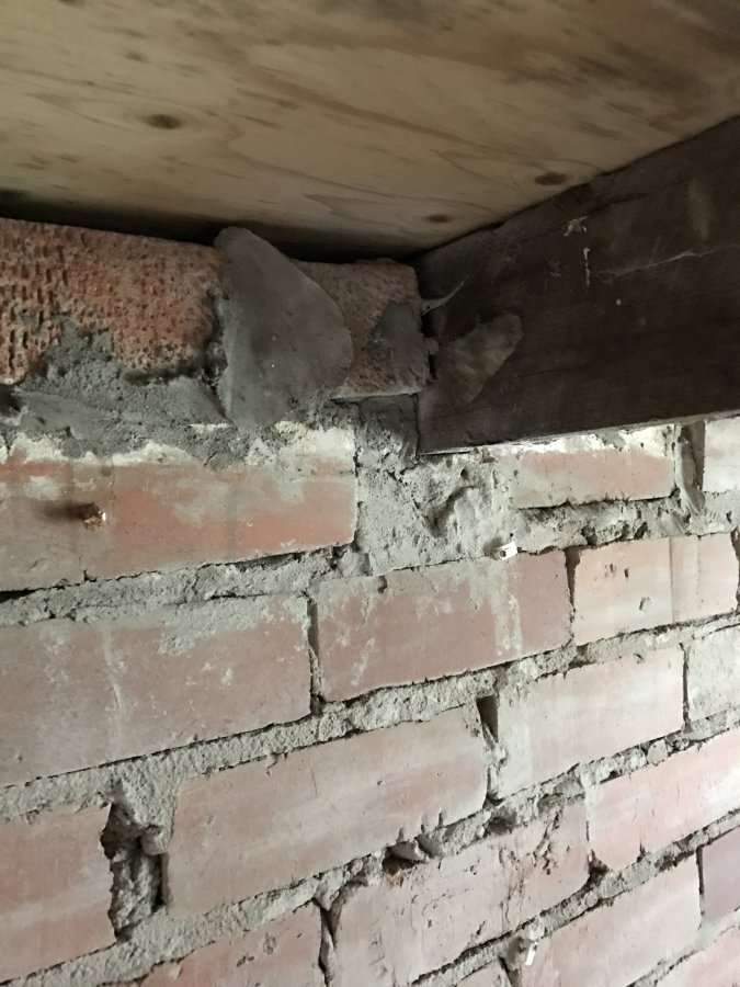

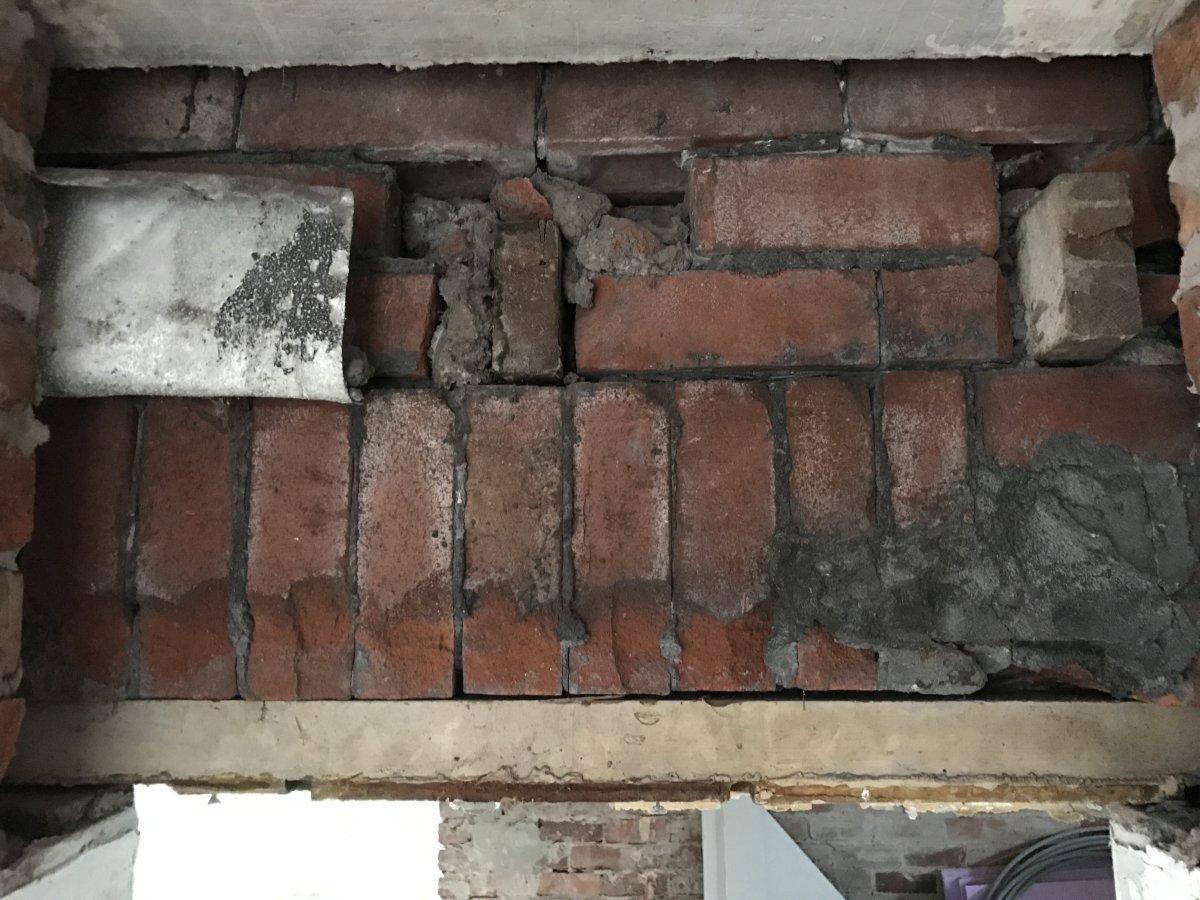

These are the ones I pulled out:
Rough as ****!!

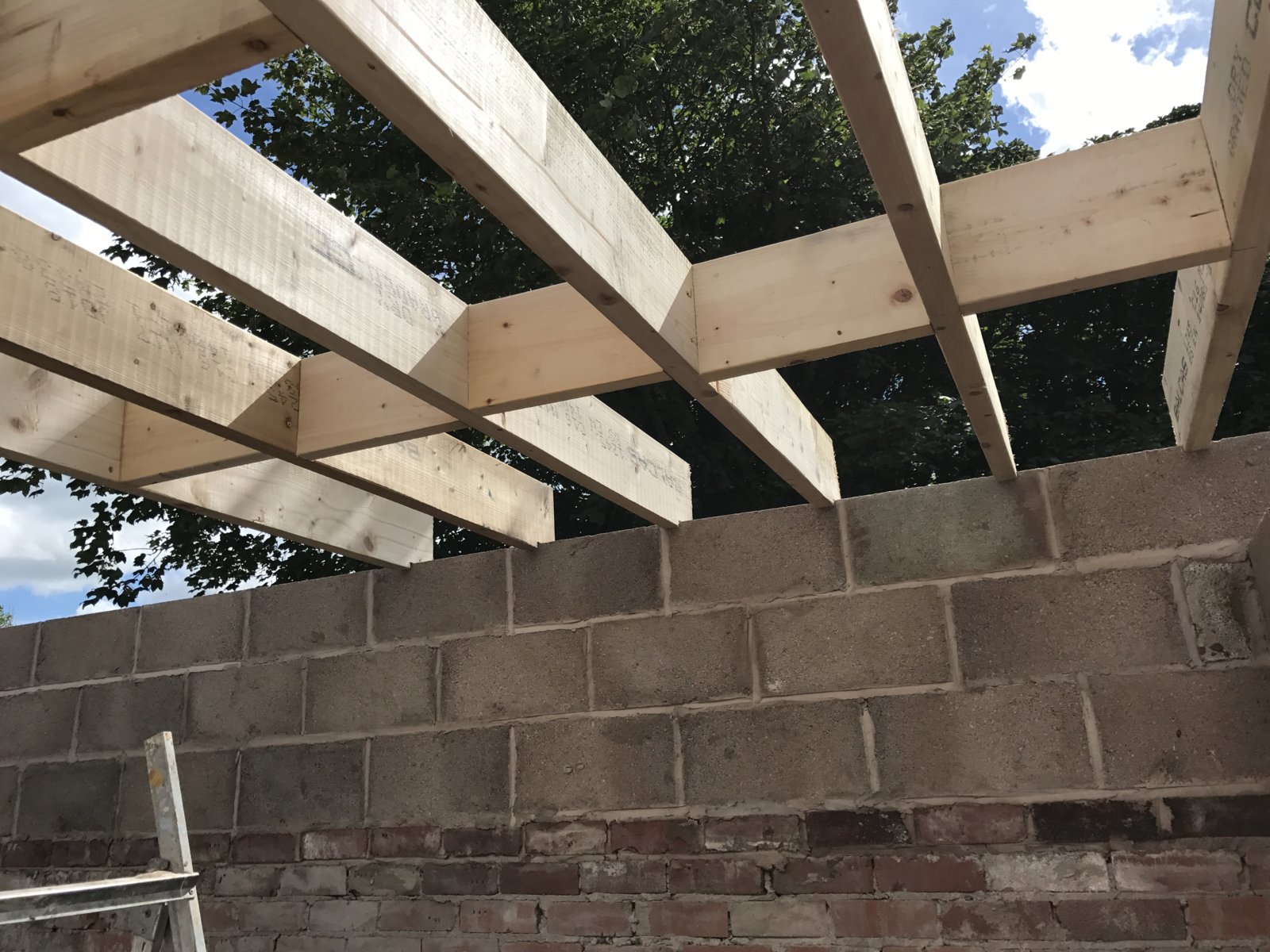

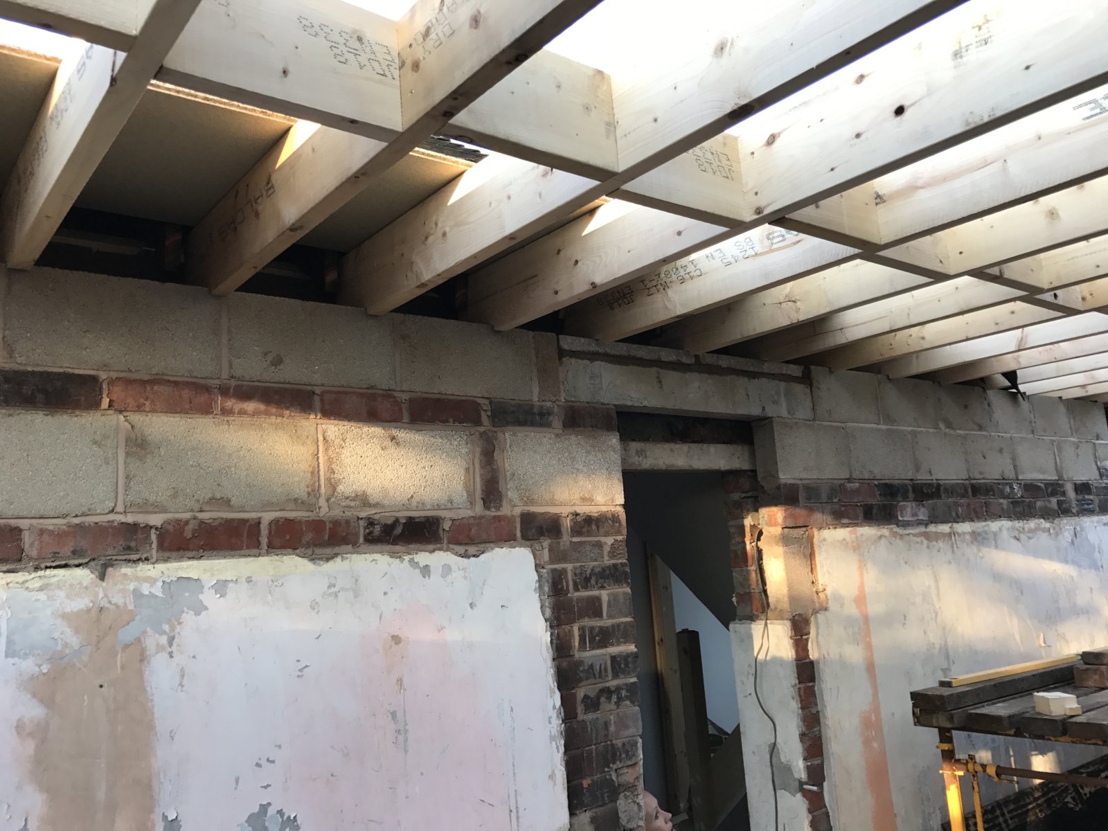

Here are the new joist that I'm talking about:
I'm going to block up between them but should I add any other support?
What I was thinking was along the lines of strapping every 3rd or 4th joist with one of those twisted straps or the angled ones same as you would strap your wall plate
The chances of your floor flying off are the same as an emu's.
I don't think it's a case of the floor flying off, more one of the floor providing lateral restraint to the wall.
IIRC, Part A doesn't require any straps where the joists run into the wall, provided the joists are no more than 1.2m apart, which they obviously are here.
That's right Tony, every time I work near a wall I expect it to fall over. I'll get it blocked up between them ASAP. Thanks :)
In the OP's previous posts he is aware of lateral restraint, and talks of strapping the joists down "same as you would strap your wall plate" - which is to prevent them flying off, and something he does not need to do.
