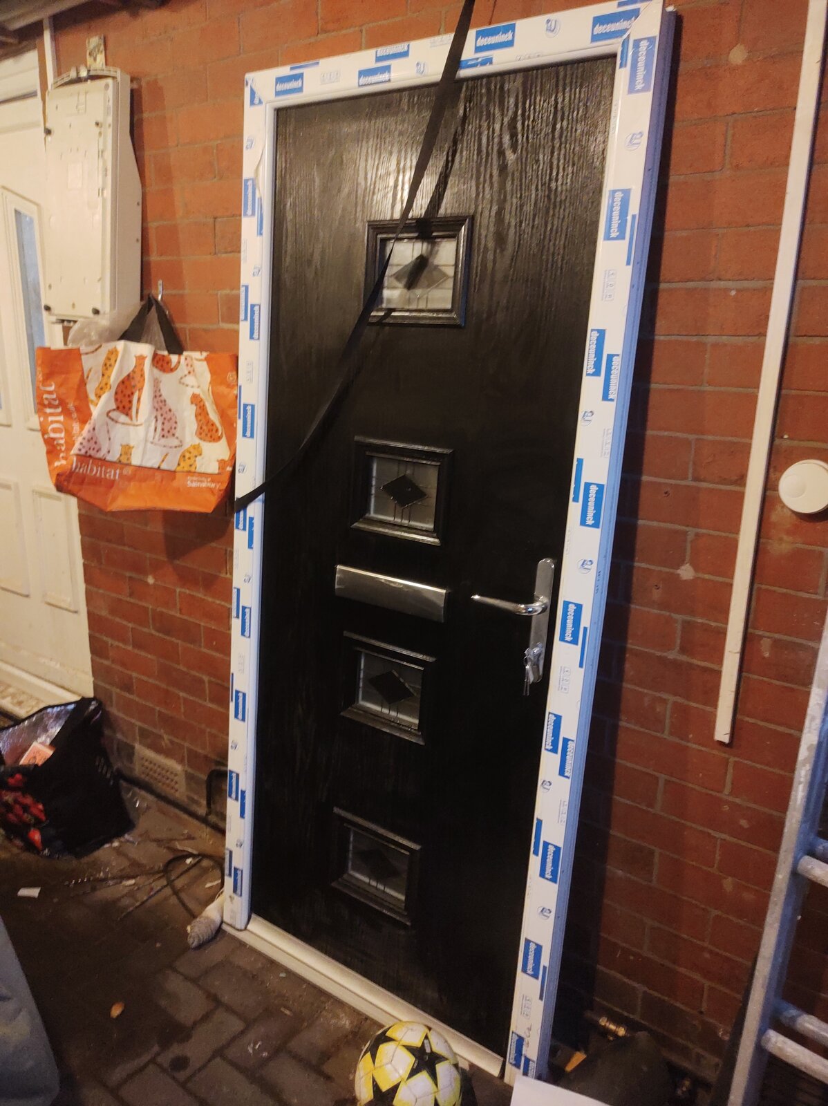

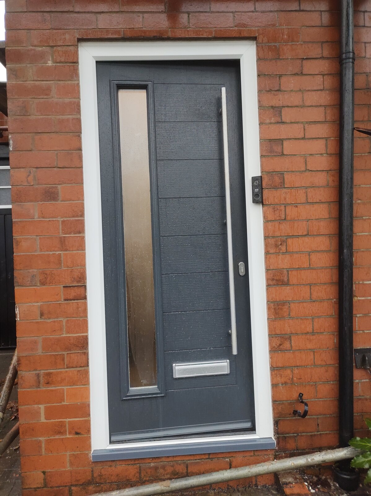

I bought a nice miss-measure for our porch:
Unfortunately my wife decided she didn't like it and want one with a big handle on it!
Fortunately I managed to find another near perfect size miss-measure (you'll generally find them on eBay not faceache) just had to pack up and shave the frame down a tiny bit.
