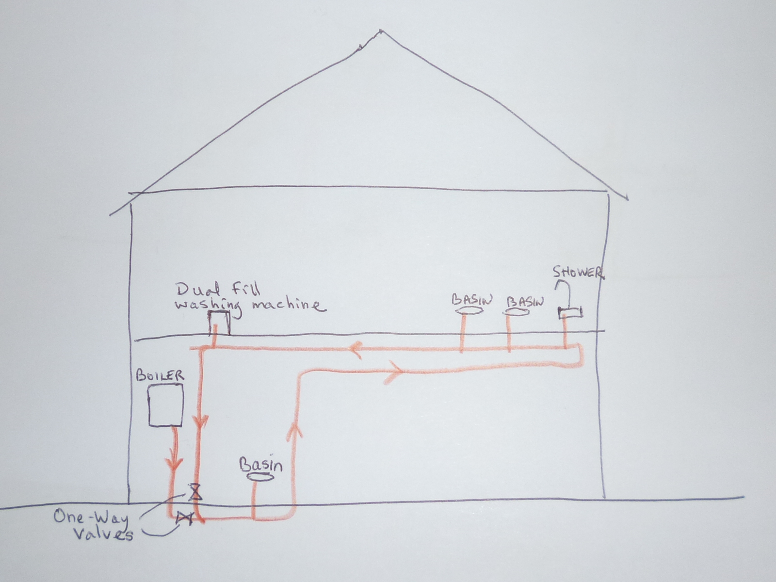

So, instead I'm now wondering whether it's possible to install a secondary DHW loop on a combi to fix the latency problem. Can it be done and if so, how?

If I understand the question, you are wondering about keeping a pumped loop of mains pressure water constantly heated by the boiler so that hot water is pretty much instantly available at the taps?
One problem (among others) with this is that as soon as hot water is drawn off, it needs to be replenished quickly with more hot water, and as you say, with combis (or any boiler) there will be a delay.
Yes, I would like hot water pretty much instantly available at the taps. I was thinking a schematic something like in the attached diagram below. Can the circulation run in convection?

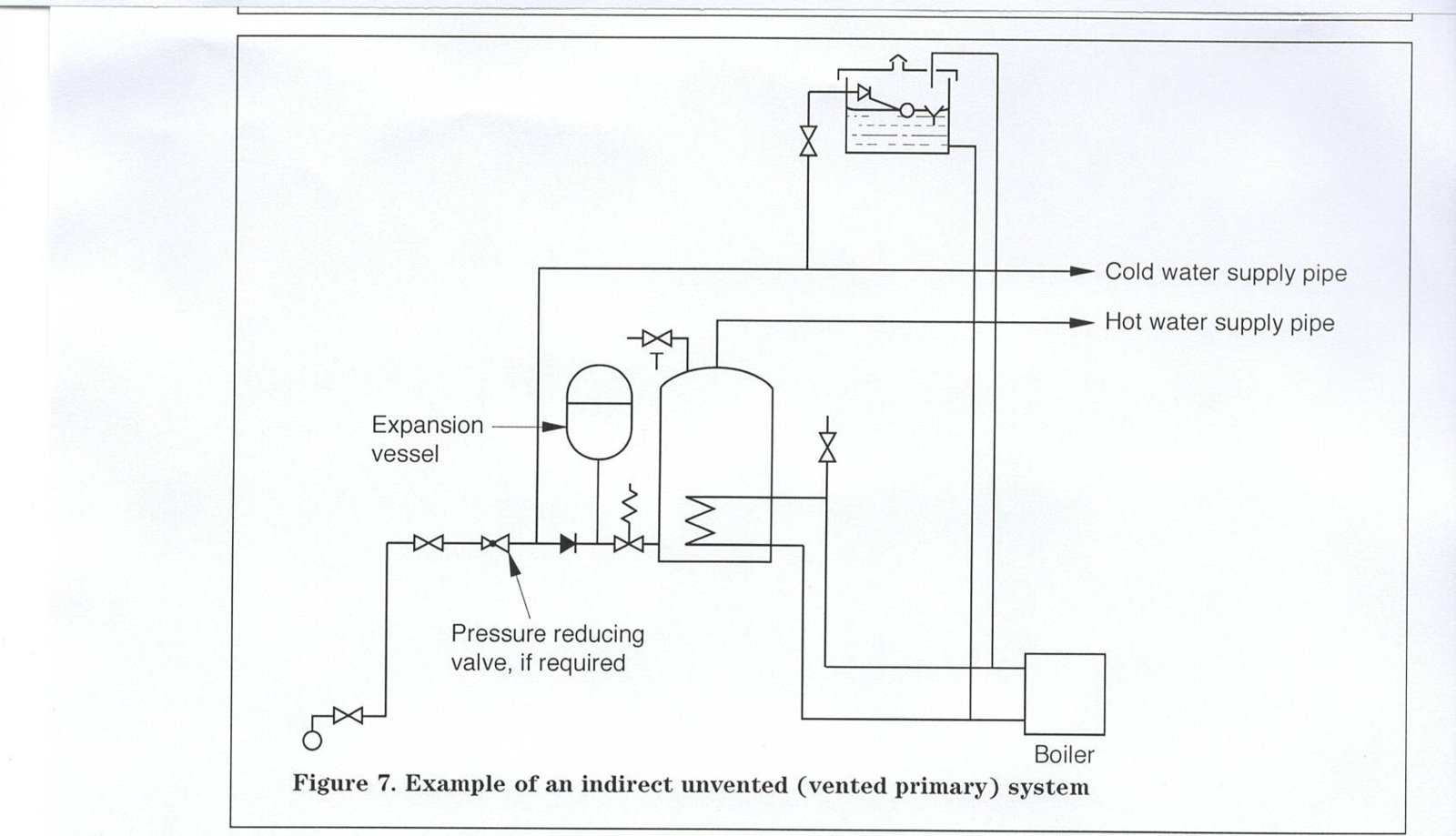

If you're undergoing a major refurbishment, is there any reason why an unvented cylinder would not fit the bill?
...a schematic something like in the attached diagram...
That's not going to work unfortunately. Well, it will supply hot water, but the loop does nothing; there is no means of keeping the loop hot. And the taps at the 'end' of the loop will wait even longer for hot water.
Thanks guys for all the replies. No, I can't think of a reason why an unvented cylinder would not fit the bill. It's just that I don't have any experience with these.
I like the look of the following diagram (from the Building Regs), which is sort of an intermediate system (unvented DHW and vented primary)
