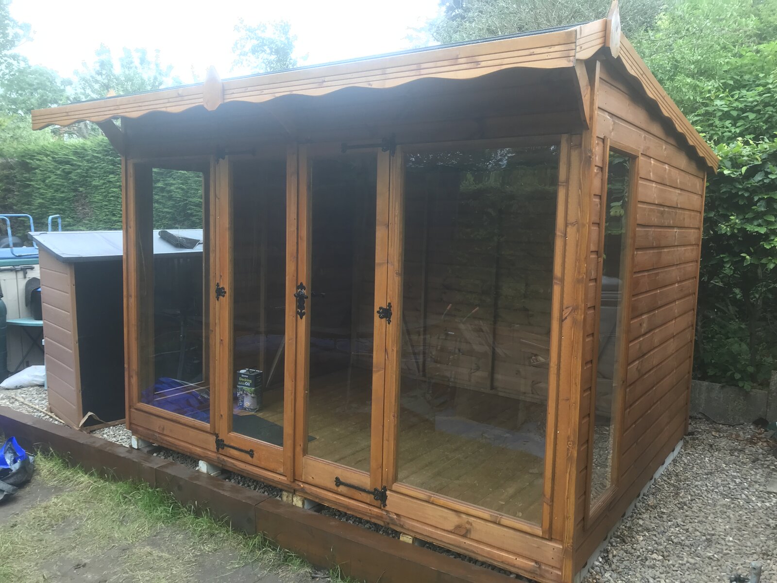

Hi all, I have lovey new garden shed/building (see photo)
I would like to add a secondary floor in before using it, just to give a really solid feel.
Am I better using OSB3 board or P5 tongue and groove chipboard?
or any other suggestions?
Instead of a secondary floor, (which will reduce head height), can you try putting extra joists supports underneath so the span is reduced?
It appears to be empty at the moment so it may be possible to either tilt it or jack it up and support on blocks to gain access to slide new supports in.
