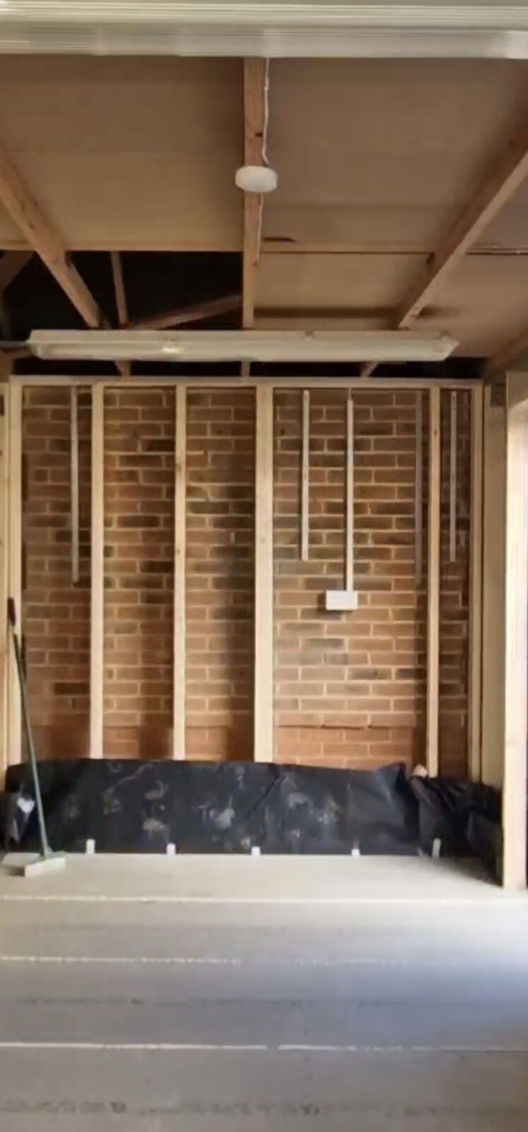

My main issue is that from what I can see, this particular stud wall's top plate doesn't seem to be secured to anything. I suspect it has been cut to size and forced into the gap. The bottom is of course secured to the ground but I'm worried about the pullup bar effectively pulling the top out. The other walls have the top/head frame secured to a beam.
The studs themselves aren't attached to the bricks either. It's a false wall with around a 5cm gap from the studs.

this is the wall in question. No obvious fixings for the top frame that I can see

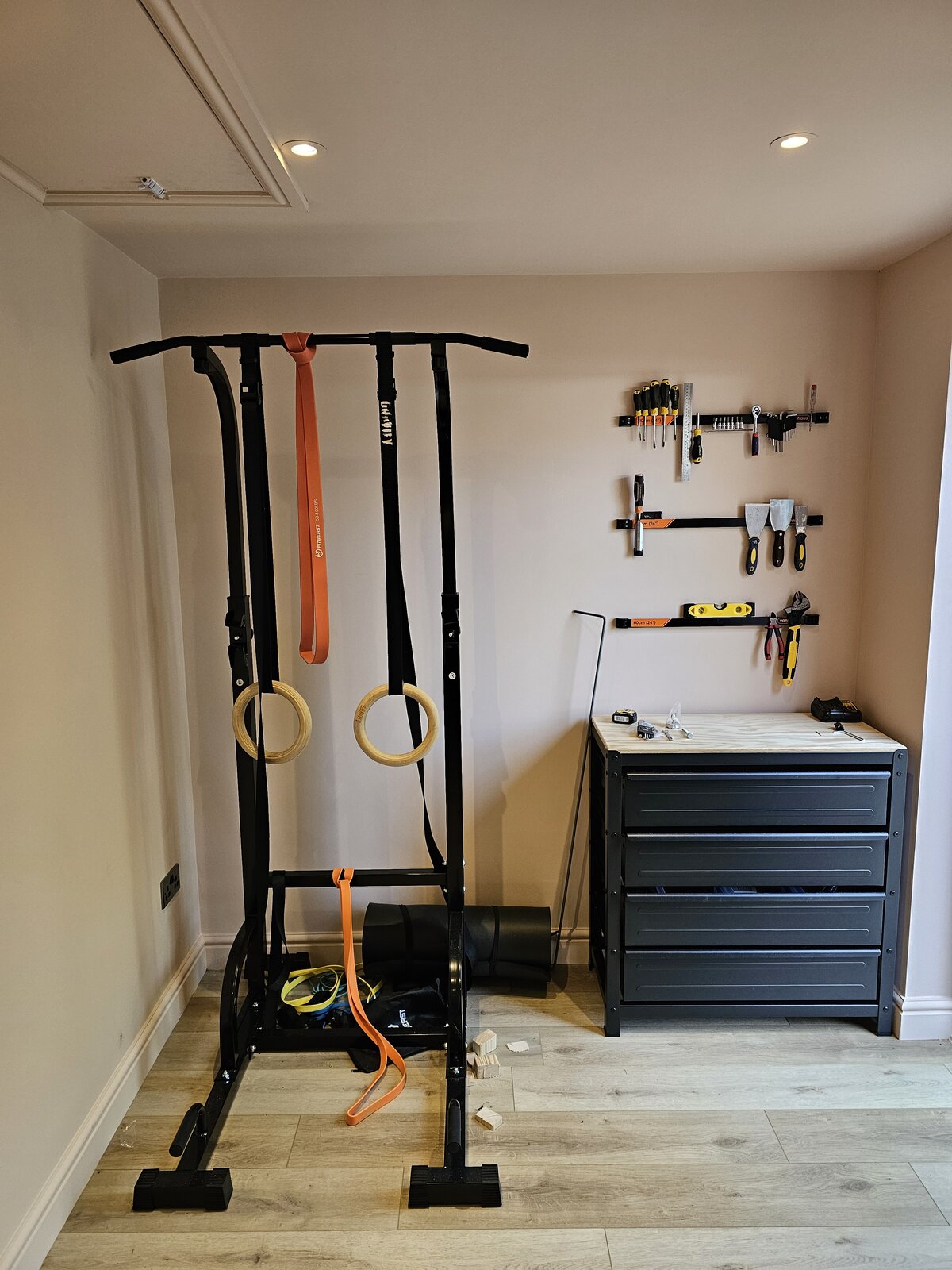

This is the finished wall (with crappy pullup station which I am keen on removing!)

Surely the top plate (the horizontal batten at the top) is fixed to the trusses above? Anyway you would be fixing through the studs into the brick. Is there a gap behind the studs and the brick do you know or are they hard up against the brick?
That was my thinking too but from what little I can see by crawling into the loft space there's nothing obvious attaching it to the trusses. I might well be wrong!
There is a small gap from the studs to the brick (about 5cm).
Do you suggest screwing through the studs into the brick? Will the 5cm gap affect the integrity of the screw?
Looks ideal , ply across the 3 studs, then heavy angle brackets from ply to the 2 trusses above.
