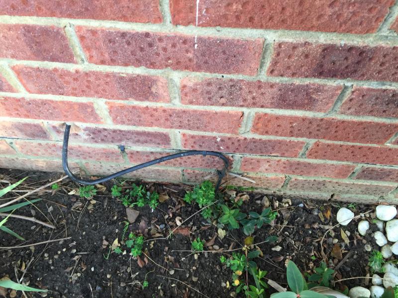

Good morning all,
I have a telephone line running into my house, which runs underground and then pops up and enters the house.
With the increase in home automation products I am much more reliant on my broadband connection. In particular, I am considering purchasing a number of cameras (dropcams) so I can keep an eye on the house when I am away.
Any ideas on how I can secure this wire to prevent it from being cut?
Thanks, Nick

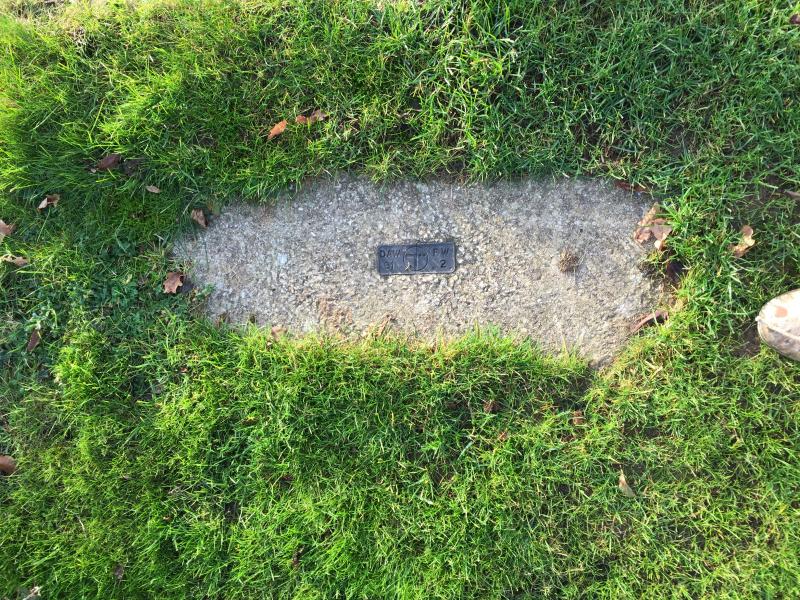

Thanks for the replies - some good ideas here.
Could a potential burglar still get to my telephone line through here?
Is there anything I can do to protect this as well?

Conceal the actual cable and install a dummy one. Connect a looped pair in the dummy to your burglar alarm as a zone. If a burglar cuts the dummy cable then the alarm will sound.
As to the inspection chamber, yes your line could be cut there.
If you are that concerned then use a monitoring service that will detect that the phone line has been cut and then take appropriate actions.
None of this will protect your property from the smash, grab and run burglars. For that you would be better to spend money on physical protection such as secure locks on doors and windows.
steel capping will protect the cable to your house.
as for the inspection cover, leave it alone, it belongs to Bt, has other lines going through it (not just yours) and these things need a gas test before opening and while working on it.
never heard of a burglar cutting the line from the inspection cover (hard to identify which is yours, and if u cut all of them you'll knock others off and attract attention in the street)
........ or DualCom ......... still got signalling if line cut
