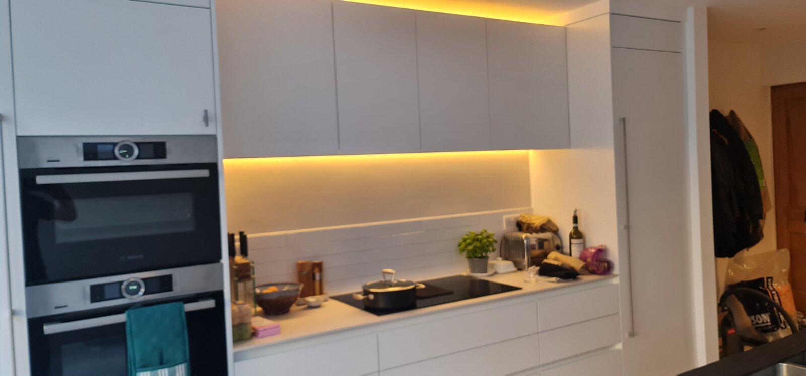

I've almost finished fitting my kitchen and I plan to fix an MFC board to the bottom of a 2.1 metre run of wall units to make it look nice and neat (and also to accommodate an LED light strip which I will recess into the MFC).
Ideally I want to have no visible fixings on the MFC board and preferably none inside the wall cabinets. I'm wondering what is the best way to achieve this? I'm using 8mm MFC so that it's not super heavy.

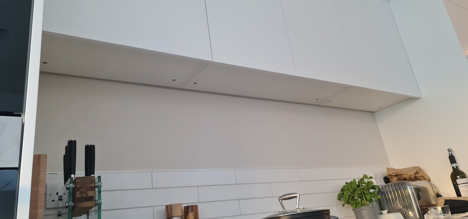

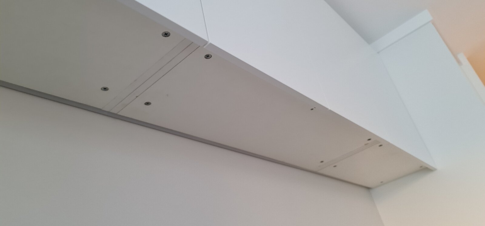

Thanks for the suggestion. I've not used Mitre Adhesive before but I don't think that would be the right approach because the board that needs fixing is quite large (2.1 metres by 28cm) and the bottom surface of the cabinets is not 100% flat/smooth due to the construction of the cabinets (see photos). Although the MFC is only 8mm it still has a certain amount of weight to it, and as it's above a hob it obviously needs to be very well secured.
silicone or grip fill would do, or CT1
but TBH ordinary silicone is fine and cheaper
a bead all the way around the perimeter then a load of zig zags going in between
you could cut some offcuts of sheet material just a bit small than the gap between the wall unit and your worktop, then wedge in place until set
BTW you might need to pack between top of wall unit and ceiling temporarily in case you force the wall units up and off their hanging brackets
