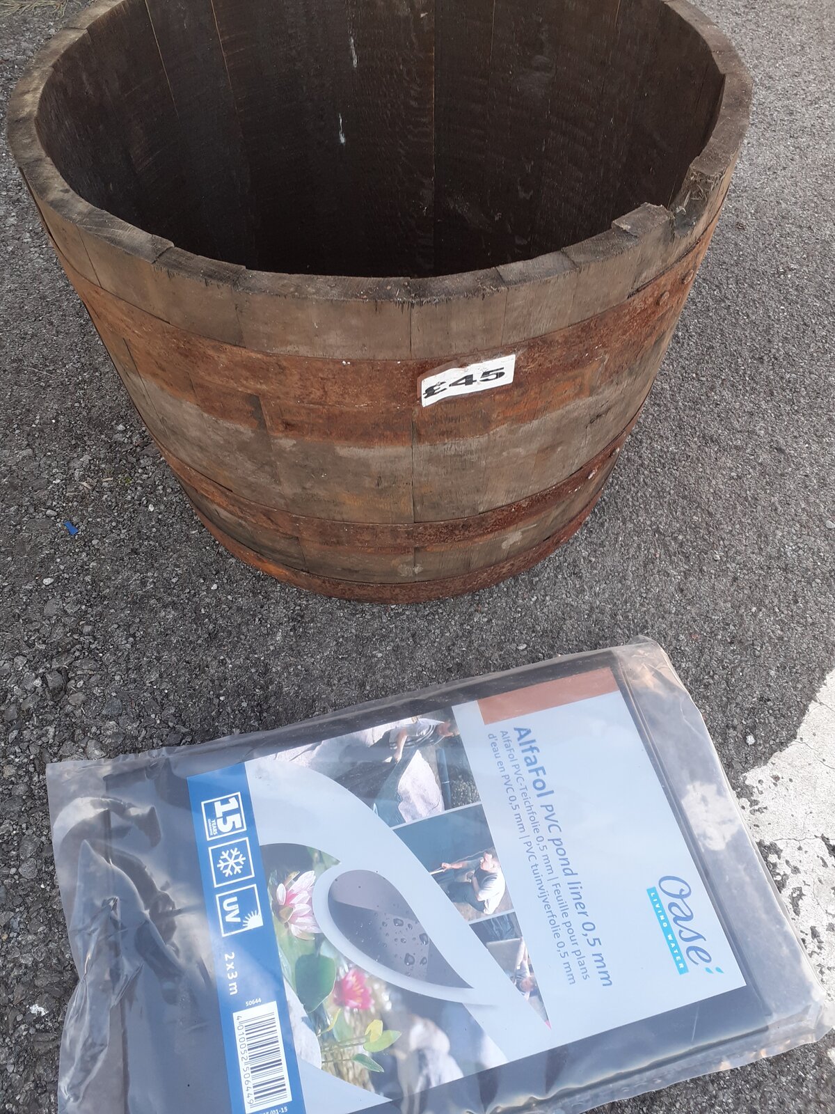

Gonna put a pond liner in this barrel before filling it . It will wrap over the top edge.. How do I secure it? Is it possible to wrap some wood around the outside edge to hold the liner in place?

Could always try builders band, spray painted black and fixed with black, round head screws. Alternative, 1mm aluminium strip bent round first, then drilled and countersunk and screwed on with CSK head screws. You'll still need the gaffer tape, though...

Why not trim so level with the top and use a staple gun to fix on the inside. Might look neater.
I assume once it is filled, the water will hold the rest in place. Maybe fill it first, push down flat with a broom handle of something, then tip a bit out before stapling.
Maybe some adhesive all around the top 3-4 inches too.
£45 :eek:, glad to finally find something that is cheaper in the Highlands than down south!
Not sure about a pond liner in a container designed to hold liquid :censored:
its a oak whisky barrel in my opinion cut in half so fill it with water until it leaks no more ??
at that point fill with i assume earth and plant
iff it dries out it may come loose so do not line with plastic in my opinion and without plastic expect perhaps 5-7 years off use but just a guess

If I dont line it , then fill with pond water, will it contaminate the tadpoles, fish etc?
you can try it for a week and line iff necessary
remember port brandy whisky are stored in unlined barrels for years
Tadpoles will need somewhere to crawl out as they start to change into little frogs, a steep sided container such as you have would not be suitable.
Yes, well, if that's a wet barrel which was used for storing alcohol it might poison the fish/tadpoles, but at least they might die happy...
No, with this idea you're just going to kill off a generation of frogs in your area. Stagnant water goes green and stale with little oxygen, it'll also evaporate quite quickly as it warms up as such a small body of water. When you top up with tap water, you're also topping up with fluoride.

Ok I'll line in. Dont want to contaminate anything. Regarding the tadpoles, as soon as they become froggish I'll take them back to their pond and leave the minnows in there. Put a plant next to it in case they wanna jump out.
Will be pond water
