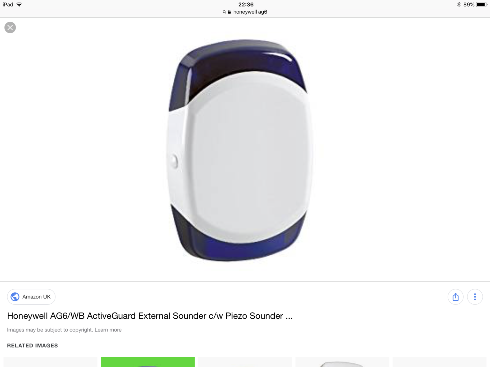

04FAD094-2DCF-4335-B7A7-C8A7D2CCCACB.png Is it this bellbox
Problems with that bell box ,pcb Cooper track breaks down causing problems with bell box.Tamper faults and chirping common.
Well if it’s got a 800l then is probably over 10 years old , it will cost around £10 to replace the internal battery ( assuming it is replaceable... £25 will probably get you a new bell box, £35 for a backlit one
