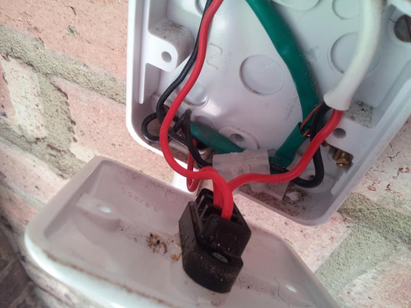

We've just moved to a new house and it has two PIR lights, one for the back which goes into the garage via a normal plug and one at the front which has the wire coming from a light switch for the light in the garage.
The front light doesn't work so is being replaced.
Question is, will the new security light only work when the light switch in the garage is switched on or would it be wired to work like normal and operate when set off at night? Haven't had the chance to test so wouldn't have a clue.
If not, how would I wire it to make sure the light is always operational?
Thanks :)
The normal procedure would be not have a functional switch, that when left in the closed/on position allows the security light to operate as set for dusk till dawn and energised the desired time. Most offer an override facility that will allow you to turn the light on outside those settings and also when the switch is open/off this will then de-energise the light and remove the dusk till dawn and tmed settings.

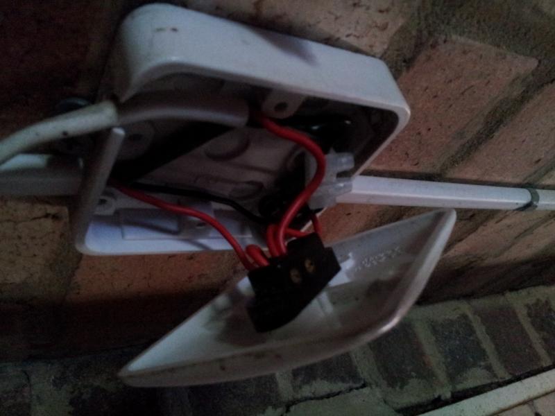

Worked great when the new light was wired to the existing wiring. So I have a switch that takes a wire from the lighting circuit, goes to the switch and then powers the on/off tube in the garage and has a permanent live for the security light.
Now I would like to replace the switch, any ideas what the light switch in the pic is called? I got a metal 1 gang, 2 way, 10 amp from Wickes but it has a live 1, live 2 and a common, it doesn't look the same as the back of the switch in the pic?
It is as you have said, a one-gang, two-way switch.
How are the terminals of the present switch marked?
C, L1, L2 =
L, L1, L2 =
L1, L2, L3
It seems I have the 2 lives from the house and the security going into the common (middle terminal) and the live for the interior light going into the top terminal on its own, doesn't seem marked.
The new socket has a common terminal so I'm guessing i'll put two lives in there and then a L1 and L2 for the switch so i'll pop the live for the interior garage light in L1?
