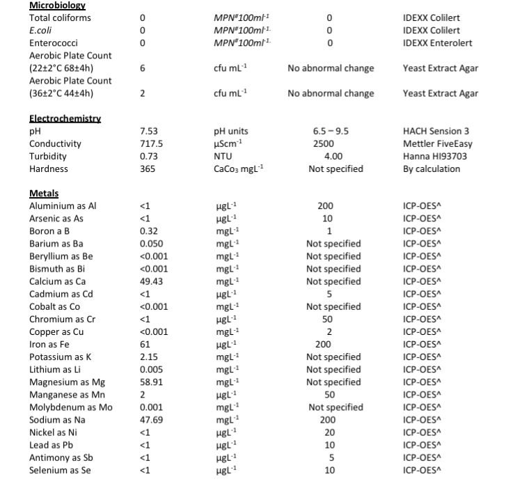

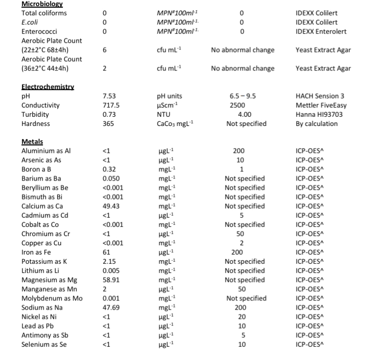

Do you know the mineral content of the water?

Not sure on mineral content, I’ll see if I can dig out our water report when I’m home later.

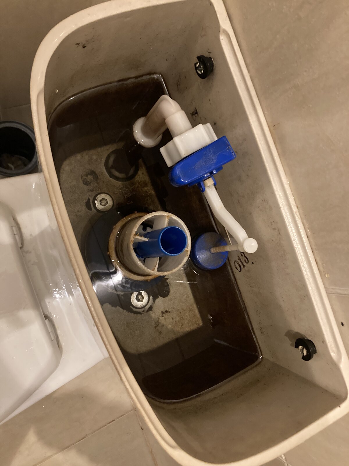

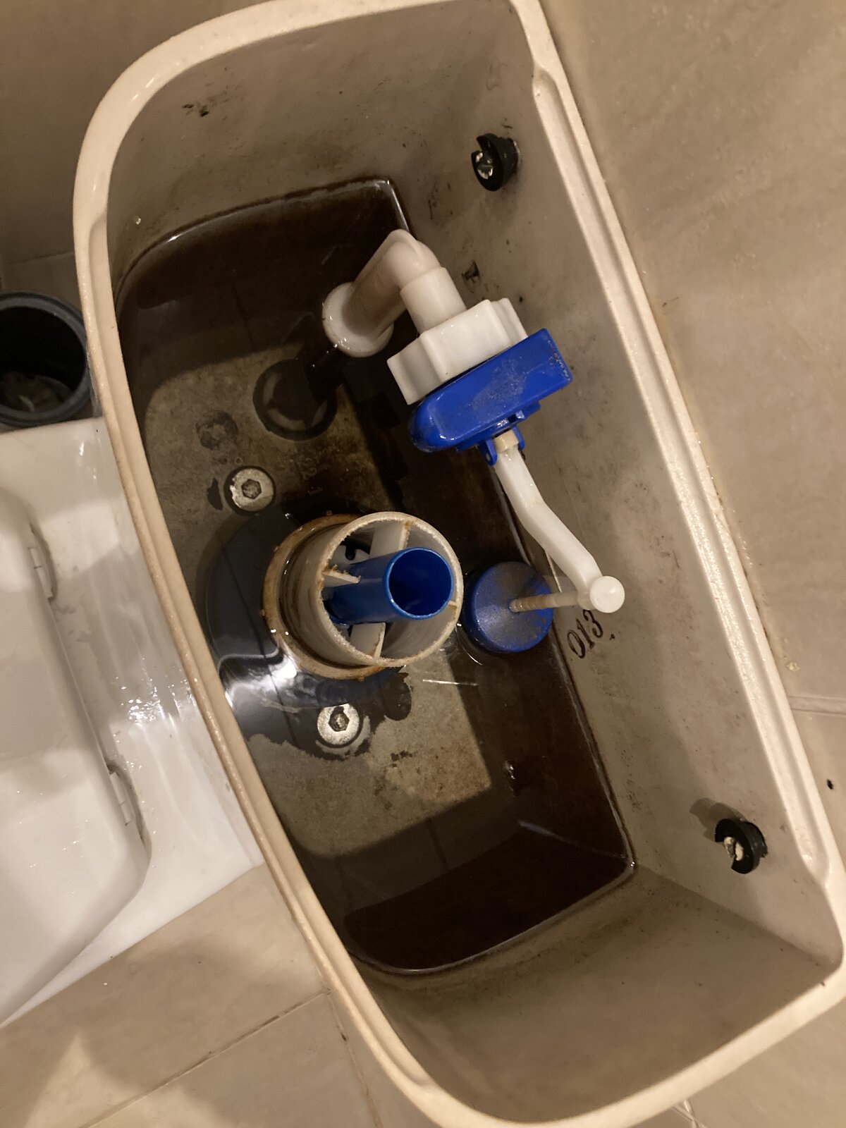

Fitting a water softener causes existing scale to flake off. Can you take a pic inside your WC cistern and your cold water tank? You may find the walls and floats getting cleaner and fragments lying on the bottom. Keep the pics so you can compare them in a few months time. It will eventually dissolve and wash away.
If you unscrew the nozzles from your bath tap you may find the same. The hot tap may be worst.
Have attached a screenshot of the report, checked the cistern, looked like loads of sediment in the bottom but seems to just be the colour of it (doesn’t move when scraping against it).
It sounds like what from you’ve said that it could just be a case of waiting for it to all clear up now we have the water softener running?

Cistern looks pretty clean as far as I can see. No flakes of scale on the bottom.
