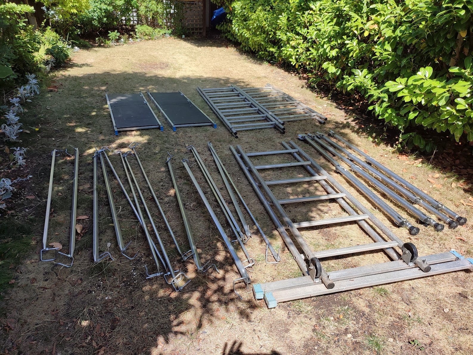

Some years ago I bought an access tower similar to the one you mention, which claimed an upper platform height of up to 4.8 metres - allowing working up to whatever you could reach when standing on that; say 6 or even 7 metres. Certainly enough in theory to allow work up to the roofline of my ordinary three-floor house. See pic. From memory cost about £600. It has four adjustable stabilisers. Even so, I have hardly used it. I just found it too scary to work off, even at half-height and with stabilisers fully and firmly in place. It's perfectly strong but it wobbles, like some of my body parts. Now older, fatter and even more scared of heights, I find it even scarier - though I'm OK with proper scaffold. I have considered and may try drilling the house walls for some beefy eye hooks and lashing the tower to those, but not tried yet. Obviously your call but you could try a rental first?

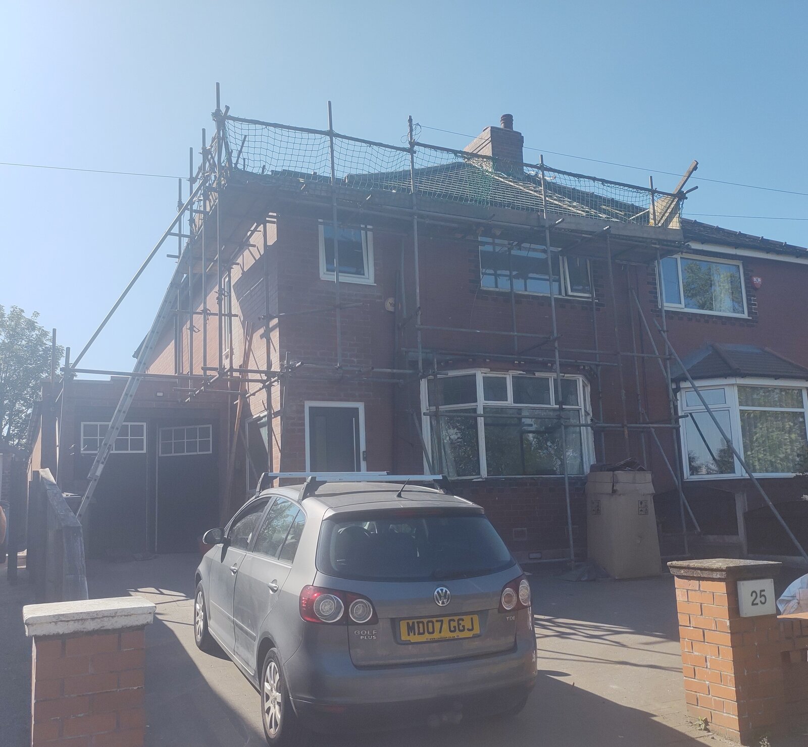

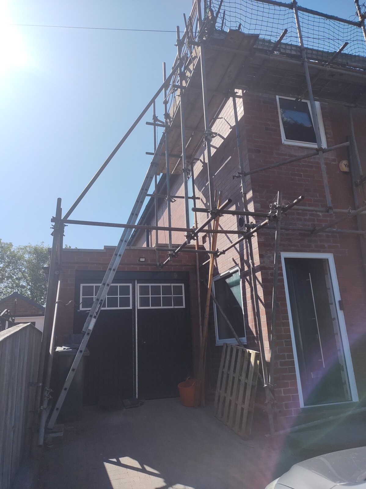

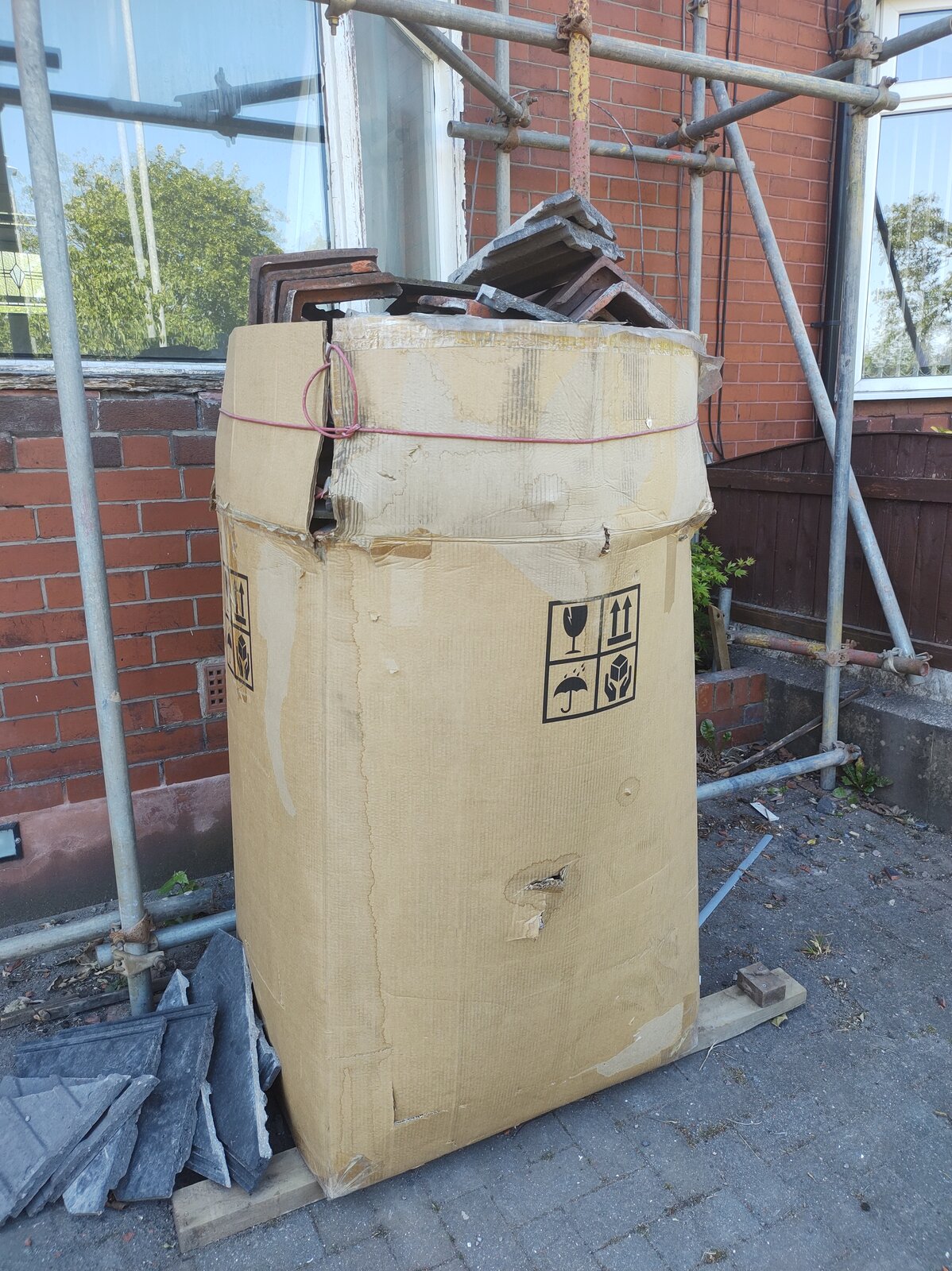

I have one of those steel ones, strictly for first floor access only in my case. Fortunately I own my own set of scaffolding, currently in use for building an extension and replacing my roof. Unfortunately I don't own the knowledge of a professional scaffolder so it's a bit makeshift and slightly wobbly! But it's just for my use and I'm aware of its foibles. Living on a main road I do get plenty of feedback from passing scaffolders vans - usually along the the lines of "what the **** is that?", or "who the **** put that up?"
The left hand side is more wobbly, but it's a complicated arrangement that still allows me to get my caravan into the garage:
And for anyone wondering, yes you can fit the entire front face of a typical semi detached house roof into a large cardboard box!
