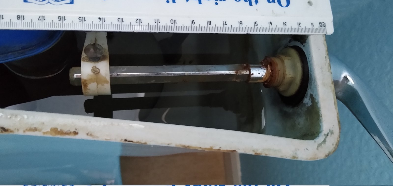

I have an Armitage Shanks toilet that must have been installed in the 1970's.
The flushing handle/bearing has worn but I've "fixed" it with some plastic strip and it seems to work ok for now.
I'd like to replace the handle assembly but I'm having difficulty finding one that would definately do the job.
Requirements are:
Square bar needs to extend 15.5 cm from outside edge of cistern
Cistern side thickness 1.0 - 1.2 cm
2.14 cm cistern hole diameter (on the side)
1.878 cm across existing thread of bearing (3/4 in?)
(Existing square bar 0.96 cm (3/8 in?) across)
Suggestions anyone?

or front mounted :unsure: Lots of variations in the 70's. ( including colours of ceramics )
Yes, the lever is on the side (as mentioned by hole diameter).
A picture, hope it helps.
(also hope I've done it right - not that used to foruming!)
