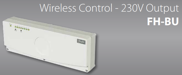

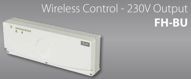

Is this your wiring centre (but branded as Myson)? I can't tell you the answer, but thought it might help to work out what you have.
Maybe Danfoss are shut for the festive season?
Many thanks for input. For sure Danfoss will be closed for Xmas but they acknowledged the enquiry on the 5th of December and I'm afraid I need to keep progressing this even when they don't answer. Your picture is accurate and is the unit the Myson appear to have badge engineered for resale. We bought the last 3 thermostats available in 2017 for myself and 2 neighbours and am now seeking alternatives with failing existing units.
The existing wireless thermostats are identified by the receiver in the FH-BU unit i.e, only the thermostat is needed, as the receiver is integral to the FH-BU
