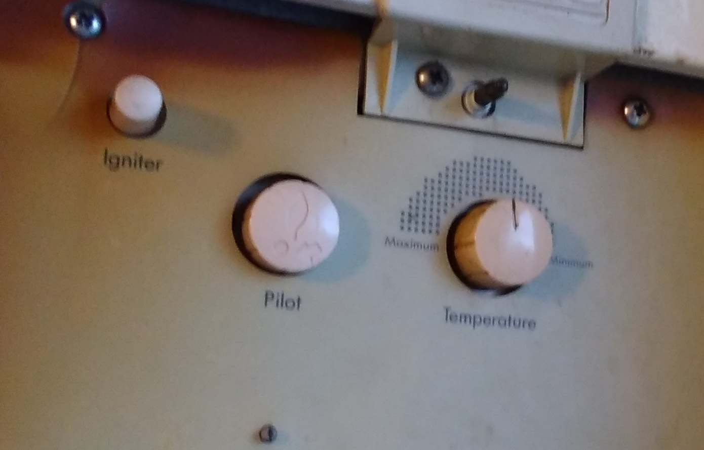

I'm looking for a home automation solution to rotate a knob through 180°.
It's a plastic knob of 25mm diameter.
Rotation speed is not an issue. It can take minutes to do the 180°.
Resolution is also not an issue. If I can only stop it every 30 degrees or so, so six or seven positions overall, that's fine.
I've been looking at reversible DC motors that have a built-in gearbox.
I would drive this from an Amazon Echo controlling a Sonoff RF Bridge sending signals to a a 433mhz controlled relay board, in order to turn the motor in either direction.
I would only have the crude timing resolution of 5 seconds offered by Alexa routines. For example, if a full rotation takes 1 minute, 5 seconds would approximate to 30 degrees.
I realise that this would almost certainly result in drift (because the 5 seconds you get from Alexa is only very rough), so I would need limit switches, and a routine to drive it to one end or the other, to reset its position occasionally.
Firstly, is there a better or easier way of doing this please?
And secondly, how do I transfer the rotary drive from my controlling device, which would have to be mounted about 500 mm away in the vertical plane? I imagine some sort of pully or sprocket wheel, clamped on, or around, the existing knob.
It's the temperature control in the attached photo.

I would use an elastic band to drive the knob or a wheel using some other friction drive so it can slip at end of travel. However the main question has to be why?

@winelight, in your picture the top of the panel appears to have brown staining on - is this correct?
If so then I think you need your boiler looking at by an RGI soonest.
As for the variable temperature control, yes using a stepper motor fed from a driver board and an arduino/pi is a project but I'm not entirely sure that your allowed to do that to a gas appliance - perhaps an RGI can chip in on this?
What make/model boiler is it? you may be able to get an electronic temperature control to fit it.

Well first off it's an antique boiler, hence the discolouration, and it is stripped down / tested / measured / checked / parts replaced as necessary by an expert in this model every year, but it's a Servowarm and hence there are no other controls at all, no room thermostat, no TRVs, and so adjusting this 2-3 times a day is what that you need to do to get reasonably constant temperatures in the house.
Sure it could be a microcontroller project but really I want to find a way to avoid that.
A rubber band drive sounds reasonable as the least intrusive technique, because I really don't want to touch the boiler itself, even if it would be legal for me to do so.

An interesting project. I am also confused as to why, but that's not my concern. There are many proprietary products that will combine to give you adequate room and hot water temperature control with the Servowarm (Glowworm?) boiler that you have...but that's not what you asked.
I would suggest you gen-up on the Arduino, then buy an Arduino Uno or Nano, plus a stepper motor and drive to suit (there is also a variant called We-Mo that has wireless comms built-in). The torque will be just enough to turn your control knob via the elastic band, thus avoiding any intrusion into the boiler.
There is plenty of wireless and stepper motor software available on the www.arduino.cc website.
From that position I assume you will want to drive your boiler temperature automatically in response to room or hot water temperature, and for this you will have to measure those variables.
All straightforward and fairly easy to do....but again, why go to all that trouble to make an old boiler do what a modern one does for itself (see OpenTherm), unless it's just an avenue to improve/develop your coding skills.

Firstly it's not my boiler nor house so that's why I'm looking for a solution that I can simply affix to the existing knob and remove if necessary.
The boiler is a Servowarm Elite 50 and there's manuals and diagrams available on the web for anyone interested.
I don't have the time, space or inclination to buy a PC, install and maintain an Atmel development environment, and then embark on a development project, which is why I'm seeking a solution using out-of-the-box off-the-shelf components, as far as possible.
As to why, although there is no room thermostat, it is possible to maintain a reasonably constant temperature in the house by adjusting this control a few times during the day, typically when I'm out of the house or busy doing something else, or even if I am available, on those rare occasions, I forget anyway.

Out of the box temperature control of the room could be achievable using the programmable TRVs suggested by ericmark. I can't help you with an out-of-the-box elastic band driver.
I would look into acquiring a knob that mounts on the same shaft as the existing one, then affixing something to that in order to avoid damaging the one that's there now [simply put the original one back when you're done].
You could translate this motion 500mm vertically with something as simple as Lego chain drive and a couple of sprockets. If "500mm away" is on the sheet metal front of the boiler then whatever is at the other end driving this could be held on with strong magnets.
