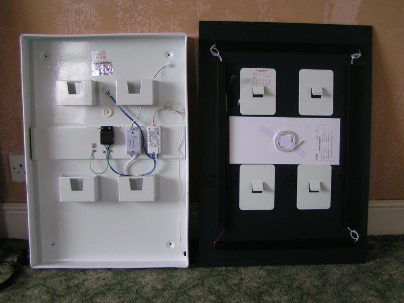

I bought a fancy bathroom mirror with led lights and a demister pad. When I got it I found the wiring inside wasn't complete, the led's have quick connect plugs but the demister pad wiring is rolled up and taped to the back of the pad.
Apparently I'm expected to do this myself, or get the qualified electrician who has to connect it to the mains to also complete the internal wiring!
I don't think electrical items come from manufacturers incomplete but seller on ebay insists the item is not unfinished and they are all sent out like this.
Any thoughts as there is no instructions to do so, only ones saying how to connect supply from mains which is obvious a purchaser would need to do.

Whilst I'm happy to just connect the pad myself, there are no instructions to say where the coiled wire goes, I 'think' I can work it out but if I get it wrong and the item goes 'pop' can I return it as faulty?

Photo of the mirror unit and rear of the glass.
Moulded plug to connect led's top right of back box and top left on glass.
A 'spare' choc block presumably is the connection point for the demist pad.

I'm sure the choc block is where it's got to go, it goes to the switched output of the IR switch, 2 wires go also from here to the led driver.
