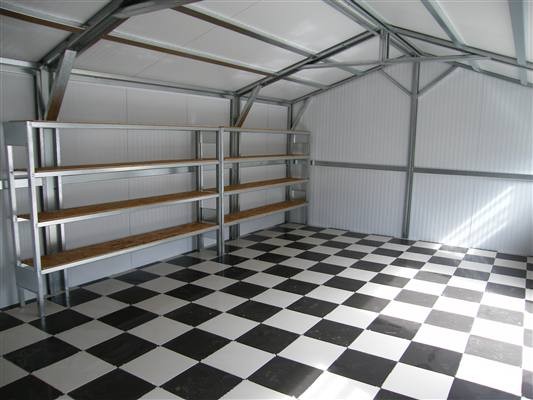

My other option is TRISOMET panel system. I've emailed my local council yesterday regarding them,but don't have any info yet either they happy for me to build it.
